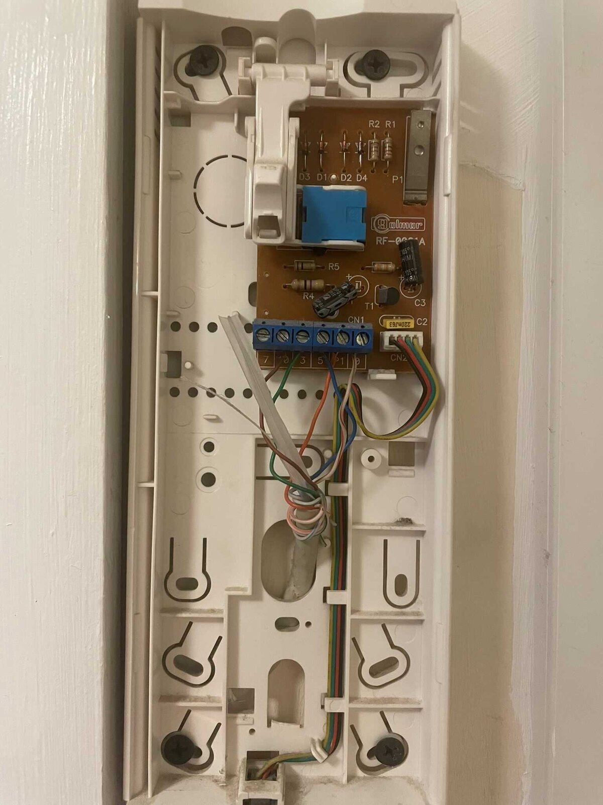

Hi,
Was wondering if someone could help- the phone wont ring. When I pick up the phone I can hear people outside just no ring.
Attached photo of the wireing.
Is this a new or a replacement handset ? Has it ever worked ? What does the external unit look like ?
at the moment it’s wired for electronic call at terminal 0 ( brown wire ) if it’s a replacement handset for an older system it may not support this and may need the brown wire putting in terminal 7 ( AC call )

However I know that some of these units can be used in either dc or ac mode and also incorporated into the internal phone system, so not knowing this device I left it to others.
