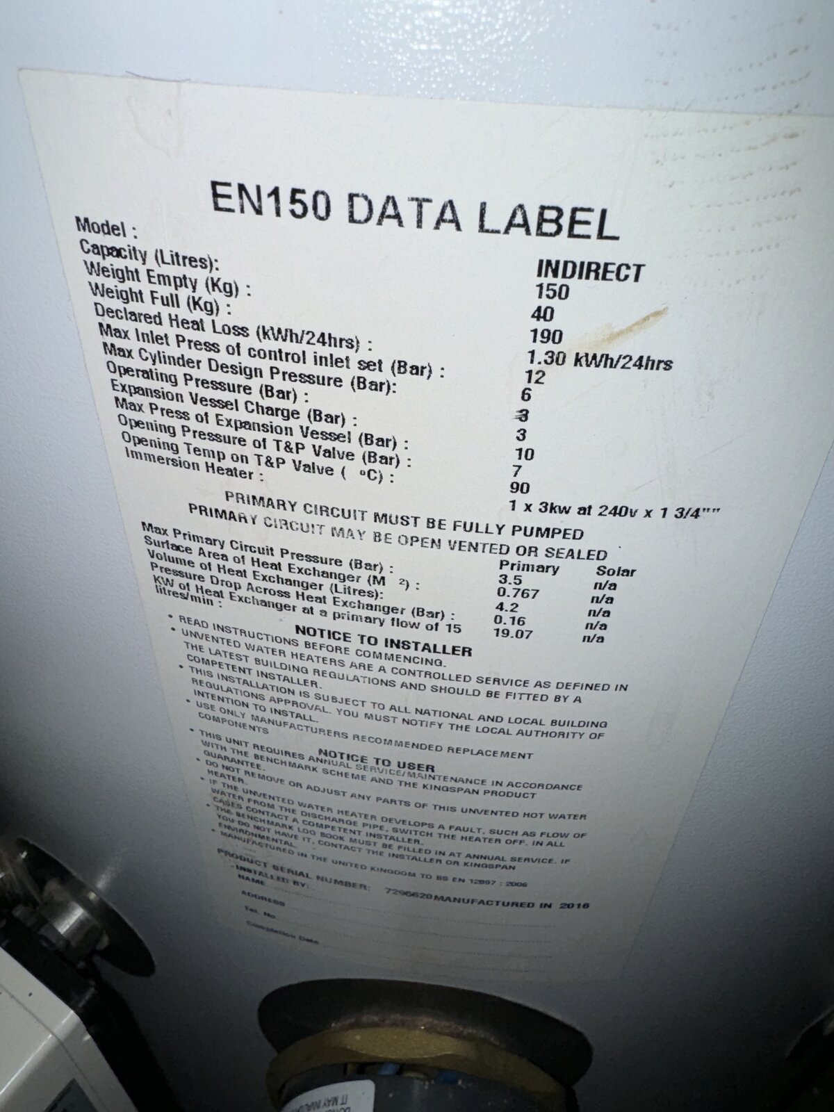

I have (I think) a Kingspan one. Seems okay, keeps the water hot for quite some time. I think I paid around the £600 mark for it about 5 years ago. Has an external expansion cylinder.
Here's the bumf on the side of it.
