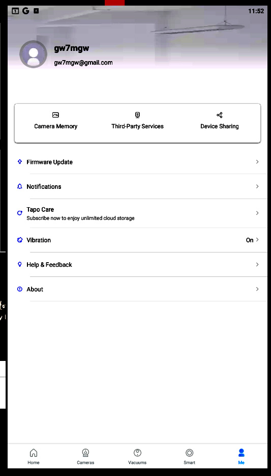

It is of course panic, and she never thought of ringing me with her mobile. I hear her talking/shouting at the Nest Mini's so often, never realised she was talking to me, the previous light switches were Energenie and we had remote controls Remote control.jpgwhich don't use wifi or hub or router, they work direct with switch, however of five switches only two still working, so moved to LP-Link (Tapo) as said the button 1689159649656.png is magnetic so can also be mounted nearly anywhere, and was on the steel bed frame to start with, but I had linked to google home which I thought was good enough, she could either use the app with phone or voice commands, but google home also had a hissy fit, and would not work.
In the end found out how to let wife work the switch direct from phone Me-1.jpg it took some finding how, as when I googled tapo I in fact got tado so was reading wrong instructions. I just had not noticed d instead of p in the results.
