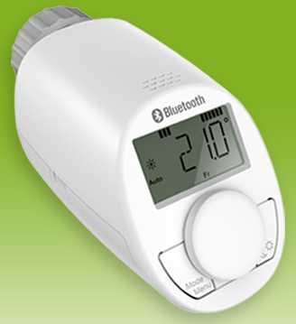

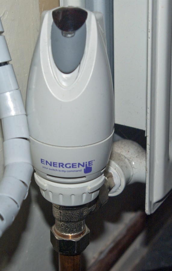

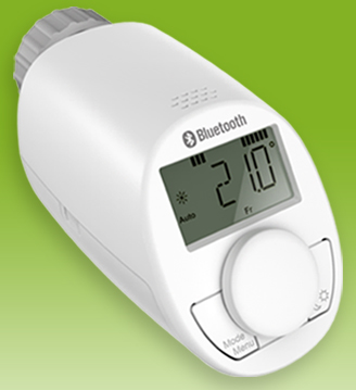

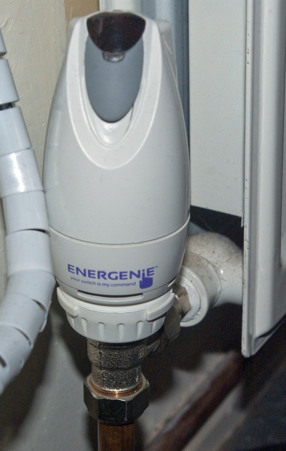

Not sure what you mean by "Smart" TRV heads? I have these 61dmtMm13BL.jpg IMGP8035.jpg fitted, 5 eQ-3 and 4 Energenie. But these are not as "Smart" as Drayton Wiser which uses algorithms to heat fast without any hysteresis.
I can control heating, what I can't control is cooling. To stop any over shoot the heating temperature increases 0.5°C every two hours during the day, then drops back down over night, I don't like it warm when in bed.
