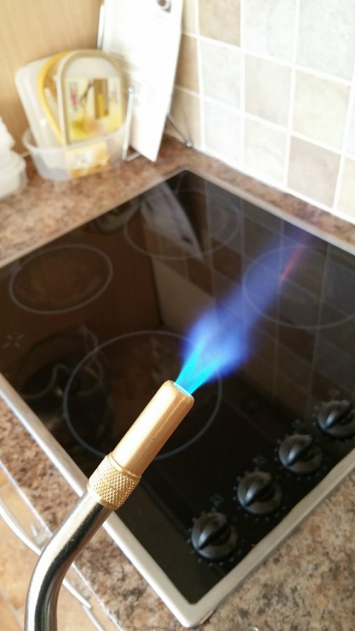

Purchased this last week for £30 on ebay to do some pipework using pre-soldered fittings without any issues at all. Not having had experience of brazing I looked at Youtube videos before using and all the torches had a really well defined central cone of flame. Using this torch not so, pls see attached photo.
So for future reference which part of the flame should I be applying to the fitting to get the best result. I went for the middle half way down the flame and applied for about 12 seconds roughly until I could just about see the silver emerge.
I've used it over the space of a few days and done about 15 joints and noticed it now takes a couple of goes of the piezo before it actually lights from cold, it also leaves a smell of gas after using. Is this normal?

1. If you turn the flame down (knurled brass screw on back of head) the cone should be better defined.
2. The hottest part of the fame is the blue cone. That's what you apply.
3. Move the flame around the fitting and pipe to get the heat applied as evenly as possible.
4. If its taking longer to light, the inside of the nozzle may need cleaning.
5. It shouldn't leave a smell of gas. If the smell is there with the torch connected to the cylinder, again it may just need cleaning. If the smell is there after you remove the cylinder, its the cylinder seal. They are usually poor. I always leave mine connected to avoid the smell and an accumulation of gas in the tool case, but I take the risk it drops and the neck breaks.
That's a swirl/turbine nozzle on that, not a standard nozzle so you won't get a cone as such. Top of the bright blue section is the hottest but with that then middle of the flame will be fine. Just don't have it blasting away, flame shouldn't be too 'loud'
Flame looks ok to me I had a torch with a worse flame than that for years and it worked ok for me and I never had any problems.Bob
This. I have the same torch.
If you look down the nozzle you'll see metal deflectors. The idea is that it makes the flame 'wrap' around the target area.
