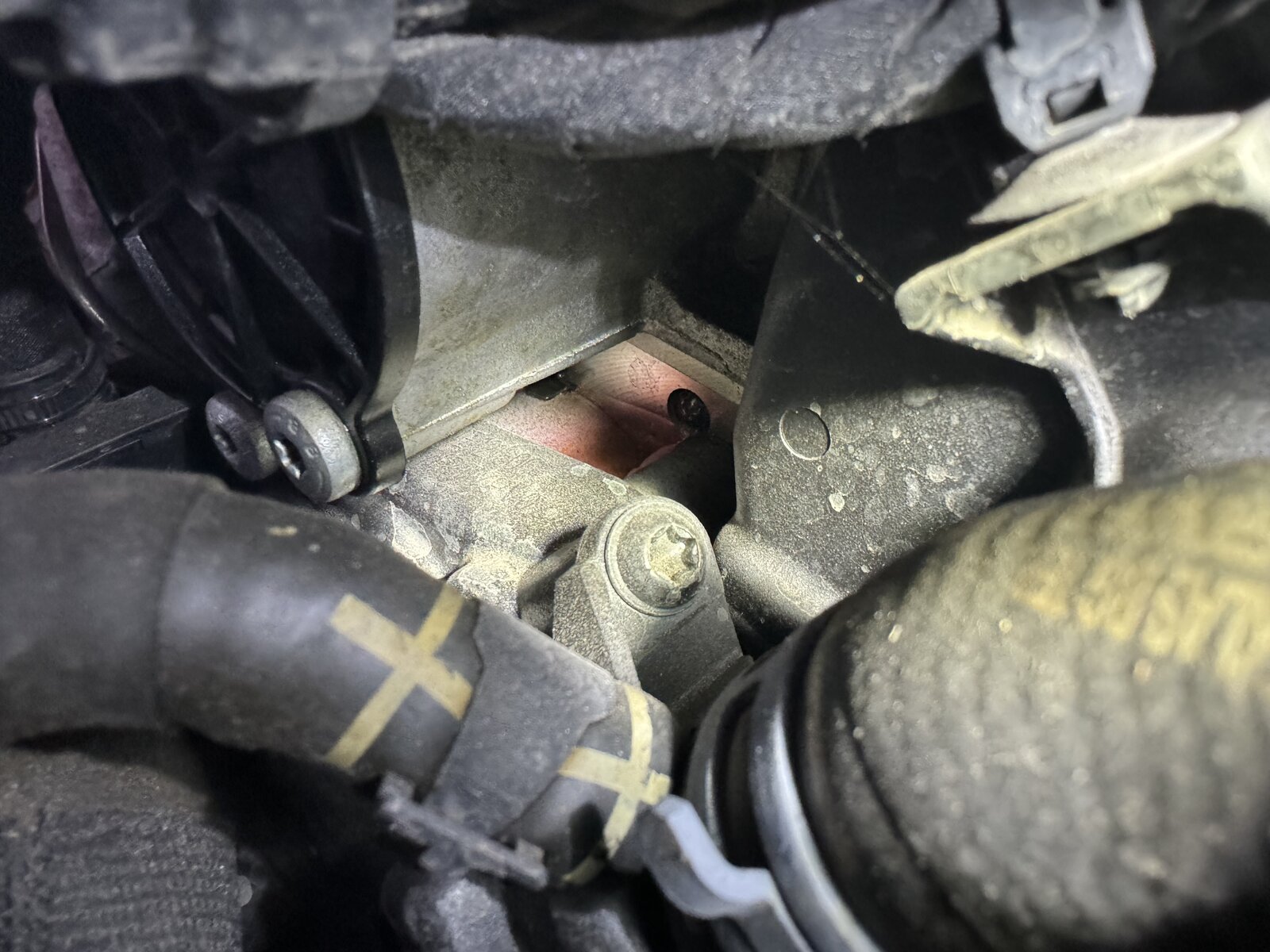

Mrs Mottie had to turn back on her trip to work this morning as she got a warning light/buzzer that the coolant was low. She's left it with me and taken the Golf. There was some coolant on the under tray and I noticed some water pooling around the water pump area. It’s done just under 60k so I’m going to replace the pump and belt anyway but I'm wondering if it’s common that the plastic pump/thermostat housing gives any problem on these engines - I know it used to be common on a lot of Ford plastic thermostat housings for example. There’s a vast difference in the price of a pump and the price of a pump with the housing (or 'coolant regulator' as they call it!) - roughly £80 v £270. Has anybody experienced or heard of problems with the housing on these engines? 2017 1.4 TFSI.

I've had the plastic impeller come off on these but the only leaks I've seen come from the pump gland.
A new pump may have the quick warm up system - whereby the impeller is shrouded until the car warms a little and then the shroud retracts courtesy of another pump within the pump - if you get my drift......quite a performance!
Hell of a price difference too, but I tend to use the original temperature sensor which is extra.
I'm only commenting on the diesel here......the thermostat housing may well be different.
Good luck with it - it looks like the job has decided to come your way early!

Ordered an OE pump, complete with housing and a pump belt from Audi. Probably 30-40 quid more expensive than makes that I've never heard of. Just over £200 for the lot so a no brainer really. Picking it up tomorrow.
