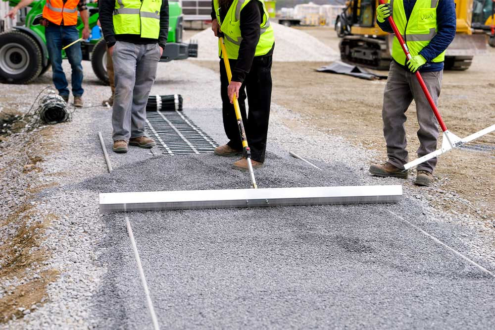

I'm digging over and re-seeding my lawn from scratch as it was in really poor condition (weeds, bumps, dips, waterlogging)
The existing lawn has a gentle slope up towards the back of the garden which I'm intending to keep as the fences have the same slope, and to level the lawn would raise the level nearest the house too much.
Is there a known way to ensure an even gradient from the front to back of the lawn, other than just raking it until it looks right by eye? E.g. 2% all the way front to back rather than 1% in the front half and 5% in the back half.
All I know is the starting height nearest the house and the length of the lawn - the ending height at the back of the garden isn't known because the existing lawn isn't evenly graded.
One option I could think of is to make a jig out of some 2x2 similar to a screed bar like this, and push / pull it horizontally which should knock down any high spots / highlight any low spots

this is the best time of year to do it. a lot less wild weed seeds sitting in the soil will germinate compared to the spring.
as for levelling it - I would just do it by eye. Have a long straight plank and just keep lying it on your raked soil and that should show up any obvious hollows.
