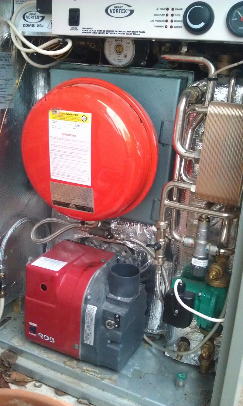

The boiler is heating the hot water and central heating fine but there is a problem with the pump over run. It seems to run for a totally random amount of time from about 10 minutes to overnight.
I think that the overrun on this boiler is controlled by an electrical timer than a thermostat, is this correct?
Is this a simple fix?

By motorised valve, I assume you mean one of these:

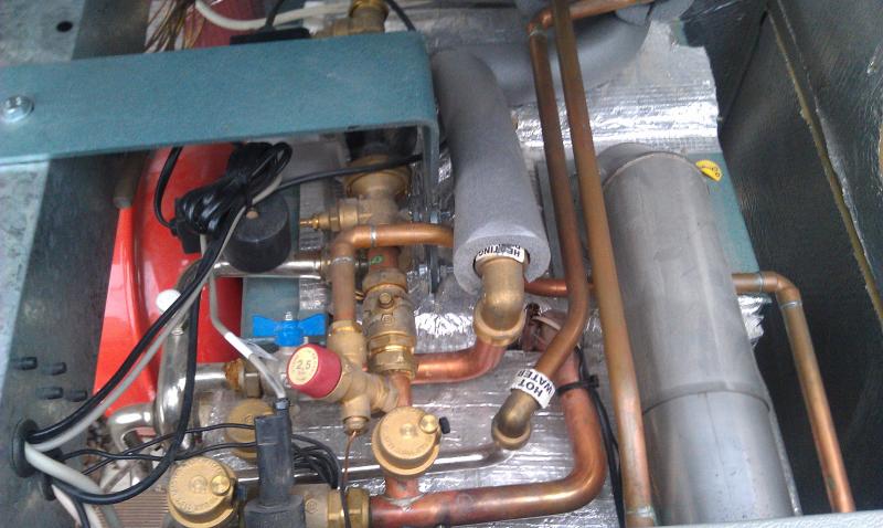

If so, I don't seem to have one. Pictures of my boiler below:

I do. The problem is that the pump continues for an excessive amount of time once the burner shuts down
