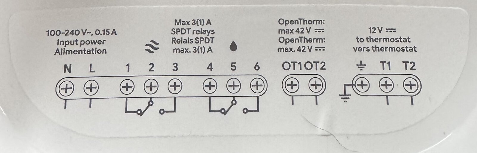

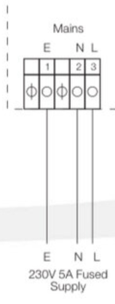

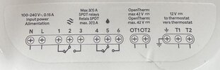

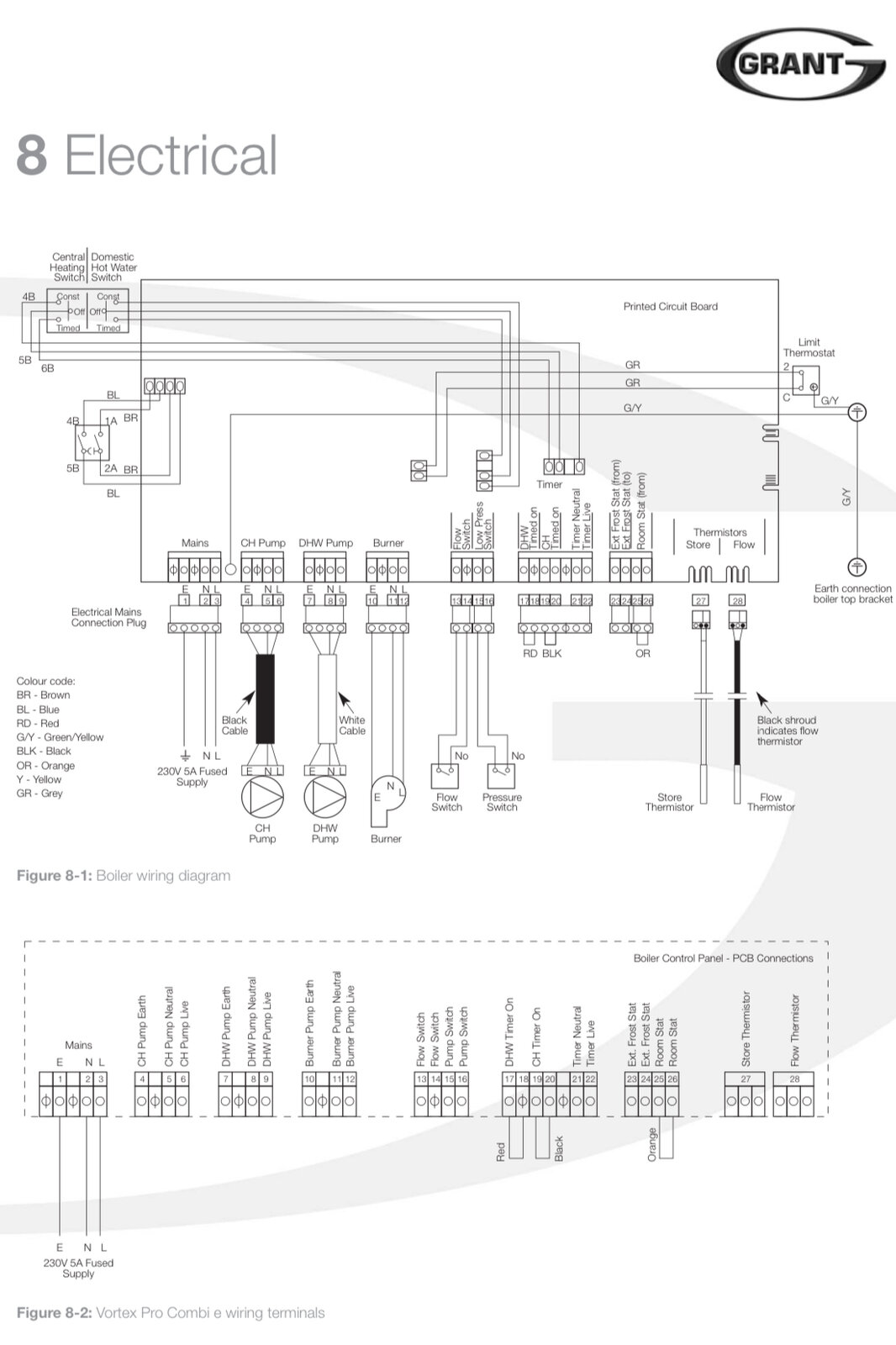

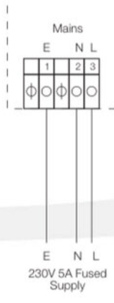

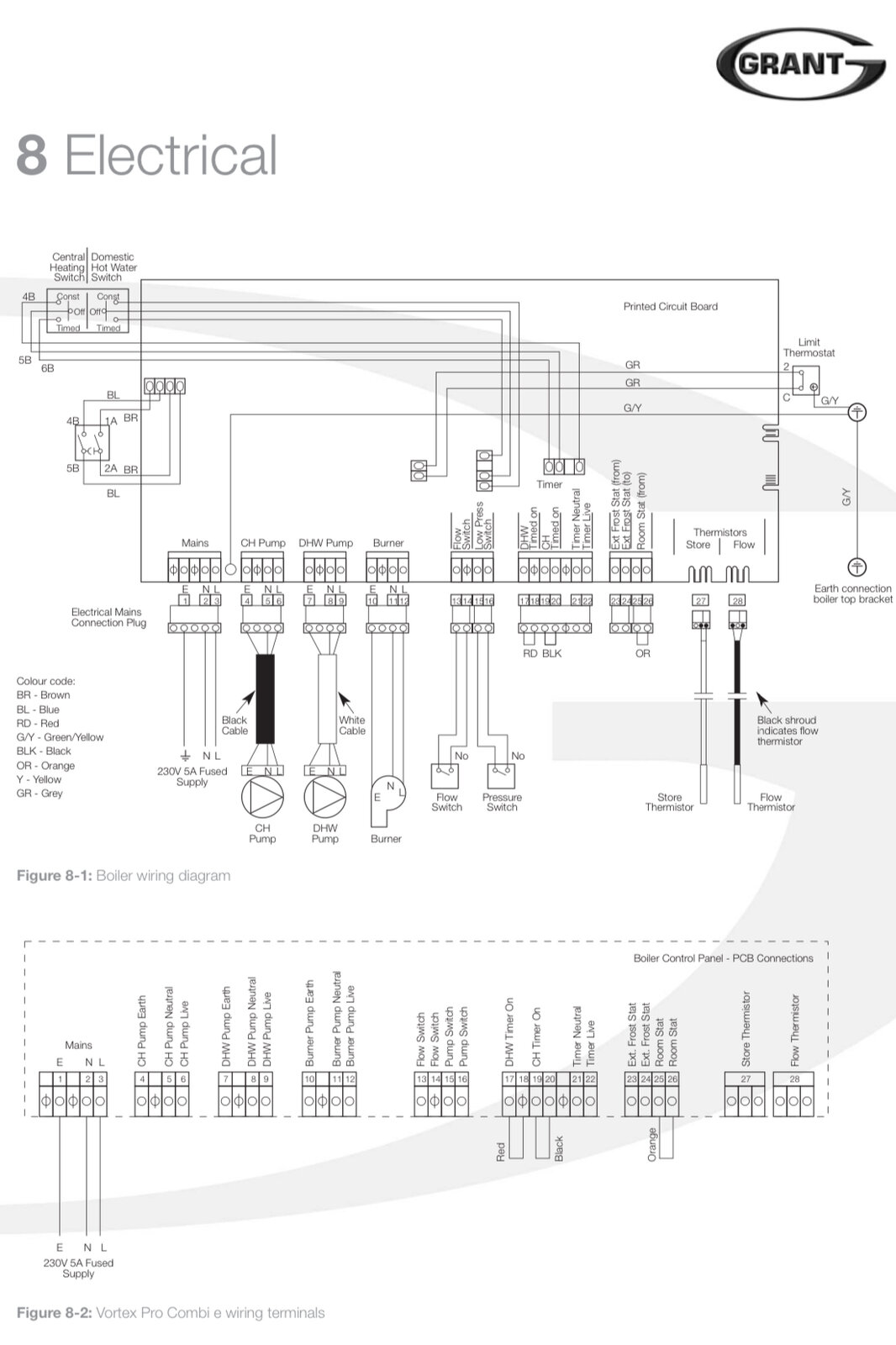

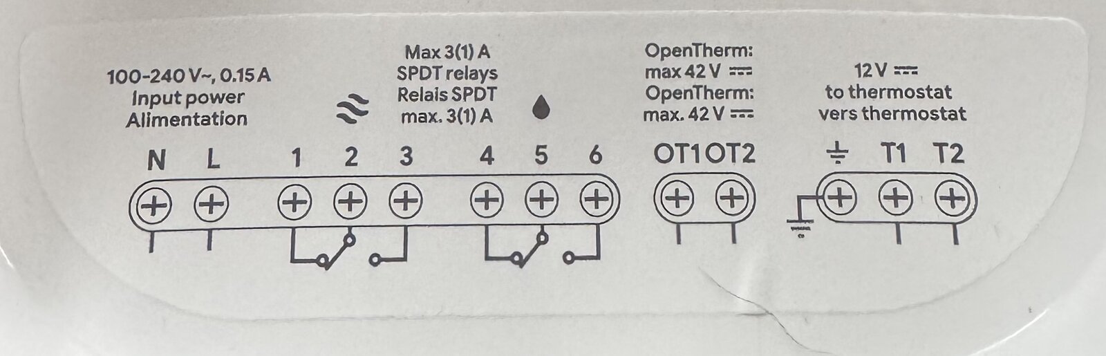

Evening all,
Just moved into a house with a Grant Vortex 26 Oil Combi boiler and no timer or thermostat.
Is it straightforward enough to install a Google Nest Thermostat Heat Link?
I’ve got the wiring diagram of the boiler and the Heat Link attached.
Thanks in advance.
Joe

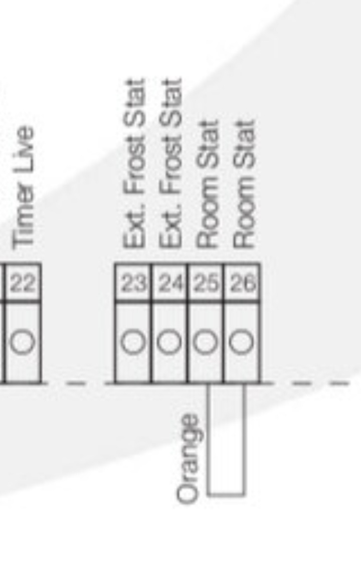

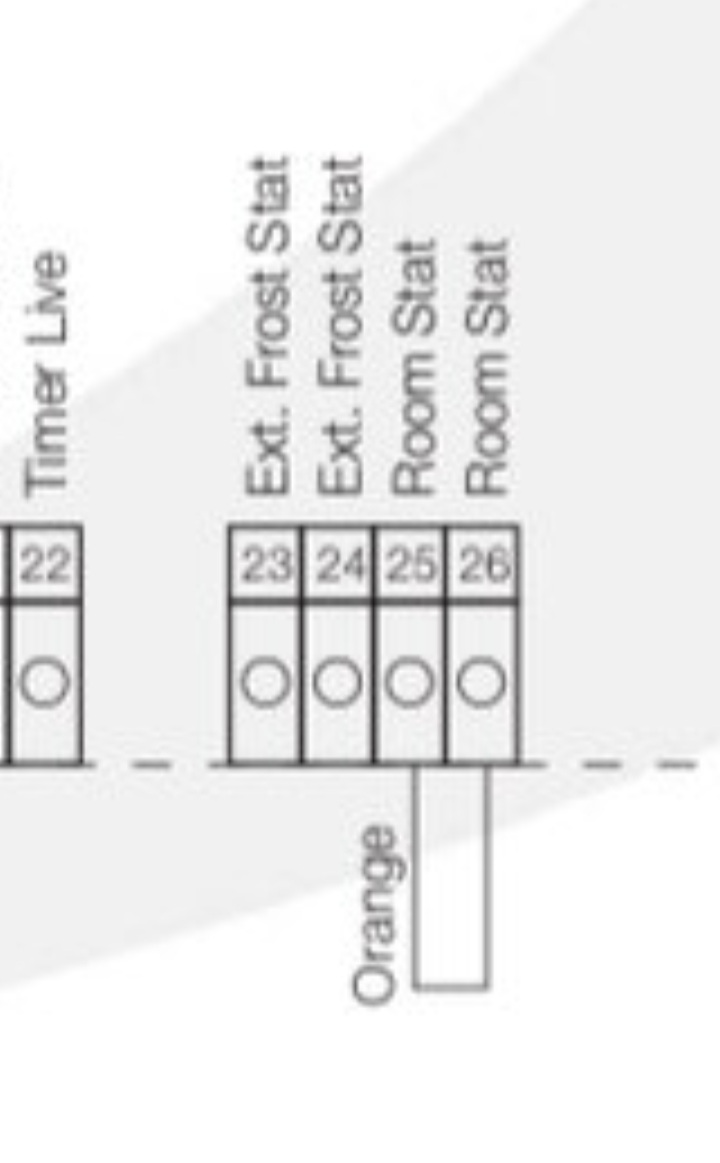

I'm afraid I don't know much about oil combis, but the wiring looks straightforward enough...
N and L from terminals 2 and 3 on the Grant Vortex, would connect to N and L of the Heat link.
You would remove the orange link wire from terminals 25 and 26, and connect these to Heat link terminals 2 and 3.
If you intend to use the Heat link to power the Nest thermostat using terminals T1 & T2, the earth terminal on the Heat link must also be connected to the earth terminal 1, on the Grant Vortex.
Ideally you would use a 4 core plus earth flex to connect up the Heat link.
Thanks for the quick reply.
This Grant boiler simply has an off/timed/constant switch for the central heating. With this wiring setup I assume I’ll need to leave it on constant and the Nest will switch it off/on depending on the thermostat controller?
Joe
