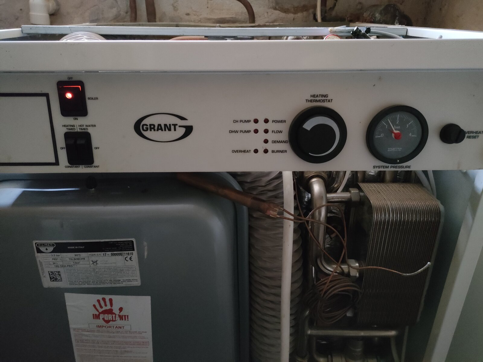

Hi all
Moved into our new house 2 days ago a we've got a broken grant vortex boiler.. there is power to it (power switch led is lit) but no other indicator lights on the panel. Checked all the reset buttons. Had a look at PCB. The fuse is fine and no sign of black on it... Just one tiny microchip has a small hole in it so maybe that's blown? I just wanted to ask for your thoughts as everyone is cold and dirty if there was anything else to check! Thanks!
post pics of external controls etc, just because it has power, if the external controls are not calling it wont come on
Having first checked neutral and live are to terminals 2 & 3 put select switches to constant you should have live feed to 17 hot water 19 heating .

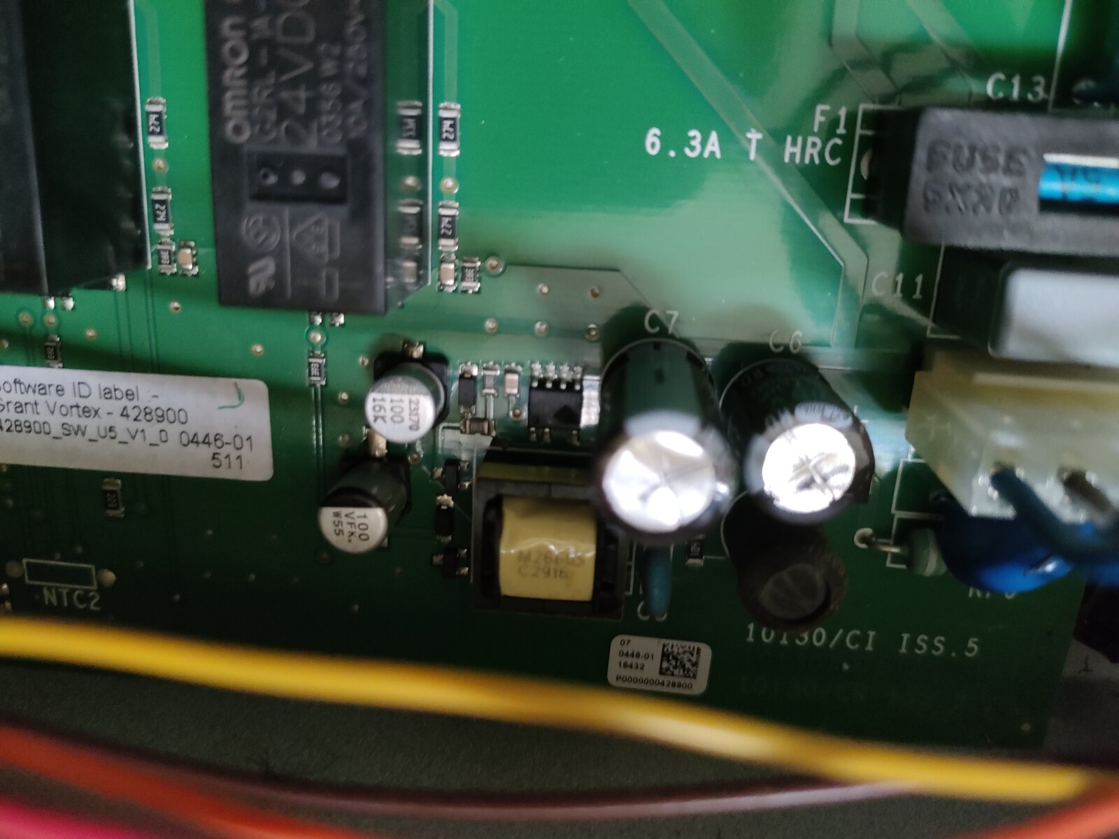

Here you go.. the chip is the tiny one in the centre of the image
I'm afraid that has let out the magic smoke :(

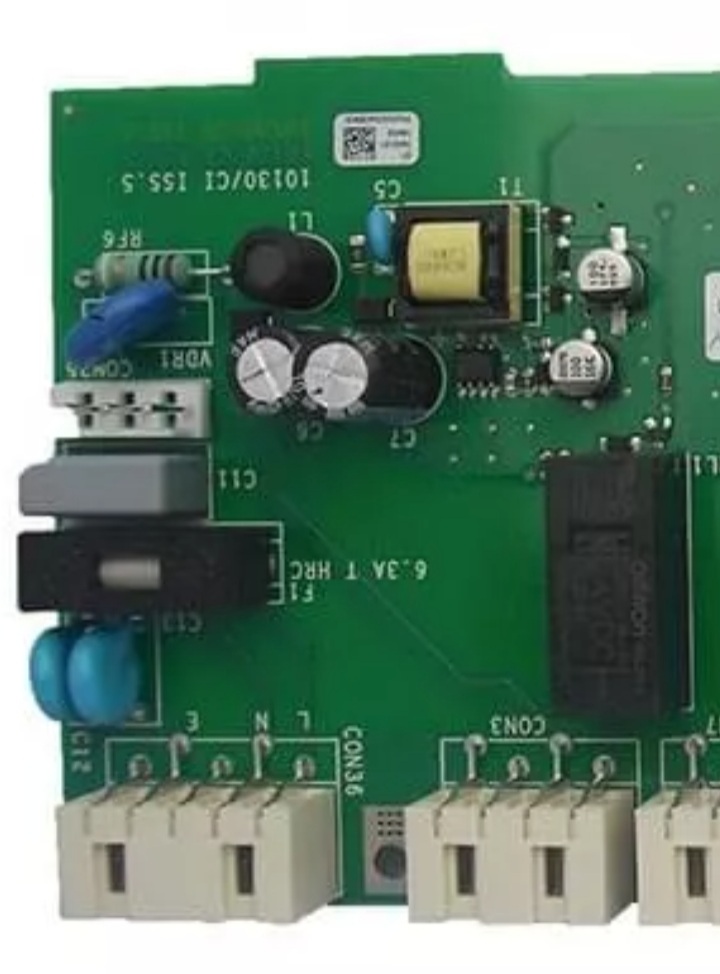

Looking at a listing for the same PCB, that chip is the main part of the PSU circuit - probably a switching regulator...
Unless you know someone handy at soldering, it may be new PCB time.
...there is also the possibility that some other fault in the boiler caused the power supply issue - it would be prudent to check before installing a new PCB.
Looks quite a new Vortex so could be under Grant warranty if a boiler fault. There have been issues with PCBs on newer grants having replaced a few now under warranty so worth checking with them.
