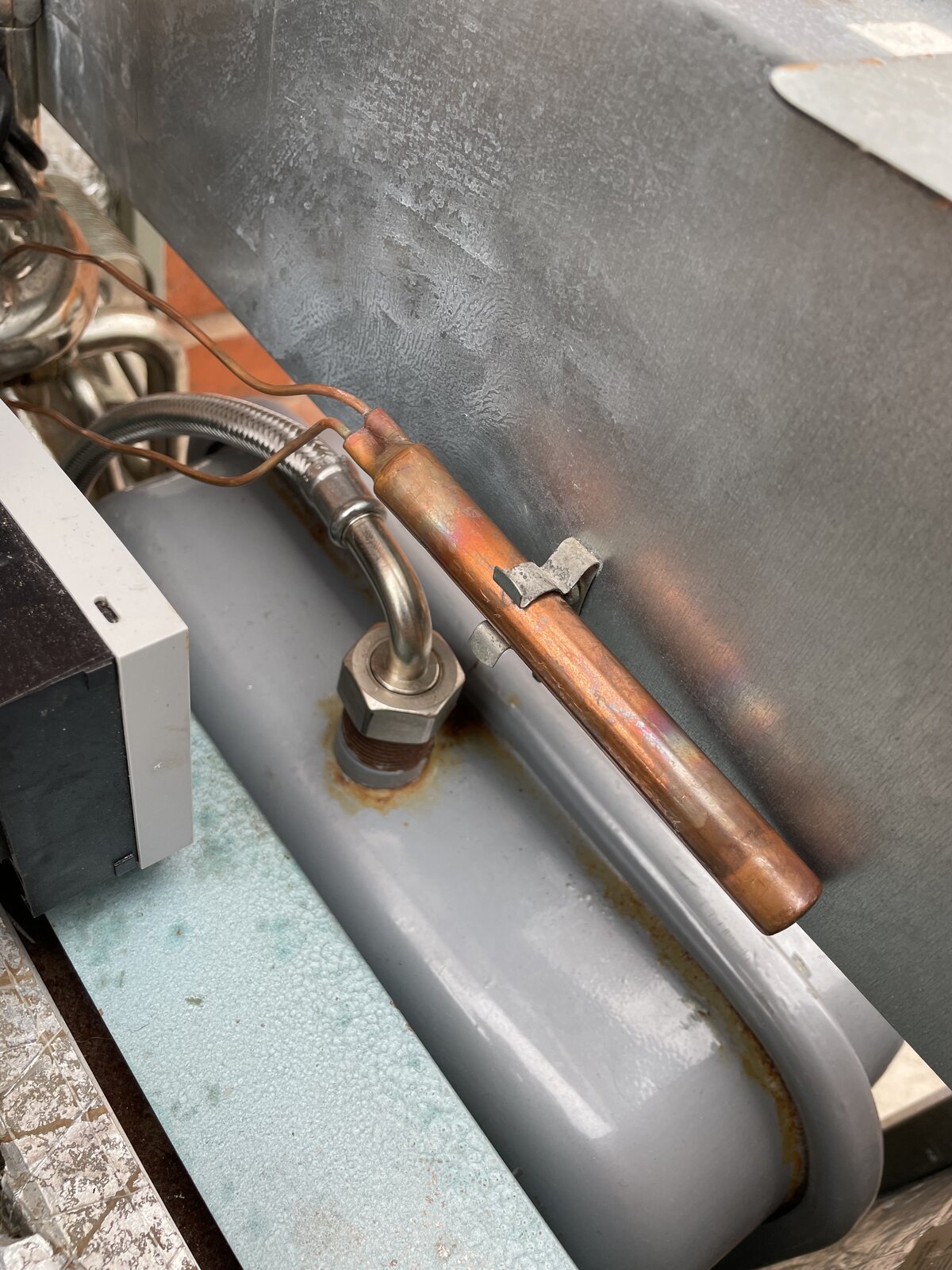

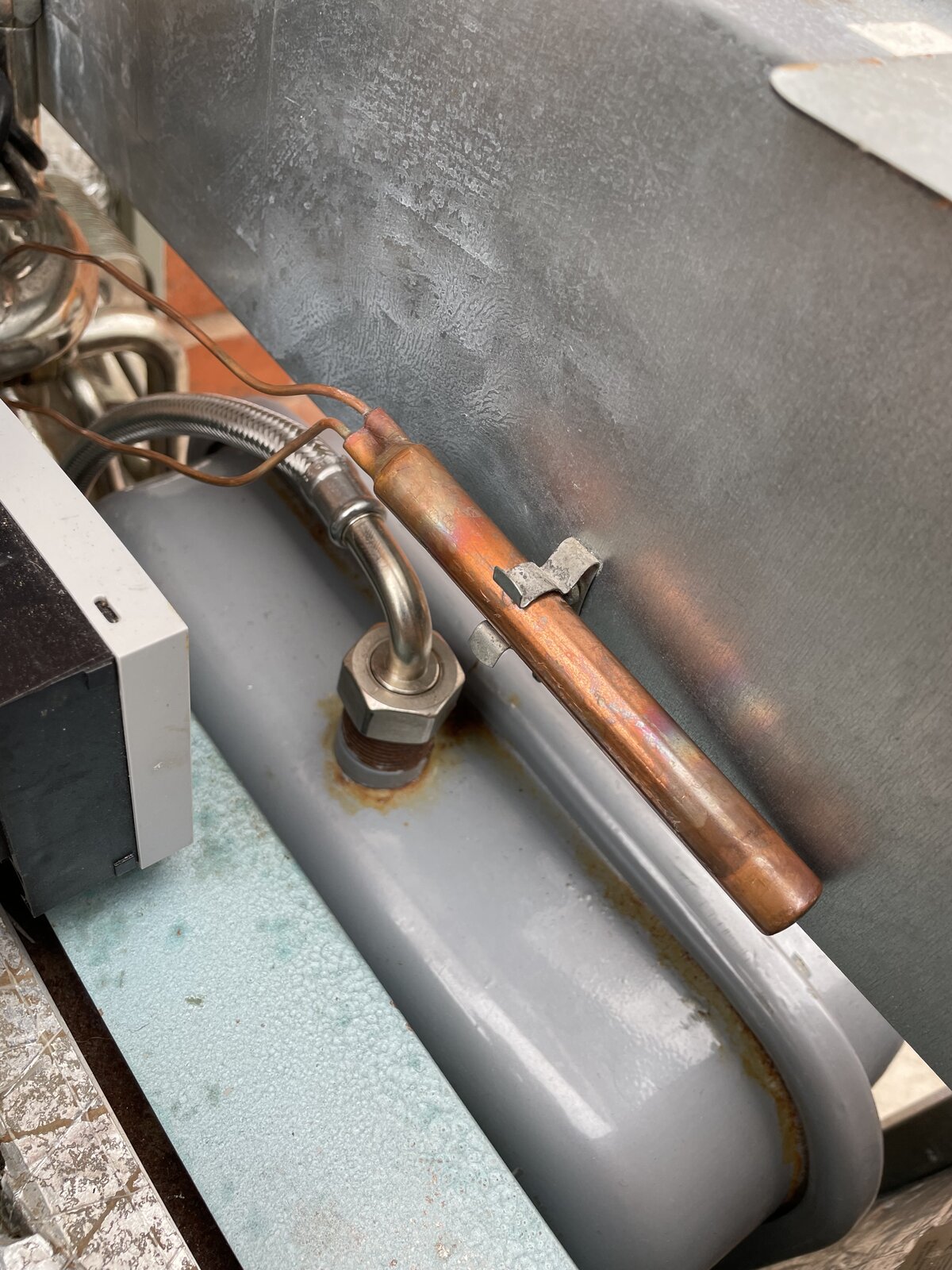

Hi Exedon , quick question for you .
I’ve just noticed the fire valve sensor on my vortex pro is in a clip above expansion vessel is that the correct place ?
Cheers
Clip should be on back side of the thermostat wireing box.
Tho as long as above burner should be fine.
Fire valve needs to be 90 °c the combi's especially can get over 70 c internally if in strong sun light.
Yes exedon this is the 90c version, it does make you wonder why they paint these exterior boilers greens & greys - dark paint attracts the heat - even though supposedly allows them to blend in .
