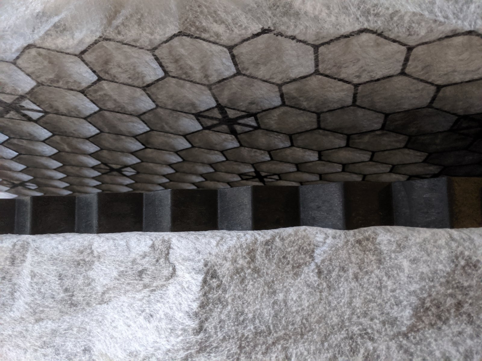

Anyway, I want to lay a gravel area across the front of a house for parking, is there a widely accepted way of doing this?
I was thinking of laying 100mm of hardcore then compacting and blinding it before laying the black membrane. Then I'll have enough stone tipped to give 50mm cover everywhere.
Talking to my neighbour who already has a gravel drive I get the impression he didn't use hardcore, just laid the membrane on soil and tipped the stones.
I'm tempted to skip the hardcoring if possible (too much hard work!), any recommendations?
Jever
I'm having my drive done next month using gravel. We're having 1m at the front paved along with the perimeter as a decorative feature. Were using gravel grids with built in membrane from Euro Gravel Grids.
In the quote builder spec,
6" hardcore
1" sharp sand
2" gravel
It will depend what's there already. You don't want to be laying gravel (that will be driven on) on top of top soil.
But if you're down to the sub soil and it's good hard stoney ground you can skip the hardcore
The grids have an attached permeable membrane underneath to stop the gravel from mixing.
