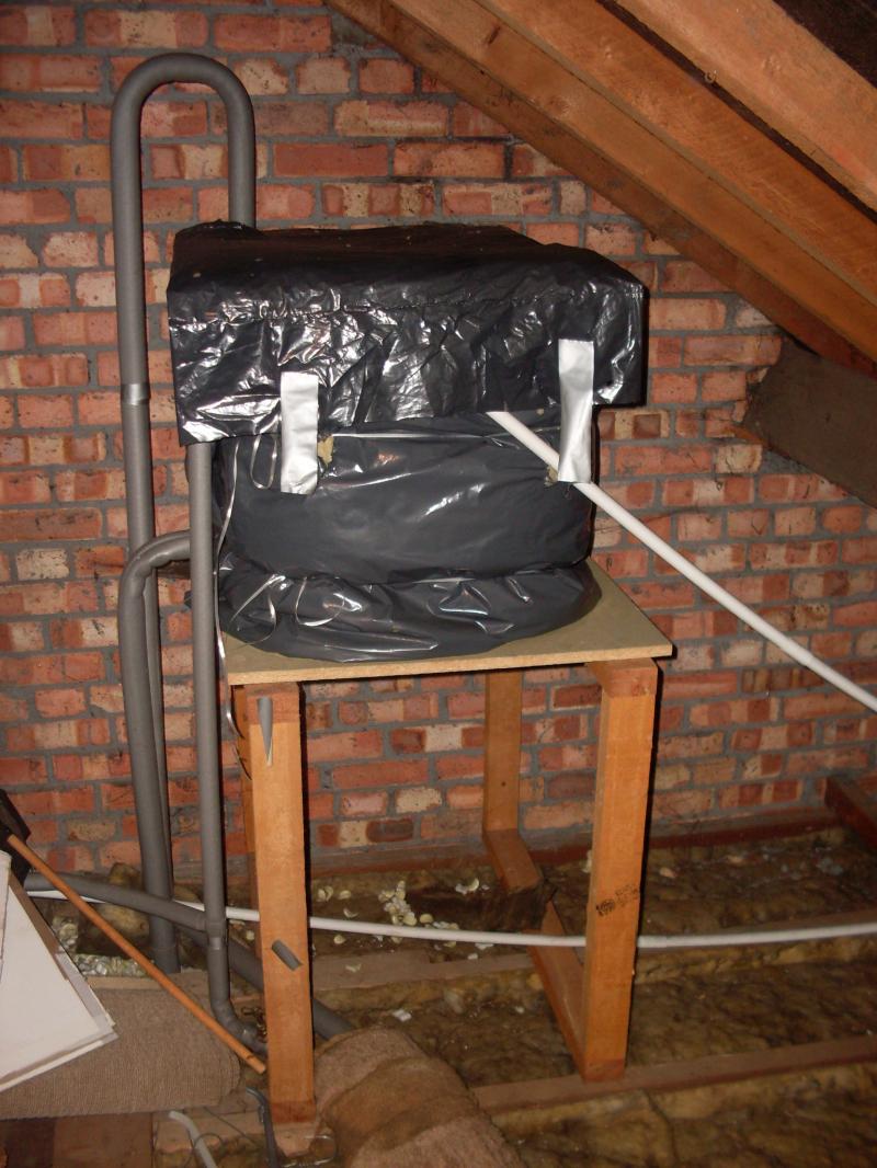

Recently splashed out on a steam shower system for a christmas treat. It needs a balanced water pressure to work effectively.
I have a cold water tank in loft and hot water tank in airing cupboard and so identified my system as a gravity fed system and so bought a 3 bar twin impellar water pump to be installed. However the guy i got in to price up the job says that the cold is actually mains fed and so will not install pump. Please help, i have a feeling hes wrong as all the diagrams i look at online scream that it is a gravity fed system which m,eans it should be fine to install the pump....
What you describe is a gravity hot water supply (By "hot water tank" in the airing cupboard I am assuming you mean "hot water cylinder" as per the photo from seco services) The existing cold water supply will probably be direct from the cold water main at a higer pressure and if so it will not presently be balanced.
However a gravity cold water supply can be taken from the tank in the loft to feed the pump. Then as both hot and cold supplies come from the same tank, they would be balanced, as per the diagram below.
how big is the tank in the loft? You may have a combined hw cylinder which means all the cold taps will be mains fed.

and cobble a bit more wood round the storage cistern :eek: some diagonal braces of 6x1 inch timber wouldn`t go amiss
Thats quite a small tank in the loft and there is only ONE downfeed which is likely doing the hot.
So cold must be off the mains. You would need to change to a larger storage tank in the loft and take an additional cold feed to the shower from it.
