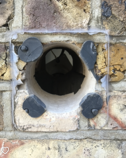

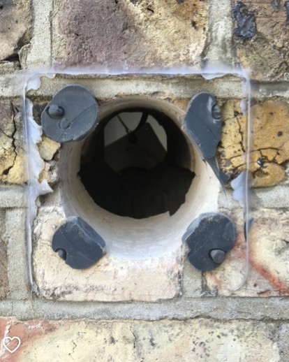

Reviving this thread as, guess what, the vent came away from the wall, and I discovered they had attached it with some kind of stick on rubber pegs. These had totally broken off.
Worse, once I pulled the vent away I could see that there was no ducting, just moist air being vented into the hole in the brick.
Not only would this affect airflow, but would probably lead to brick damage/spalling/mould over time.

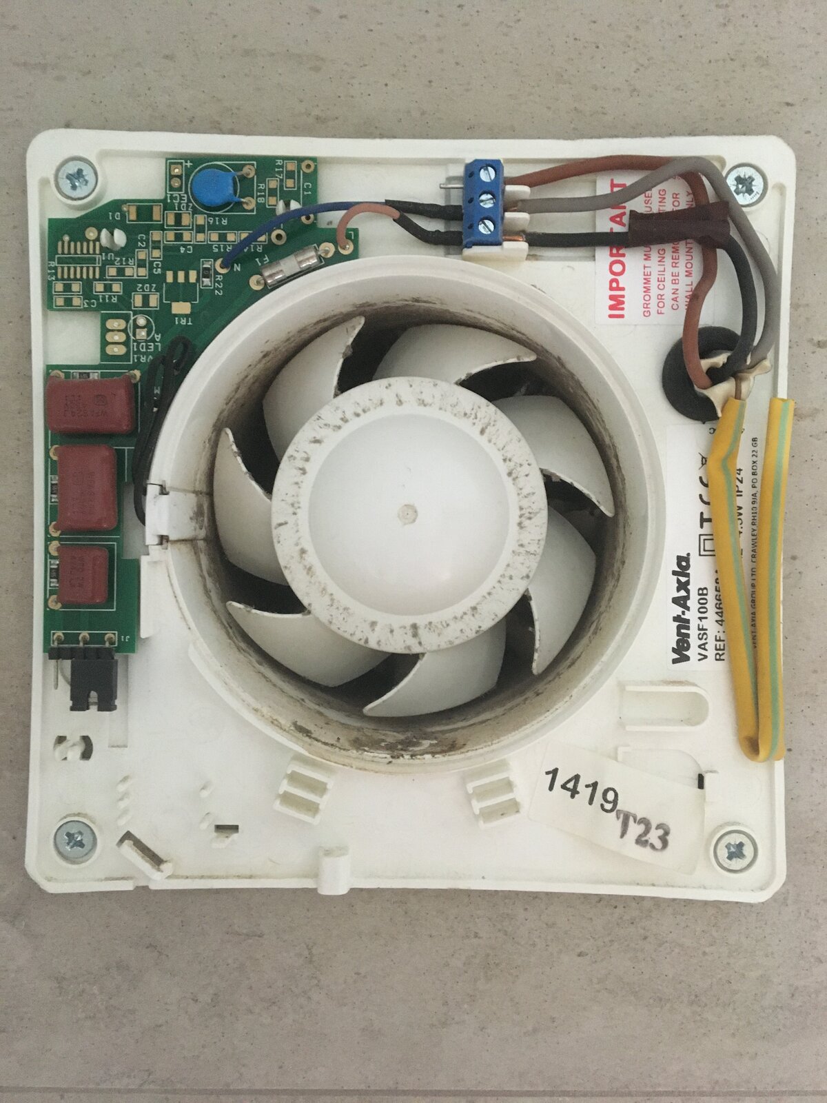

I am surprised that no one else has mentioned that the supposed electrician has used the earth in the flex as the switched live, meaning that there is no earth protection on the flex. The fan doesn't need an earth but (although, I am not an electrician) I was under the impression that the cable needs earth protection.

Here's a few photos:
The strange rubber pegs that were meant to pop into the vent's screw holes had totally disintegrated.
Decent enough hole drilled, but still porous and uneven surface.
The wiring with the face plate removed. The base unit seems a bit warped, maybe explaining why the cover was very difficult to remove.

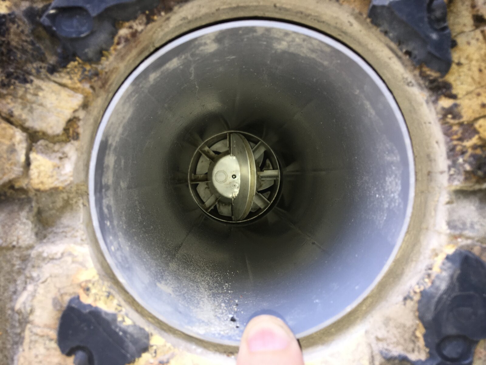

I added a piece of 35cm 100mm (female) plastic tubing from screwfix for about £3. It fits snug onto both male coupling for the fan and the duct.
This was a little tricky to do since the wiring was tight and had a very narrow space above the duct. I had to shave off a little bit of the inner diameter to get the duct to connect with the fan by pushing it through from the outside. A small pebble was placed on toop of the tube to angle it downwards in case of any condensation runoff.
No adhesive or foam used. I should really have drilled holes for the vent, but this was above head height on a sloping roof with fragile slate, so the snug connection to the duct and silicone around the edges got the job done. I'm no professional and just someone learning how to DIY.
But the main thing is that the fan is now much more effective.

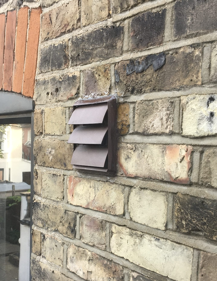

The other photo shows the flaps opening normally. This is with the bathroom door closed. No difference with it open really, as I made very sure they left a 1cm gap under the door.
The only downside is that the fan now resonates a bit, presumably at the resonant frequency of the duct. But that's a small price to pay for much better extraction and minimising risk of damage to the brick or mould.
Making this change proves how important friction-free uniform airflow is in determining an axial fan's effectiveness.
They aren't rubber pegs. They used silicone dots and pushed the vent on, the excess silicone pushed through the plate screw holes (giving the impression of rubber pegs).
Apropos my earlier (incorrect) post about their wiring, the wiring looks to be fine.
