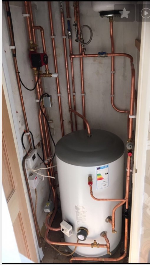

Initially, my plan was to have the cylinder fitted in my loft next to the boiler to gain an extra cupboard downstairs but that idea was overridden by my wife who wanted to keep it where the vented cylinder was so that she retained an airing cupboard. Oh, and get one bigger than you have now - as it is mains pressure hot water, you get a nice powerful shower but it don't half empty the tank quickly!
For what it's worth, practically no heat is given off by the new hot water cylinder as it's super insulated. Our airing cupboard heat comes from all the surrounding pipework.
Here's mine mid-install.
