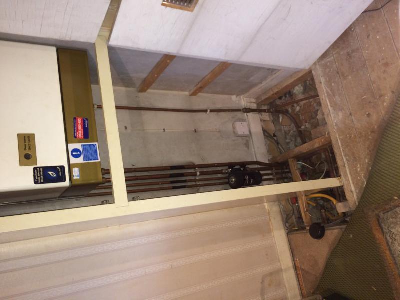

Right I've had a look at the system. The gravity circuit from the boiler to the cylinder coil is on 22mm pipework.
Tee'd into the bottom connection of the cylinder coil is the 15mm pipe from the bottom of the F&E tank in the loft. Tee'd into the top connection to the cylinder coil is the 22mm vent to the loft.
I would like to fit a zone valve to one of the pipes as they leave the top of the boiler. if so, which pipe should it be fitted to?
Also I understand our gravity circuit is a bit on the small side. Is a 22mm zone valve likely to cause a restriction? Should I use a 28mm 2 port instead?

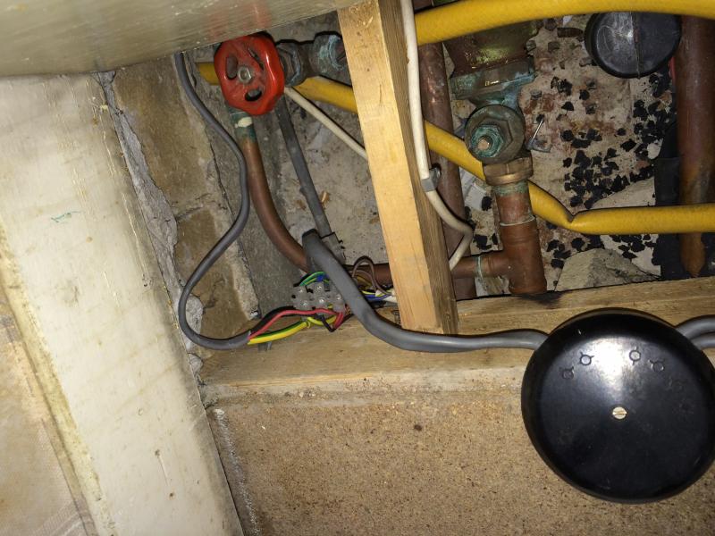

Here's a couple of pics of the boiler area. I'm also going to replace the pump and move it from under the floor to the boiler cupboard. Is it ok to leave it in the return pipework as it currently is, or would it be better in the flow pipe?
Cupboard:
Pump:
Wiring!:
Sorry the pics are on their side. The forum software has decided to rotate them for some reason :rolleyes:
Ok maybe this was too many questions for one post! My main question at the moment is regarding the pump.
Would it be best to keep it in the return pipework as it is now, or is it better moved to the flow pipe?
Thanks for reading!

Don't move the pump if it's working fine as it is. No advantage.
Thanks for your reply. I definitely want to move the pump from under the floor. I had a problem with it earlier in the year and it was a royal PITA to work on it where it is.
If it's better left in the return then so be it. Would you put it above or below the magnaclean?
