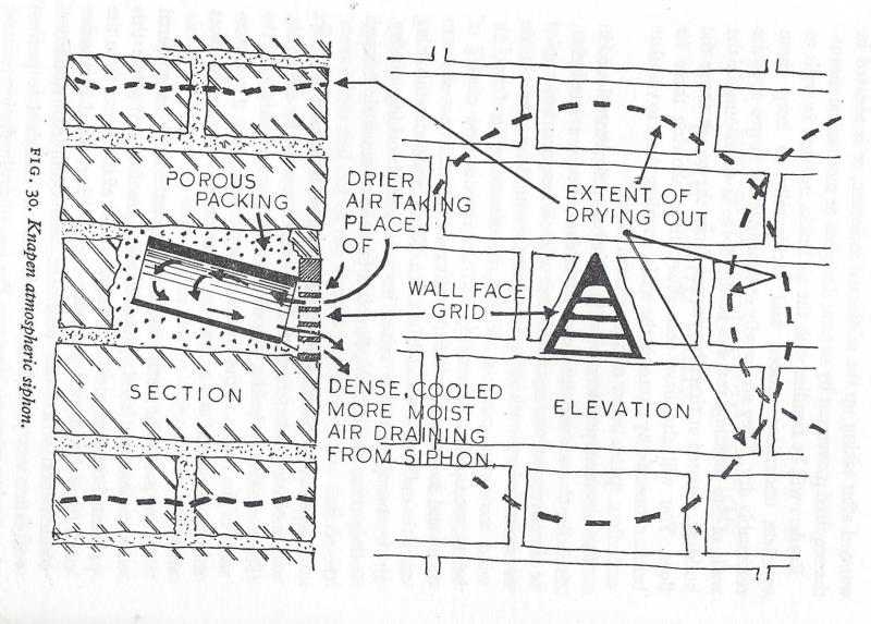

Has anyone had experience with the damp proof system calling itself Dutch and Green System? They basically seem to fit air bricks to improve air flow from the wall.
Is this what you mean - taken from an old book. Don't know if it's Dutch or green, or if in fact it worked. I would imagine the bricks would have to be fairly soft and porous for it to work
These systems have been around in one guise or another for many years. Holland, Dutch, clay pipe come to mind.

I saw a report on these systems a few years ago. If I recall correctly the basic conclusion was that they work when the air pressure, temperature and wind flow is favourable. The question is how often do those conditions occur in reality? From memory it found that those conditions might (might) occur on one or two elevations of a house but it would be highly unlikely on all four. The most likely outcome would be success on one elevation for some of the time. Of course the manufacturer's would claim otherwise but my guess is they test in ideal conditions.
Yes that was the report from the Dutch TNO - Organization for Applied Scientific Research from the mid-80's
Basically the theory would work if certain conditions existed in a certain way at a certain level ..... for all the time. Their test was limited in scope and were laboratory tests not real-life studies.
Also the walls used for the test have different construction to ours in the UK, and the conditions simulated were not the same conditions as UK prevailing weather would be.
