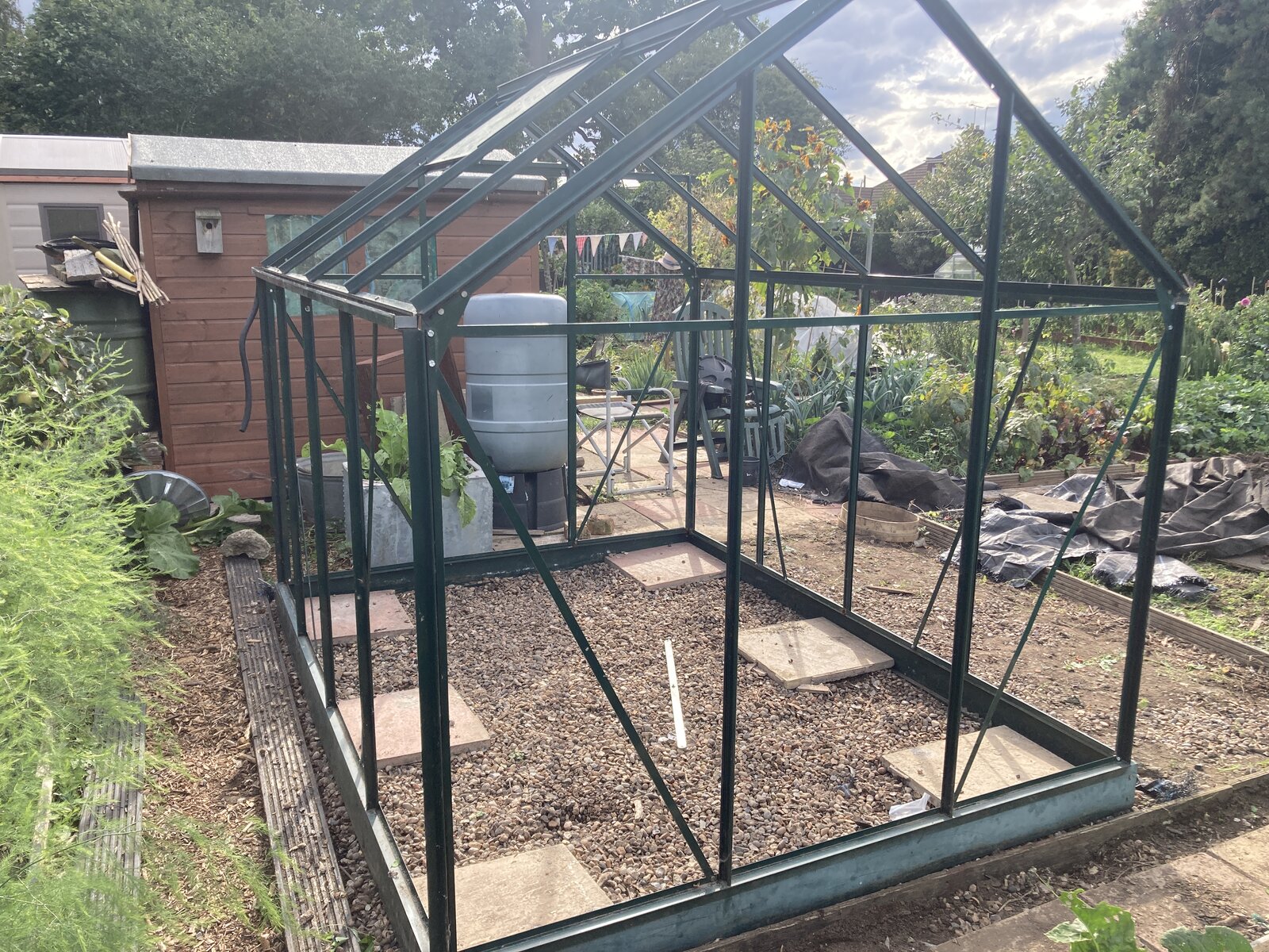

I think that’s way OTT for a greenhouse. If you want a solid base, just use paving slabs. Some do that over the allotment. Some sit theirs on a single row of breeze blocks. Nobody has a 6” concrete base. Mine is just sat on a bed of gravel with a weed membrane underneath. Some just rest theirs directly on the soil and plant into the ground. Anyway, you need drainage in there. On hot days, everyone just chucks a bucket of water on the floor as it creates humidity in the greenhouse.
Here's mine going up.

Yours has the steel base which adds rigidity, mine doesn’t, I could get one, but it costs £120 i.e. the same as concrete plus mixer hire . And then there’s the cost of paving stones. My garden is sloping, about a 4” drop over 10 feet, so concrete will let me get a level, okay not really required. The brick wall will act as a raised bed to avoid planting directly in heavy clay. (The soil will improve with time as the compost sinks in.) I’m guessing you have a Halls popular too.
