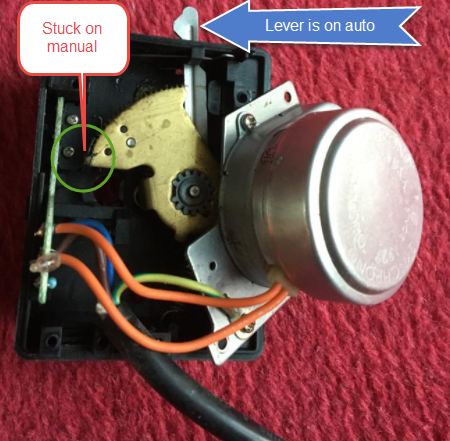

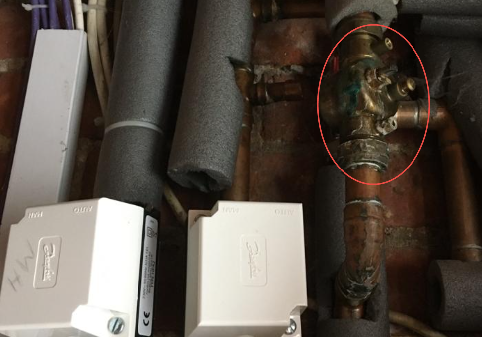

I checked the HW and CH actuators when the boiler is on. When I pull the lever to manual for HW actuator, I hear whirling sound and there is resistance. CH is loose and moves without sound right and left. Just in case I have ordered Danfoss HPA2 actuator and valve.
Is it PCB, thermostat, controller or operator aka me?

After Terry's question I solved the mystery. Thank you both.
Issue is faulty 3rd actuator.
Somehow when previous owners built the conservatory, they have added single rad with it's own actuator, instead of integrating into existing heating zone. This rad had Horstman actuator. It was the culprit. Actuator was stuck in manual and kept sending conflicting messages to the controller and boiler. I took the actuator off and dismantled it. I saw it was stuck in manual operation. When initially boiler ignites, this broken actuator keeps the boiler on constantly. Without broken actuator boiler, control panel and thermostat work without issue.
Luckily in next 2 weeks I am getting hot water cylinder changed to indirect unvented one. I will get this single rad to be integrated or exchange the actuator & valve to Danfoss HPA2.
