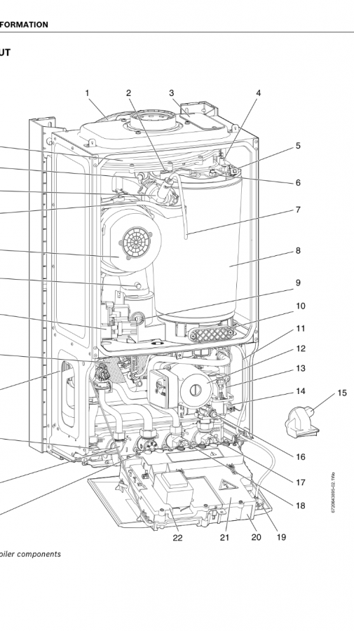

Hi I have a Greenstar 28i jnr and was told to pressurise the ev (slow air loss over 4 years) and bleed heat exchanger
is there a valve to bleed the HE and is it the plate one
cant find it in the pdf
the problem is it runs for 10 min okay with pump over run on
but any longer than 15 min its a full cut out with no pump over run
no flashing light codes just starts up after 10 mins
I was told its air in the HE but the guy coming out next week seems to think there is no bleed valve to remove air pockets from the HE
bar cold 1.5 bar hot 1.6 when okay, now bar 1.5 cold bar 2.2 hot
I know it could be told its a restricted HE but hope its air causing a hot spot?
rads good no air hot at top and bottom
high point in the system is the boiler so any air goes to boiler
system age 5 yo
not been inside, used the docs as im a pc builder and a mechanic not a boiler fixer :)
Its a tube inside the boiler on top of the hex. Doubt its air trapped in there as it would make a proper racket.
Number 7 on image.
I don't think I have ever used that bleed point on one of these and I've worked on hundreds. The one on the pump (automatic) bleeds enough for the pump to then just push it all into the radiators.
I've only ever used it when fitting and filling from new.

No, it won't be air or you'd have the same issue on CH. Banging on DHW means either poor circulation either due to a blockage in the boiler or less likely a slow running pump.
so a new plate heat exchanger or could it be removed and back flushed
would the CH short run time be thermal then?
