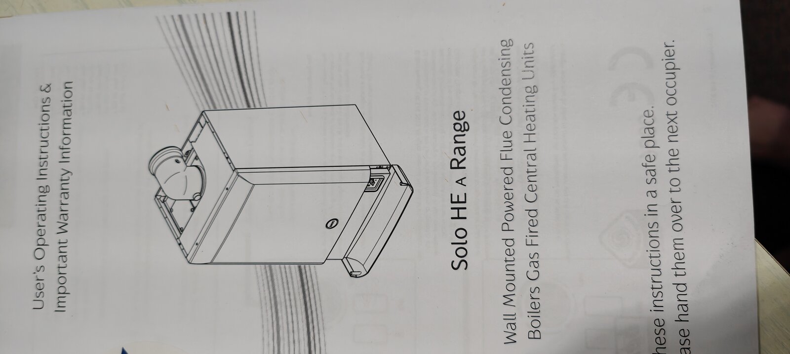

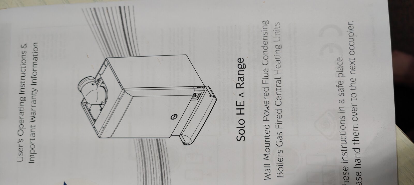

This is the boiler. I am just trying to look to see if it mentions a pump.

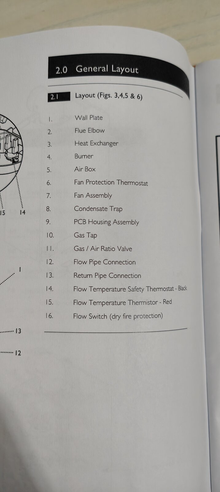

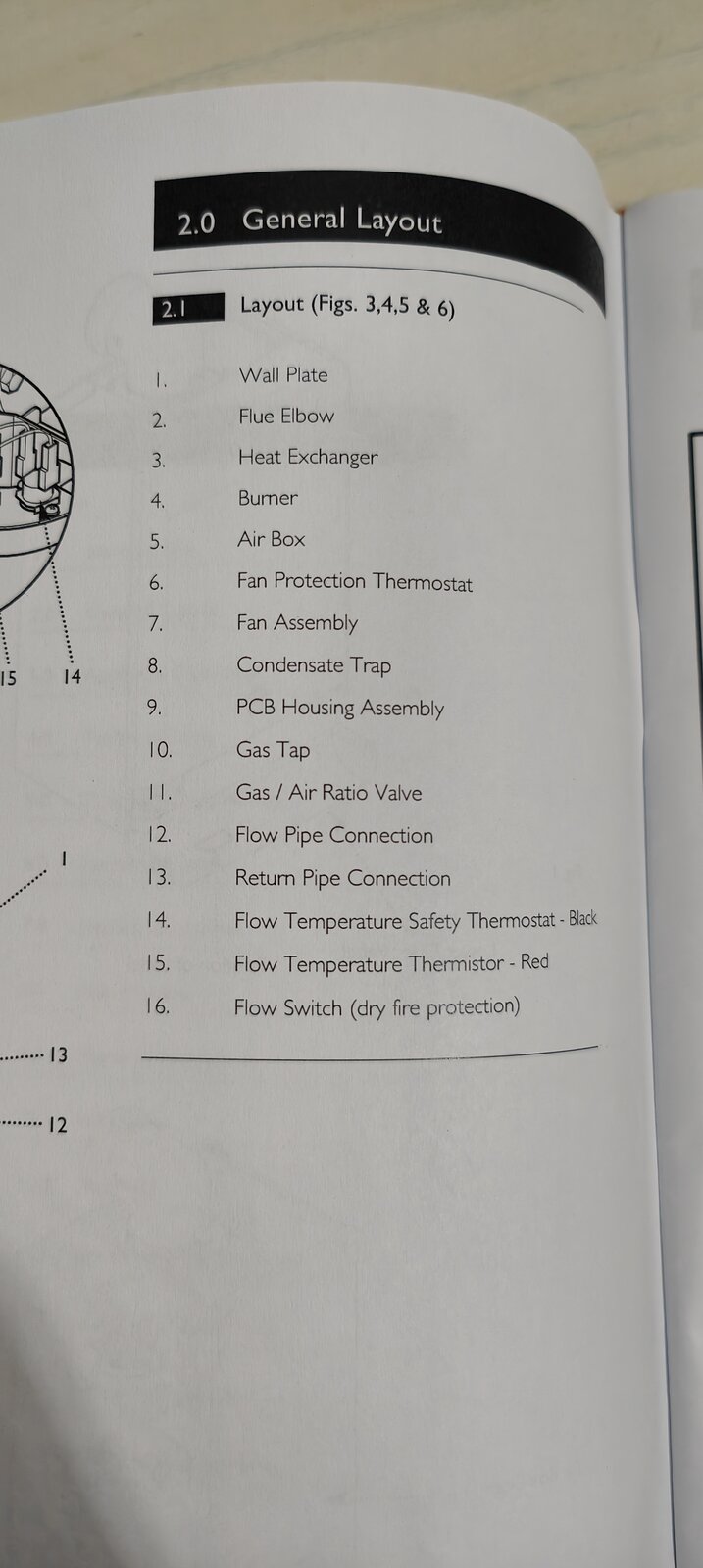

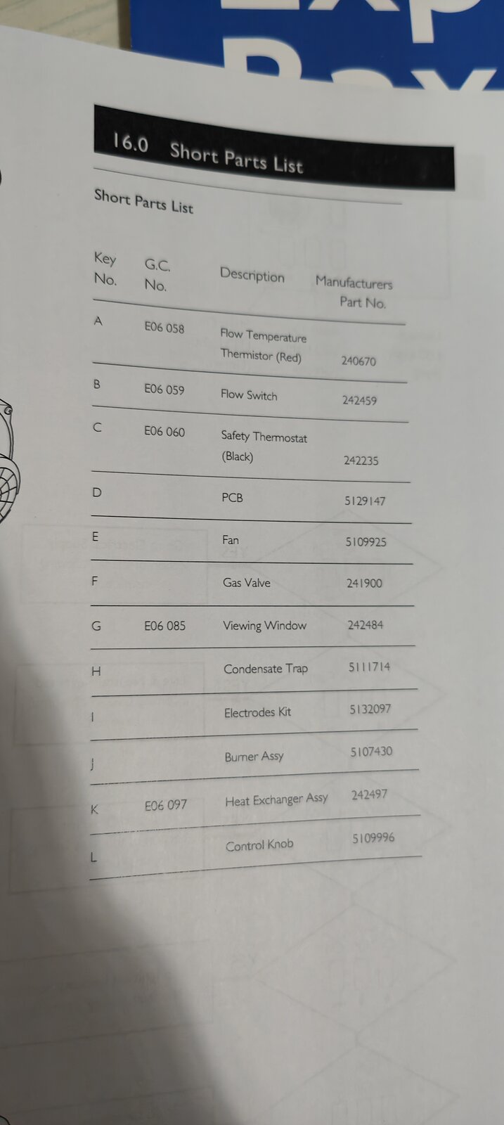

This is the parts list and the general layout if that is any help. It is all like a foreign language to me!

No it doesn’t have an internal pump. If it’s not the fan I’m not sure myself entirely what it could be. Maybe the solenoid on the gas valve?
