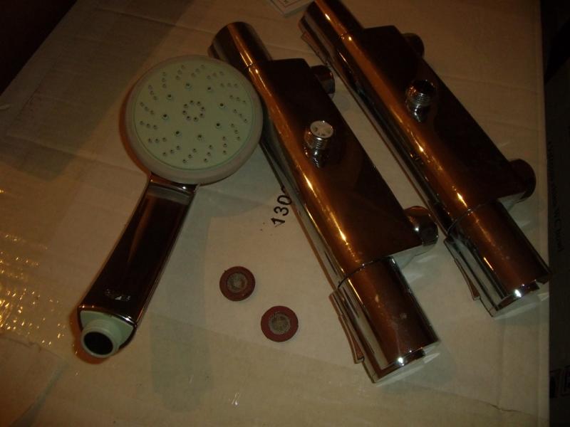

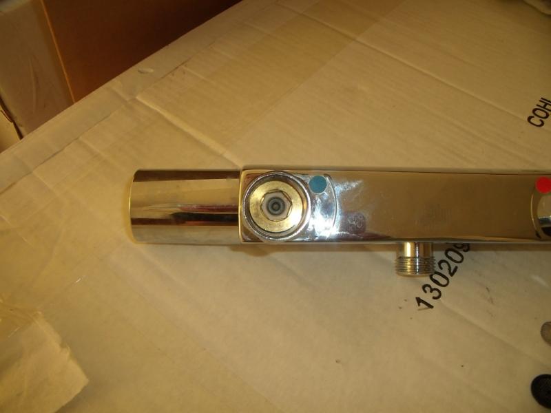

I am puzzled over the weak performance of my grohtherm 1000 shower. When all connected up I am only getting a maximum of 9 litres per minute through the showerhead at normal showering temperature, even when I bypass the economy button. However when i remove the valve and measure the flow from each of the pipes i am getting 16 l/min from the hot feed and 28 l/min from the cold. The valve specification gives 25 litres a min for a balanced pressure of 3 bar and so this is roughly what i was expecting....ie 2 to 2.5 times what I am getting. The temperature of the hot water feed feels about normal...ie very hot so i cant understand the low flow rate. Am I doing something wrong or does 9 litres a min sound about right? Regards Steve
