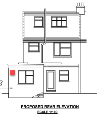

We're about to just complete a ground floor bedroom and bathroom extension. Rather than deal with the hassle of running messy cables everywhere to the existing sat dish at the front of the house (some 20m) away or connect to the existing aerial on the roof or the amplifier in the front lounge, I thought I would just fit a new one of each on the extension. This will probably be cheaper and cleaner to do.
How easy is it to tune a sat dish to pick up Freesat without the need to call an engineer etc to do it?

Forgot to add, does it matter where the dish is positioned (red square) on that wall if it needs to point east?

If the existing dish is on the front of the house that is because it needs to be there to see the satellite. Putting one at the back would therefore not work.
It needs to point approximately south east, the same direction as the existing one.
What everyone has said about the direction of the second dish needing to be the same as the first is absolutely correct. The signals for Freesat come from the same satellite as those for Sky. If the 2nd dish isn't able to 'look' in the same direction because the building is in the way then it won't see the satellite it needs to in order to work.
