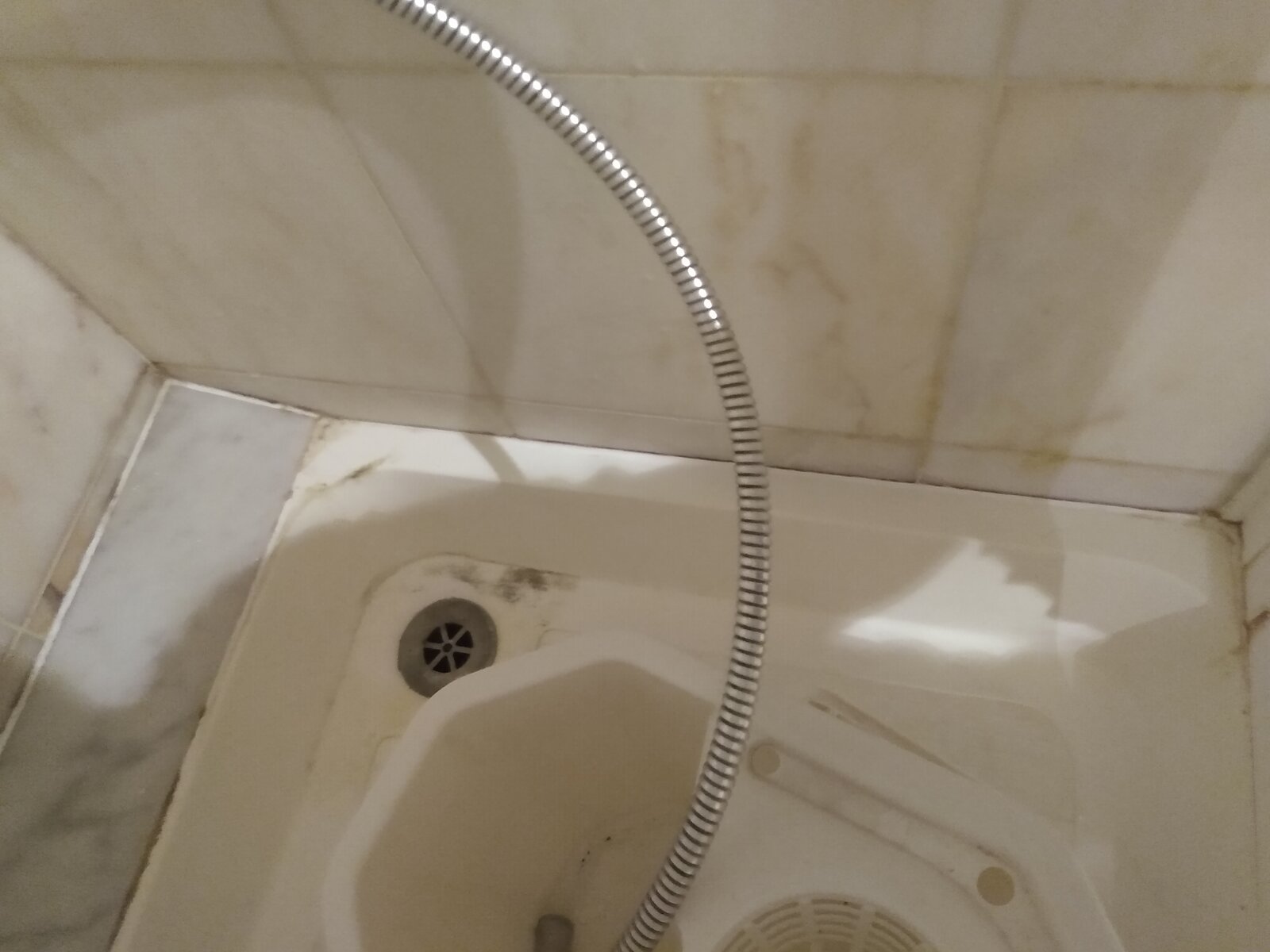

Hi all
My old marble-tiled shower (pictured) is leaking from the gaps between the tiles.
I think it's mainly coming from the hairline gap that runs along the bottom edge of the tiles, where they meet the shower tray, but I'm gonna re-do the whole lot anyway.
My plan is to use an oscillating tool and diamond-tipped blade to carefully remove the old grout.
Should I then use grout or silicone (or grout then silicone, perhaps at the bottom edge) to repair?
Thanks in advance
Remove the old silicone , grout , then on top of that do a silicone bead all-around the edge of the tray and tiles to the side of the tray
Dow Corning silicone is very good
