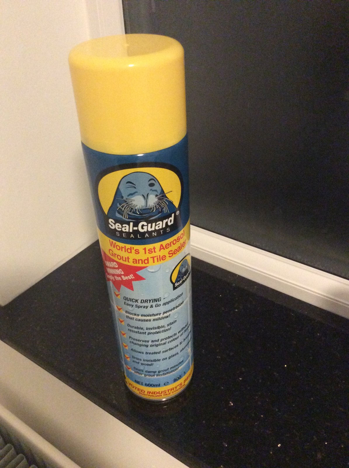

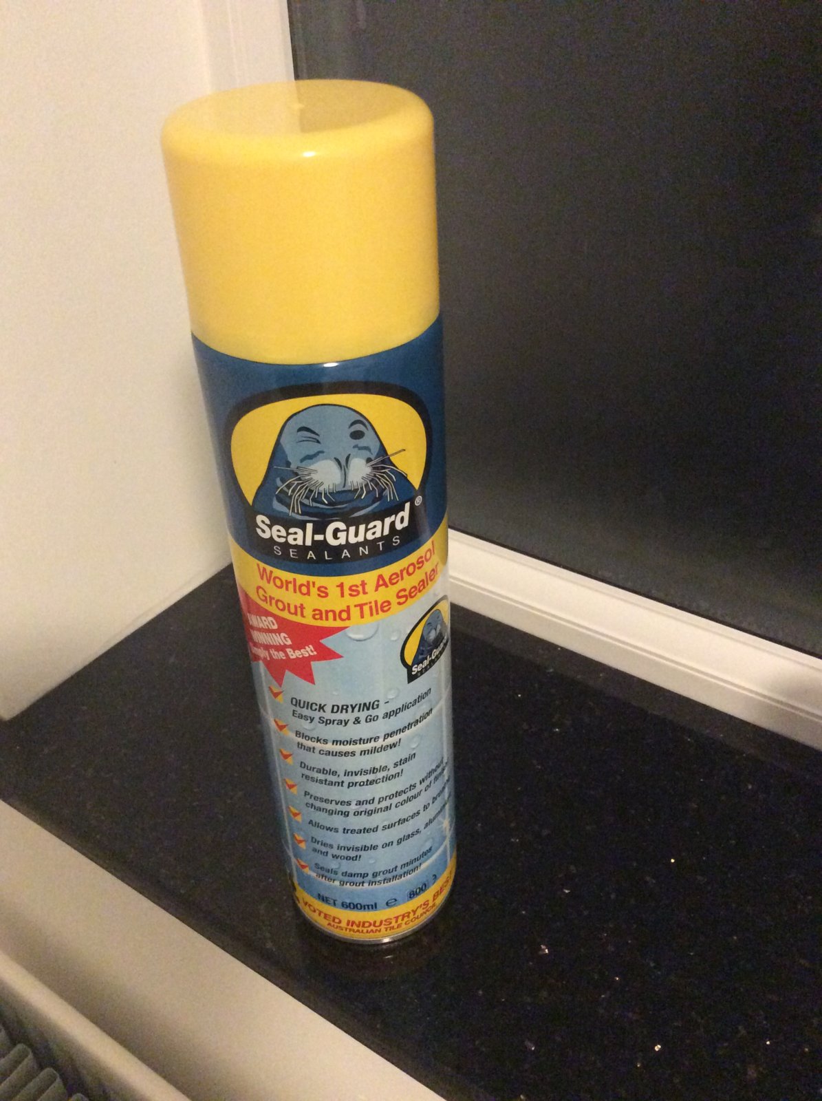

FED944C9-4390-4E83-A44D-CA1BF7263E78.jpeg Ive been using this stuff for around 20 years and really rate it
