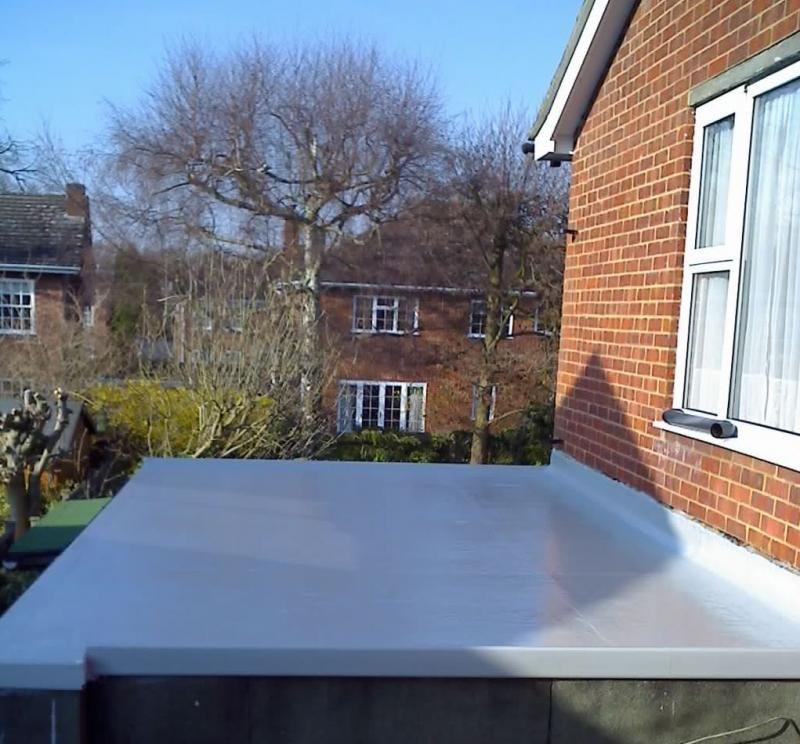

We are Firestone aproved contractors and GRP suppliers Installers there is no comparison GRP if done correctly will last for years you need at least 2 layers of 450 matt I will only use EPDM on industrial contracts does not matter how well it is fitted it will look rough after a year or so. EPDM is purchased for £6.00 M2 cost of GRP £50.00 M2 fitted you can do the GRP yourself pick up the materials from us free training
Check out the-roofer.co.uk photos of both

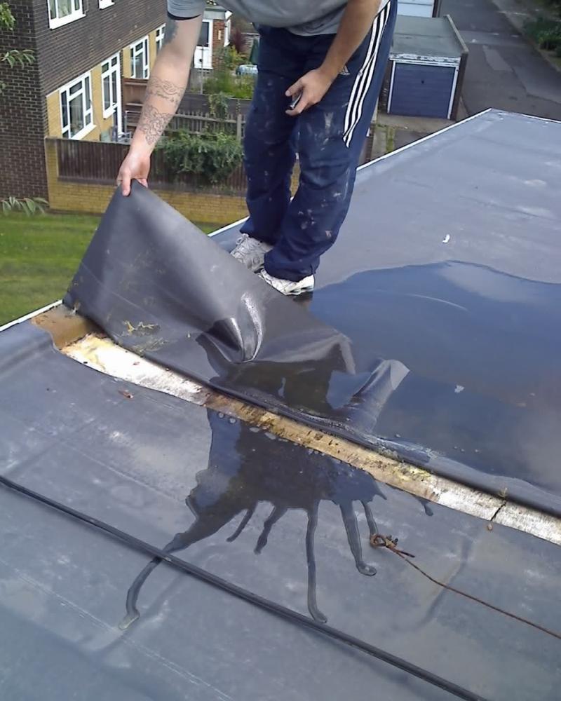

EPDM supplied and fitted by large Window Company now offering roofing services
We were asked to look at a leaking roof, the water is just a puddle the joint was just lifted back it was supposed to have been laid in one piece.
The operative who had done the work for a large window company had been a milkman done 1 days training in EPDM then let loose on an old ladys roof she was charged over £4000 for 60M2 and it leaked from day 1 she never got her money back guarantee worthless.
Thats the type of guys that give the trade a bad name, no pride taken in their work.
It looks like it wasnt glued down, was there a splice tape joining the 2 pieces, and was it done correctly.
Looks like no 3"" seam tape was used IMO.
Yet another so called Flat Roofer who thinks they can fit EPDM and who clearly knows nothing about fitting it. No care and pride in the work whatsoever.
