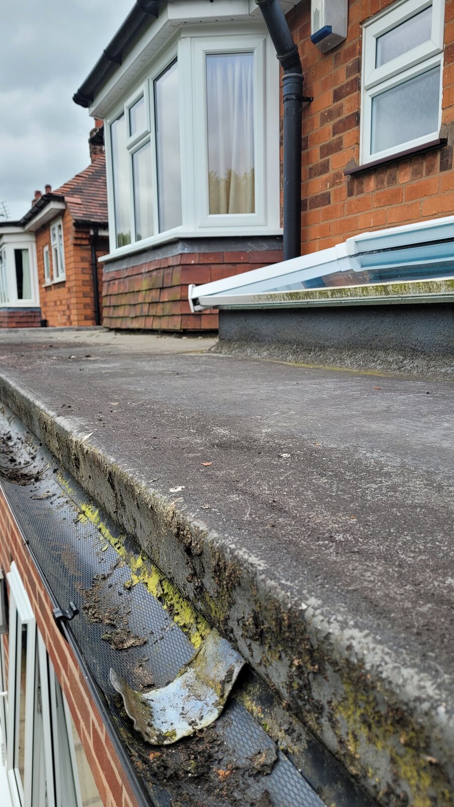

Hi,

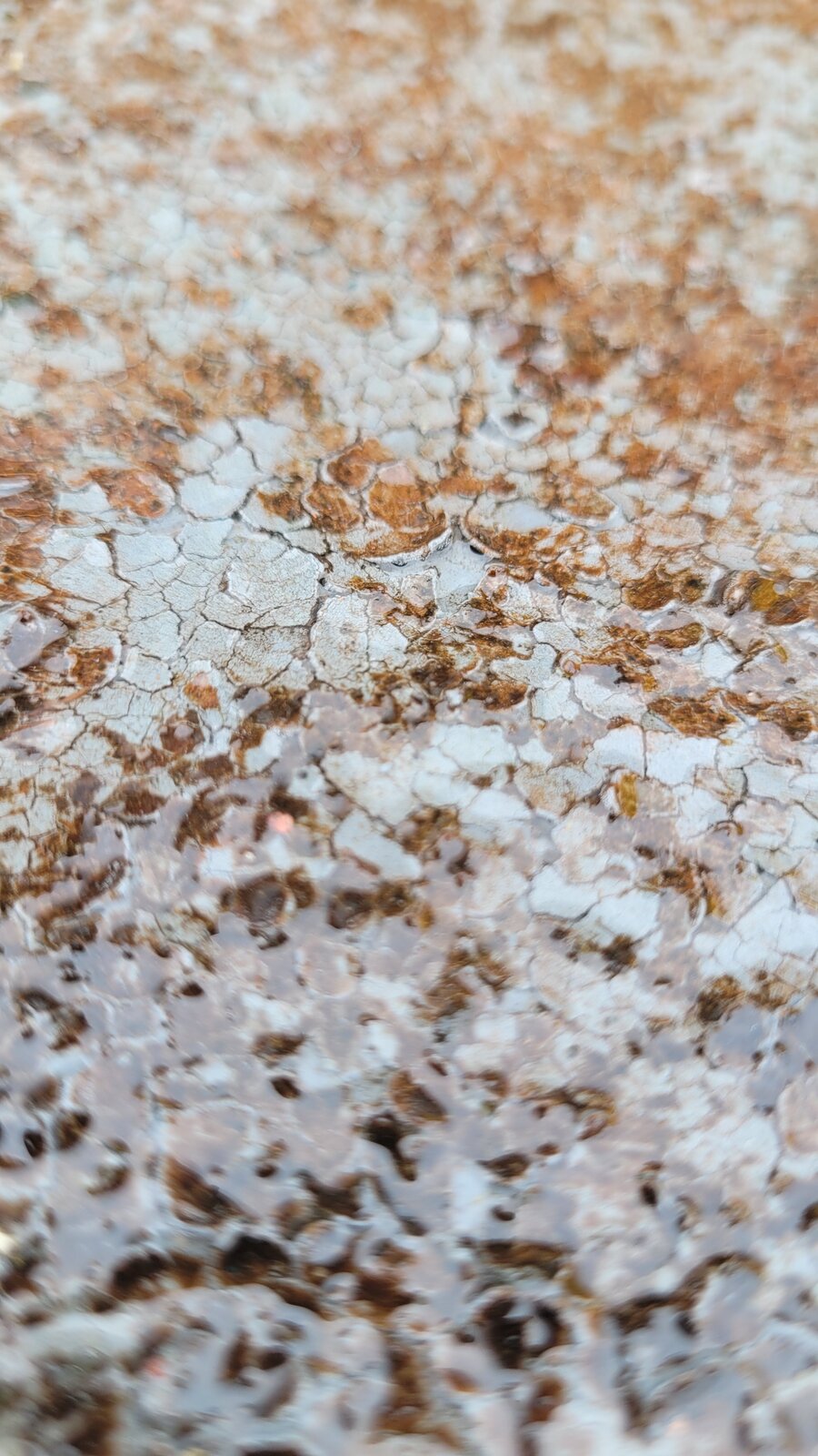

I had an extension done 5 yrs ago with a grp roof (Flexitec) and a couple of sky lights. It isn't leaking however it has always pooled just by the drip edge (not sure if that's the correct term) and was getting fairly filthy. I went up to clean it and realised that most of the surface has micro cracks in it, especially in the areas where there is pooling.
I've tried to contact the roofer and just get various excuses about why he hasn't turned up to check it out.
So I've got another recommended roofer to take a look and he said the top coat wasn't mixed correctly and the edges weren't rebated into the osb which is the main issue with the pooling. He also mentioned he wasn't too happy with the fall and thought it was on the limit which wasn't helping with the pooling and may be a reason for the dirty roof.
He said the options were, either clean, sand down, acetate(?) and cut edges out and refit properly, recoat. Or osb over existing roof with more drop and grp on this
Thoughts ? Any other options ?
Thanks in advance

Here are a few shots. I had a walk around on the roof and the fibreglass doesn't appear to a delaminated.
Thanks for the pics, It could be at the time when the roof was installed that they either applied the topcoat too thick or the main laminate was not sufficiently cured.
For roofs like this where the cracking is not contained to just one area we would use a flexible overlay system like the Overcoat roofing system or Fix-r which is totally DIYable if you want to tackle it yourself or sand the entire roof back and apply more Topcoat.
