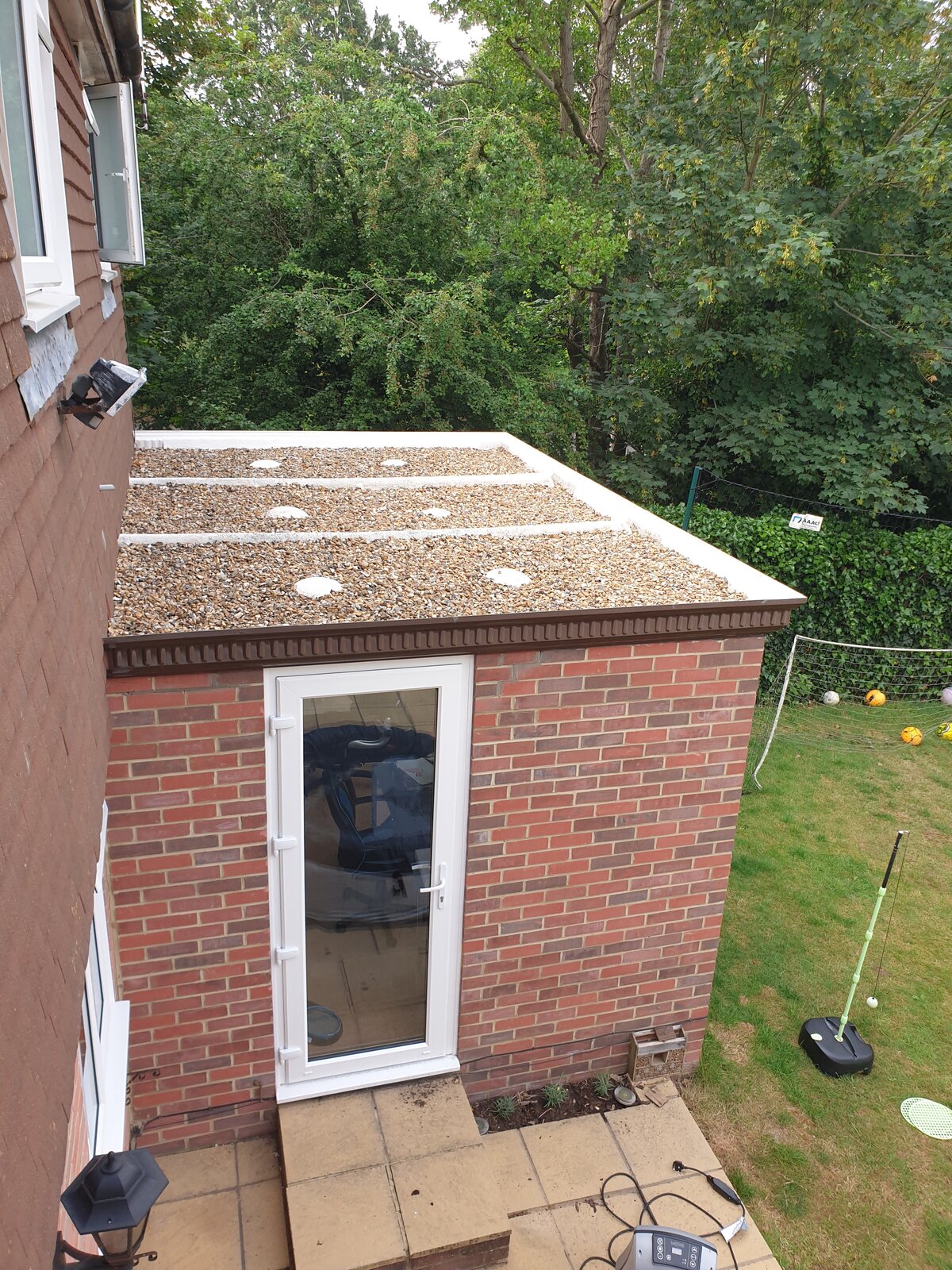

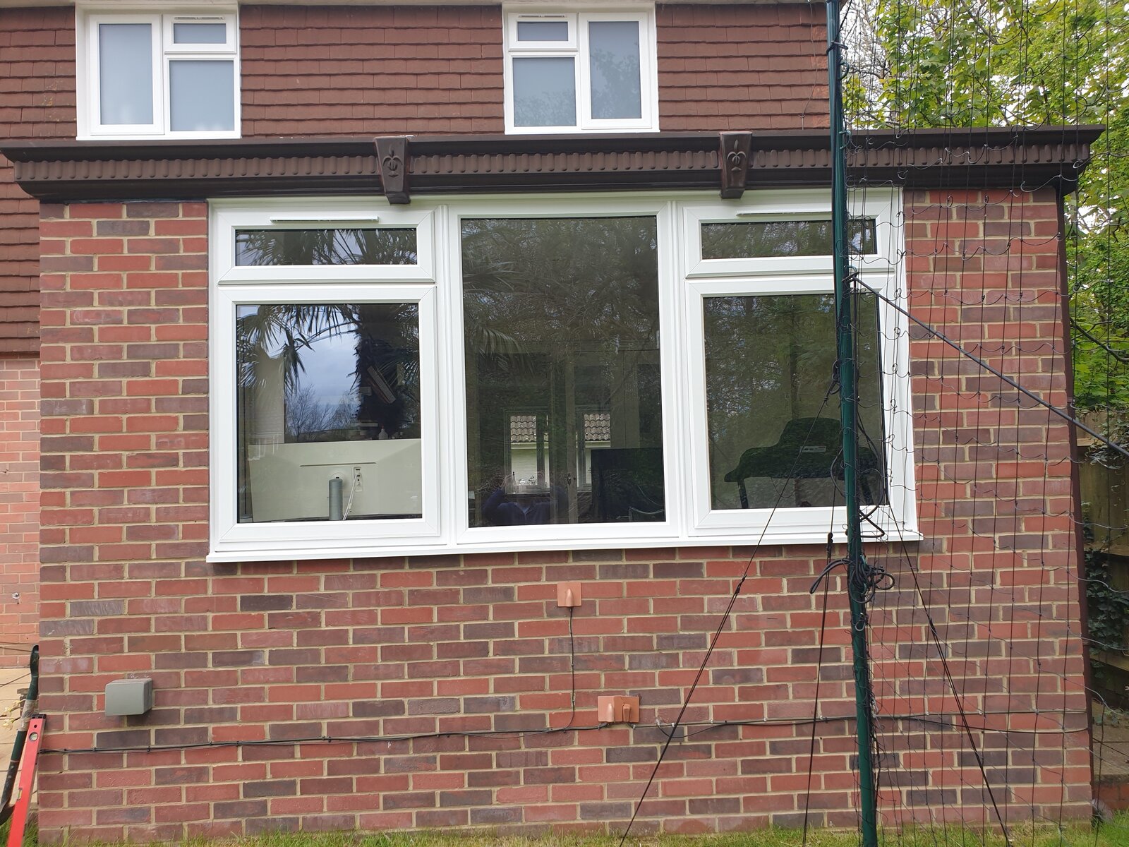

Yes correct they are below the roof see pics. Without doubt they are trying to get out of dealing with any damage caused.

The damage was caused by the roof dropping in the centre of the gap by 25mm when they took the window out because they did not put in any supports, especially given the amount of gravel on the roof.
Due to this the roof has lifted externally in the 2 front corners and also now when the roof heats up in the day cracks appear just below the ceiling line internally as the roof moves and then go away when it calls down.
They are saying building regs state there should be holding down straps which I presume they are implying would have stopped this issue, although my view is if they had done what they were supposed to then it would not have happened. However, if I can go back and say that buidling regs do not specify that the holding down straps HAVE to be in place and would only be required if there was not sufficient weight then it takes away one of the potential avenues that they can use.

Jezus! What's the roof built from? Scrap pallets and soggy chipboard?
If the roof dropped then it sounds like there is no lintel fitted, which is nothing to do with holding down straps, in theory the surveyor should try to ascertain whether a lintel is present or not during his survey but that's not always possible, the window fitters should proceed with care as to whether one is fitted, rather than just ripping the window out without a care in the world as to holding them to account that's easier said than done. You need to determine whether there is a lintel or not fitted. Presumably the joists run from the house wall to the wall above the window?
Good question, it is a bit of a strange roof. I believe it is just made of fibreglass and possibly upvc round the edges. It is fairly bulky and weighs a fair but.

Not sure if you can see from photo 2 but there is no wall above the window From what I could see when they took out the window there is no lintel and the roof in that part just sat on top of the old window. Regarding the joists I have no idea it hasn't been mentioned.

Looking at those pics it is hard to see where you'd put a wall plate never mind a lintel- not a lot of clearance between window top and roof top.Were the old windows timber?

Even if they had propped the ceiling before removing the old window you would (probably still are) in bother - standard upvc windows are not designed to support vertical loads. You would need a special in there- 3 windows with metal bay poles and jacks and some sort of spreader across the top.
The window in there before was also UPVC not sure whether the old one was one window or several. The window currently in place is 3 individual windows with 2 metal poles but not a spreader as far as I am aware.
I do not think the window is necessarily the problem now but more what has happened previously which has either caused any fixings to come loose or the integrity of the roof has been compromised so that now it moves more than it did previously.
