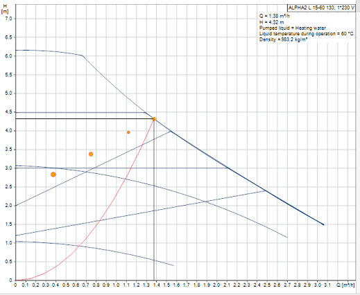

I put your numbers (1.5m³/hr;4.5m) into Grundfos calculator with the Alpha 2 L 15/60 specifically selected. This graph is the result:
.3
As you can see it shows the actual working point as 1.38m³ and 4.32m, on fixed speed 3. Does this mean, if you have selected PP2, the pump will automatically switch to a fixed speed if necessary, or is the graph telling you that you will need to use a fixed speed? The difference in flow rate is equivalent to a 10% increase in differential temperature.
The Grundfos sizing tool always tries to suggest the pump with the lowest Life Cycle cost. This takes into account the "wire to water" efficiency of the pump, which is at its maximum in the middle of the pump's working range. The efficiency of the pump, under the above conditions, is 36.1%; the maximum efficiency is about 50%.

The Alpha 2 with AutoAdapt is probably more appropriate for this scenario, as it adjusts within the band shown, although at 1m3/hr and 5m head, I'm not sure if it would automatically revert to fixed speed (probably not).

The Alpha2 15-60 is no longer listed; it has been superseded by the Alpha3 15-50/60. When I put in your parameters, 1m³/5m, it selected a point on speed 3, outside the Autoadapt range, 1.01m³/5.118m.
