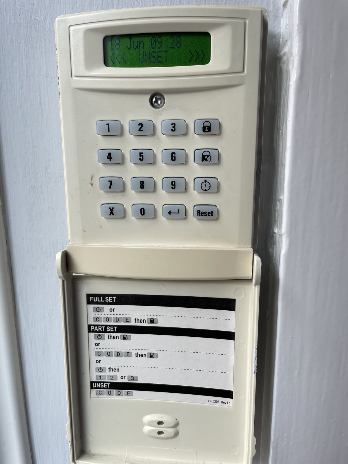

3 sim may not work as some gsm diallers only work with 2g networks.post photo of your alarm control panel keypad and control box,could help identify panel.

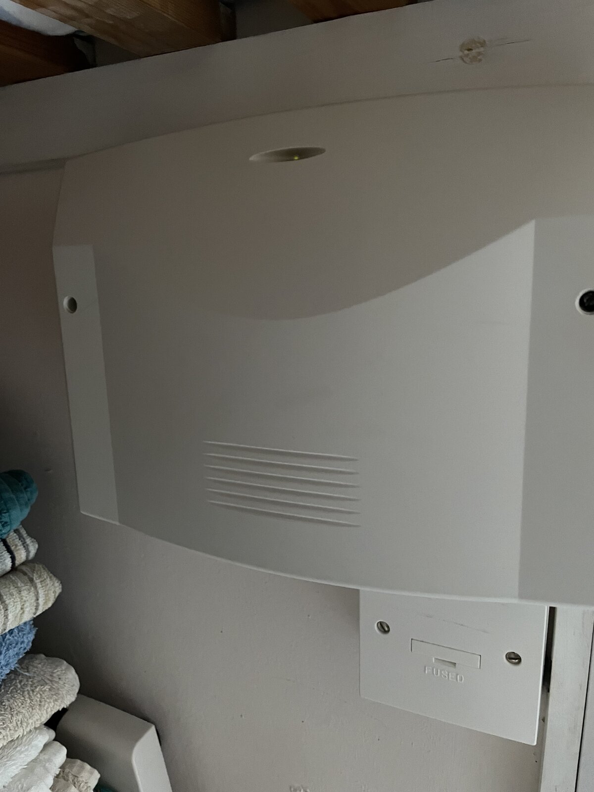

Will do but I still need to find the booklet as it has the engineers code in it so I can silence the alarm when I open the Control box for wiring.
Here is a couple of pics... Control box is approx 300mm x 150mm.. Thanks in advance.
Eurosec cpl8 discontinued…you can get a pay monthly sim for 3.95…your only tied in for 2 months at worst case and it’s unlimited calls and texts …

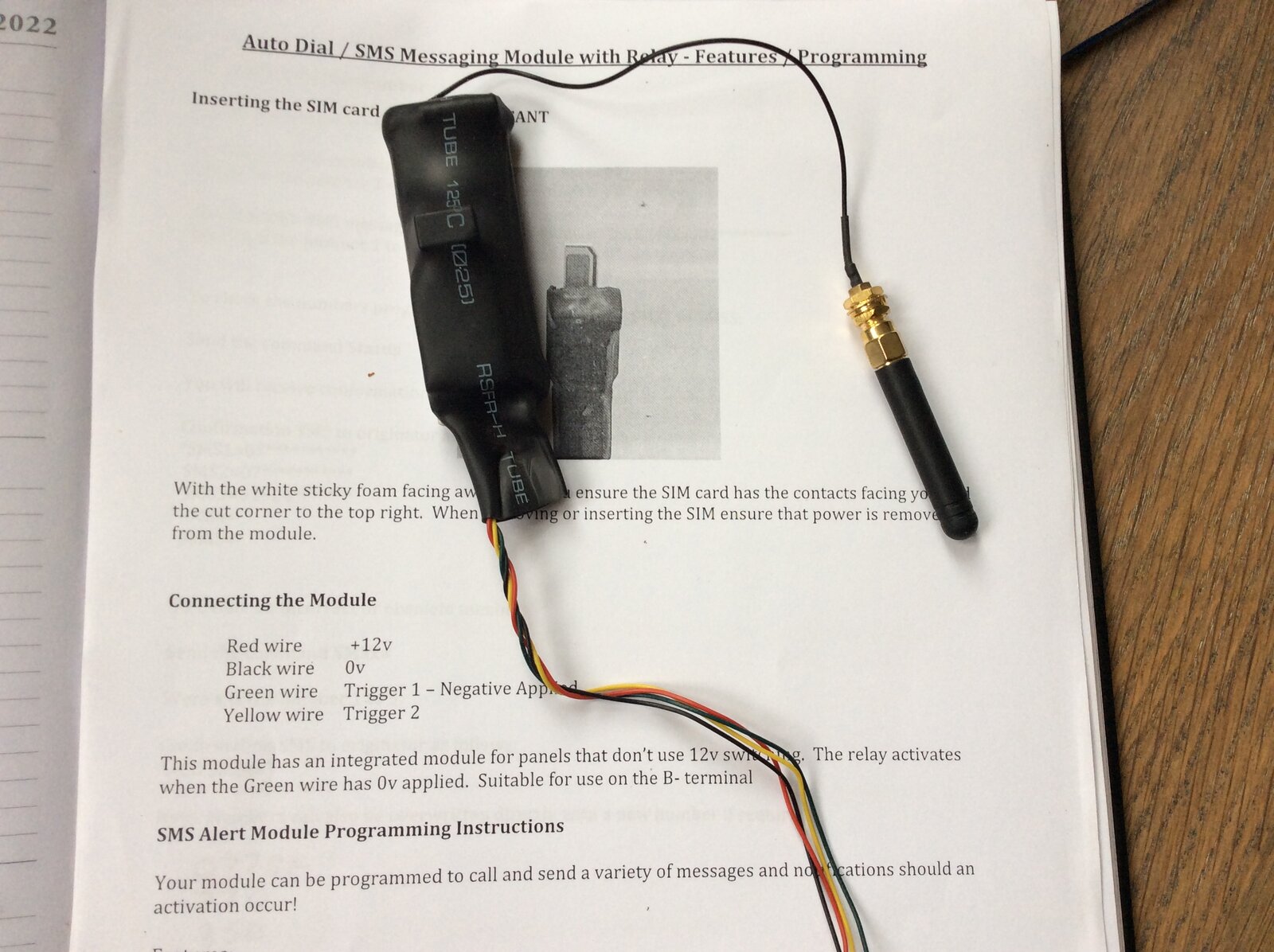

Dont know if still available but I have one of these from Electronic Alerts

The electronic alerts is cheap and it does work, very basic and doesn't have the same level of functionality however as you you don't a load of outputs to use the Electronic alerts may be suitable.
The GJD710 will not work on 3 (there is a special order unit that would if I recall rightly but not off the shelf), same with the Electrionic alerts I believe.
