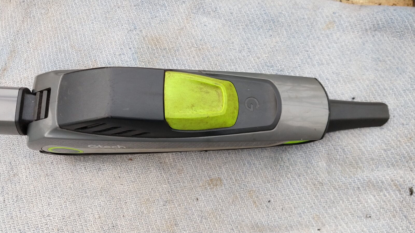

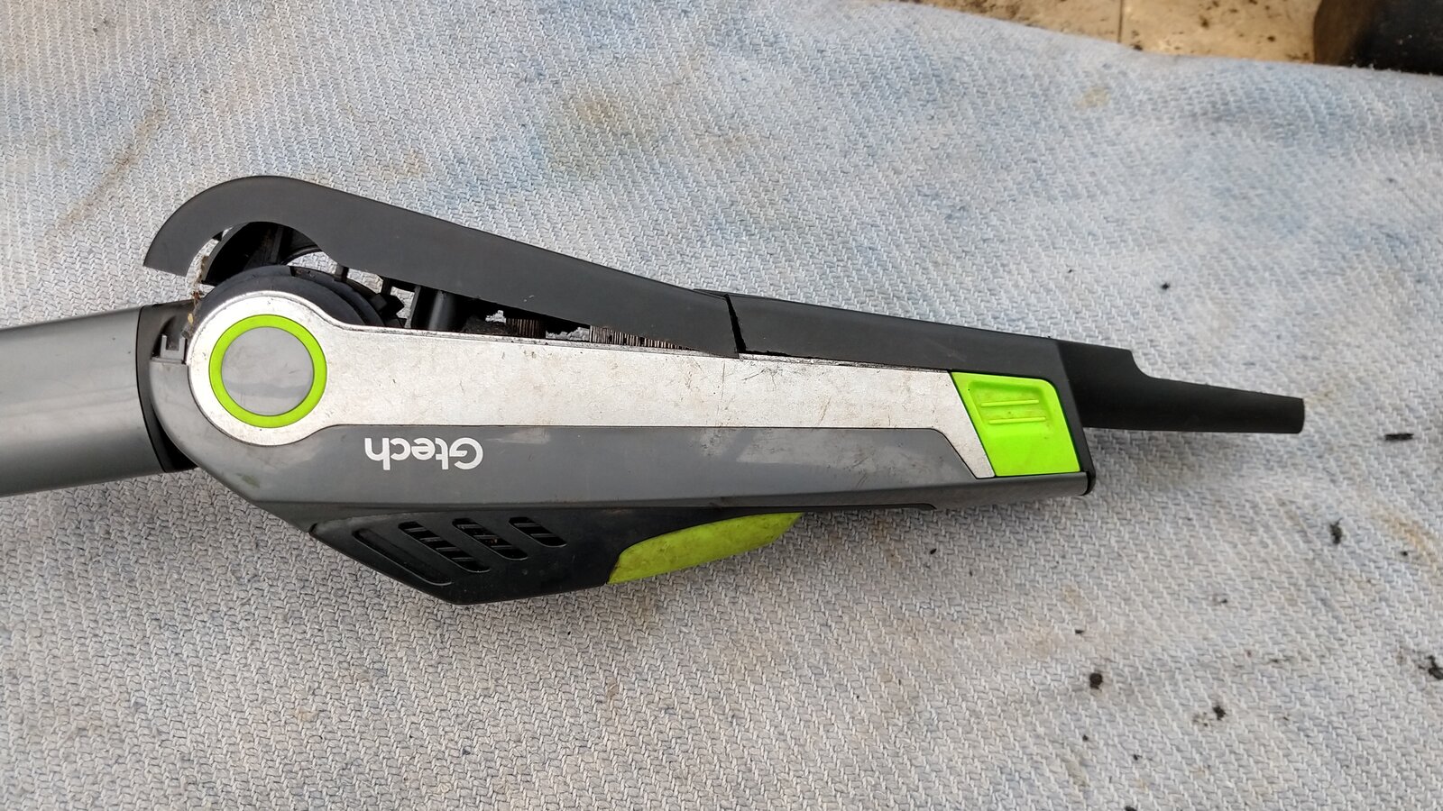

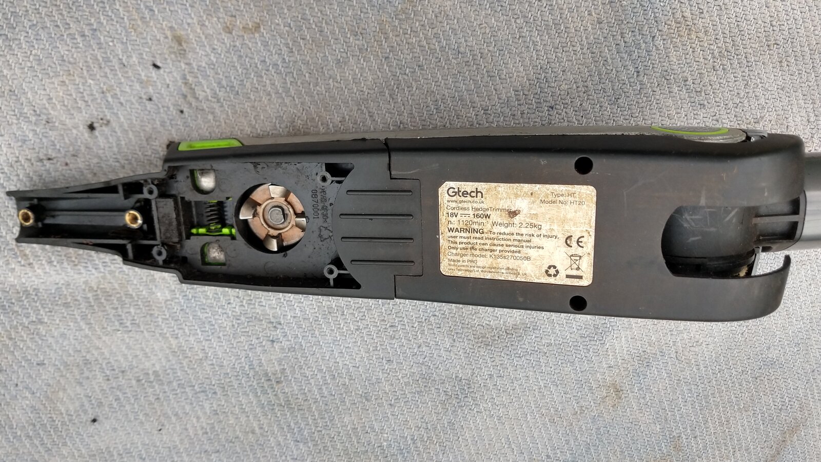

I have a Gtech HT20 which immediately jams as soon as it is used to try to trim anything. I've looked at the blades and nothing seems wrong and they will move ok when not trimming
I've tried taking it apart to look at the belts, I've removed all the torx screws on the bottom, but am having a job getting the bottom cover off (I've already broken a tab trying to get it off).
Am I missing something or do I just need to use more force?
See pics attached.
Thanks in advance for any help

Squeezing in at both sides the very obvious bright green latch at the front you take off the blade section which then uncovers the four other torx screws underneath removing the underneath section. Six plastic tabs can then be eased with a screwdriver, popping the top off and giving access to the two drive belts.
The larger drive belt has a 2cm section where the teeth had totally worn off, so I've bought a replacement online
Thanks again for the replies guys
