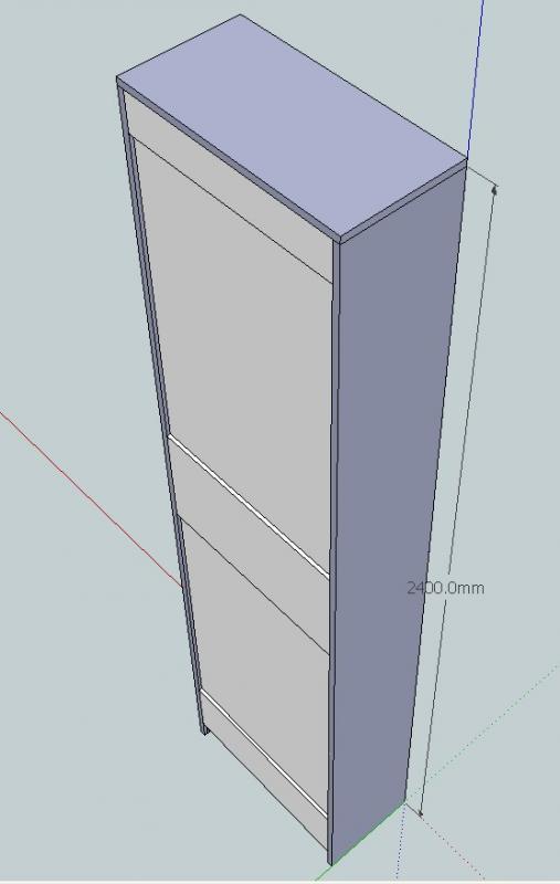

Hi All,
I am looking to build a floor to ceiling built in bookcase to create a study room.
I want it to be floor to ceiling along the entire length of one wall. There are two posts, one in each corner of the room on that wall - so looking to build it into that recess if that makes sense.
The wall is plasterboard on metal studs (new build property).
I am not sure which path to take. Do I do very long shelves on battens with spring toggles behind the plasterboard - would this support (plasterboard is 15mm thick). Do I build a frame type thing similar in the way that stud walls are created.
Please can people offer suggestions, tips, tricks and advice to give me a starting point?
Many thanks in advance.
BrennaBoy.

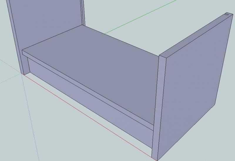

For a less experienced woodworker I'd consider making-up shelf unit frames with thin backs in grooves or rebates. The basic shell comprises two full height sides, a front plinth and a bottom shelf screwed together using black passivated carcass screws and PVA glue. This is fundamentally the same type of structure that IKEA use in their bookcases - but this one you can make to any size you see fit. The bottom looks like this to start with:
and ends-up like this when completed (before the shelves are fitted):
Note the bracing pieces across the back at top, bottom and middle to add rigidity and to stop the back being punched out too readily.
The shelves are held on planted-on shelving strips (which require the shelf ends to be notched-out) or on tags held by flush-fitted Tonk strips (routed and fitted into grooves before assembly). The width of each unit is determined by the load of the shelves. The depth would need to be constant, but 300mm should suffice for mots purposes. To calculate the sag of the shelves when loaded an on-line calculator called The Sagulator can be used
Multiple units like this can be built and screwed together using kitchen carcass joiners. Start at one end and level up as you go. The top can be made fancier by adding a bought-in cornice moulding, as you'd have on a kitchen. Similarly a built-out skirting could be fitted to the bottom like a "shoe" moulding instead ofthe inset plinth I illustrate
Maximum height will be about 2458mm (2440mm sheet length + 18mm for the top based on using 18mm MDF/plywood/MFC/MF-MDF) unless you opt for a separate plinth structure. Note that with a pre-built carcass such as this you will need to make the carcass 50 to 100mm shorter than the ceiling height in order to be able to lift it into position. The cornice or an MDF bulkhead painted the same colour as the walls can be used to disguise this
Note that these are rough concept drawings and don't show details such as the Tonk strips, loose shelves, etc
