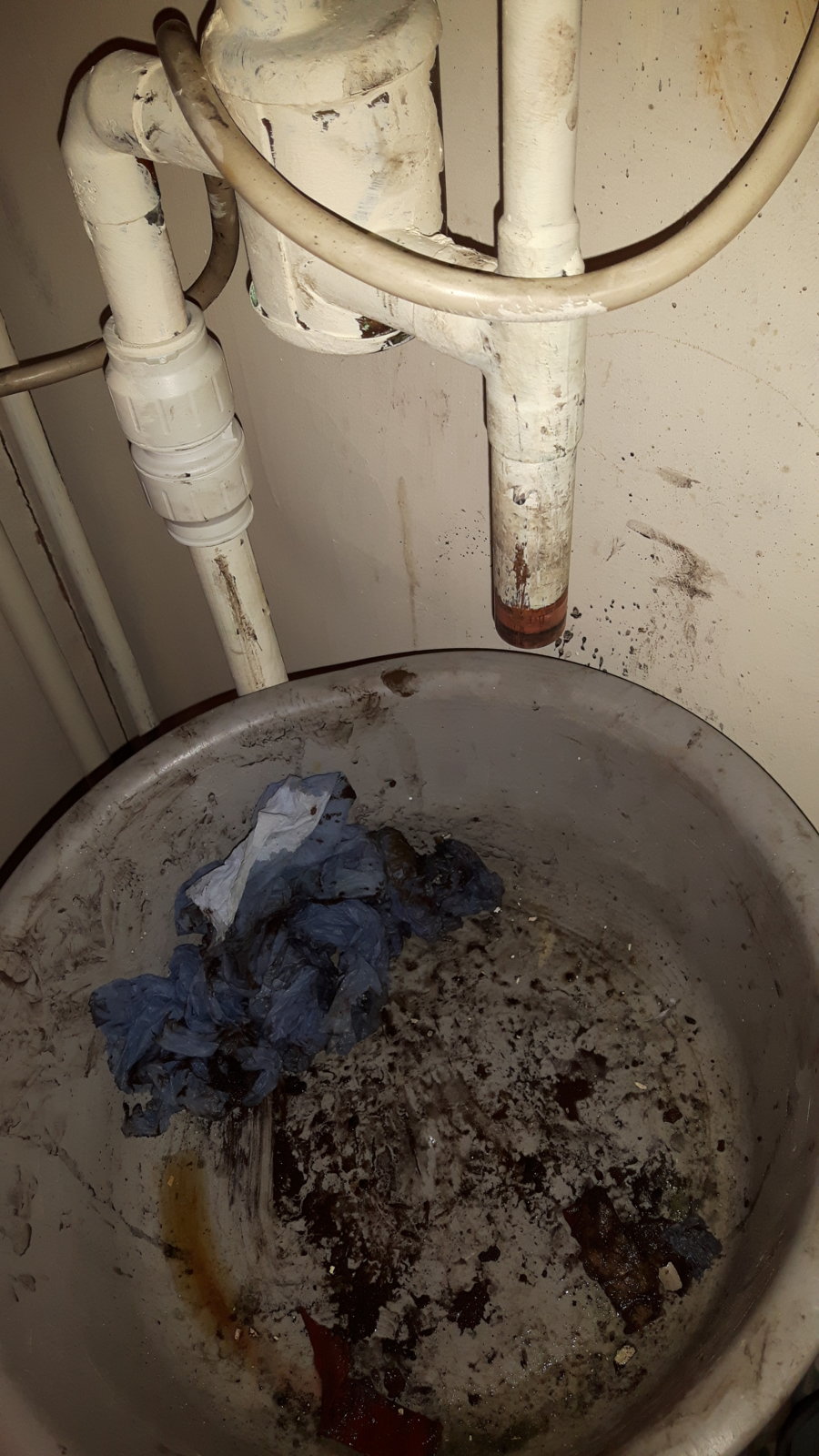

Evening all,
I've recently cleaned my F&E, microbore central heating system using Sentinel X400 and this led to the cold rads heating up again, so a success in that respect. Now, after a week of the X400 circulating, today I cleaned the F&E tank again (much cleaner water), drained down the system, refilled it and drained it again to flush it all out. The water that came out was pretty clear.
However, when I removed the existing pump to replace it, a lot of gunk is still coming out of the pipes (see pic attached). So now i'm unsure about whether or not to replace the pump as I don't want to clog up the new one. I'm hoping someone could kindly offer some wisdom on the following points:
1. I only used 1L of X400 for a system of 12 rads. Was this too little?
2. Should I refit the old pump and run some more/different cleaner through the system before draining down and flushing it again, before fitting the new pump?
or
3. Should I try to clean out the pipes near the rads as best as possible using some thick wire (e.g. twin and Earth) and fit the pump anyway?
Any suggestions are greatly appreciated!

I don’t know how you did it but when I used x400 to give my system a flush, I had the pump on max speed and went round closing off rad valves so that the max flow was going through just one rad at a time but that was only after I had removed and physically flushed each rad individually until they ran clear. You might need another dose.

Motman's method is logically the better way, pumping through one rad at a time. If it's really bad, flush out several times. My system is 35+ years old, has had inhibitor in constantly since new, during which time it is on its now third boiler, second pump (unnecessary). Last time around, I decided to replace the galv F&E tank with a new plastic one. Each time it had a new boiler, I simply gave it a good flush through with plain water, after using full speed pump, one rad at a time. Very little came out of it and none during the most recent boiler swap. Last time (March 2018), I added a magnetic filter, which I have cleaned out four times since then, the amount it is collecting is negligible. I gave the system a check over and service last week and nothing at all came out of the filter, clean as a whistle.
What you have not explained is why you intend fitting a new pump - is it noisy, leaking?
If neither, then leave the old one in place until it needs to be swapped. Just keep its replacement to hand if you already have it. If the filter is collecting a lot, then clean it often.

X400 loosens the dirt. Draining will get some of it out (never all of it)
If you can afford £100 or so more, you can add a system filter such as a Magnaclean, which will eventually trap whatever remaining dirt is still circulating, before it has time to settle into sediment and new blockages.
You'll find, if you empty the filter regularly, that it captures quite a lot at first, and then over time the amount reduces, as there is less and less remaining in the system.
Without adding a cleaner such as X400, a lot of the dirt will just sit in the system. Plain water flush will only remove some of the loose stuff.
Pull the pump to bits - The impeller is probably full of little balls of crud that rattle around when the pump is on... Make sure you clean out the flutes in the impeller too....

Well I spent ages cleaning the pump yesterday and when I re-fitted it, it kept tripping the RCD, so massive DIY success from me there! I think I probably got some of the electrics wet, like an idiot.
In a calculated, prolonged fit of rage, I went ahead and fitted the new pump which annoyed me further because the direction of the flow on the pump meant that I had to install it upside down (i.e. the writing on the label is upside down), although from my research, this shouldn't be a problem. I also bailed out the F&E tank, drained down and flushed the system, and then added two litres of X400 upon re-filling.
The heating now works perfectly and the pump is quiet, for the time being. I'll keep it running for a few hours each morning and evening and use a rubber mallet to gently tap the rads and any exposed pipework and clean the filter (it's an Intaklean 2) twice a day, for the next few weeks, before draining and flushing the system again. I'll let you know about my results. Thanks to you all for your time again.
