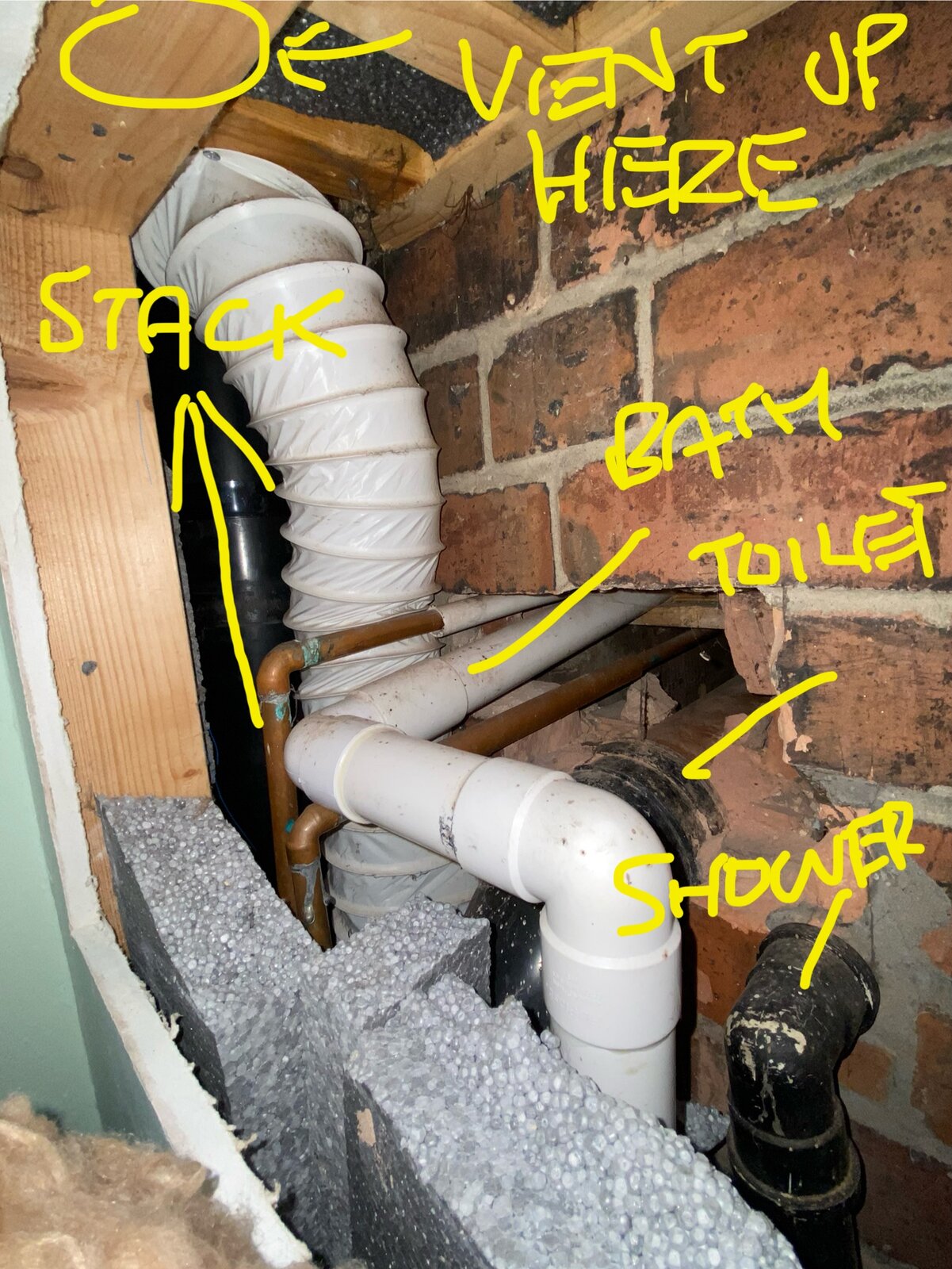

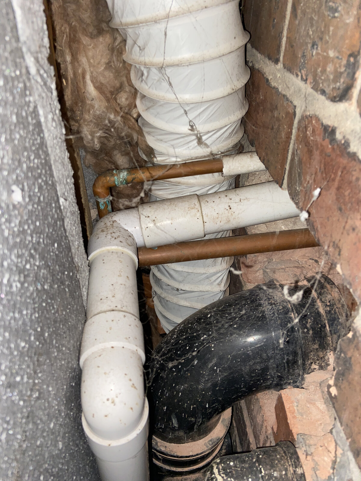

I have some pictures. In the corner of the kitchen is some boxing in to hide the stack, so I cut out a section at the top and took some pictures looking inside. The black 4" pipe coming out of the wall is of course from the toilet, which sits directly to the other side of the wall. The white solvent weld piping is from the bath. The flexi-piping in the background may just be from an extractor fan which is below the bathroom, and this runs straight up into the ground floor extension roof space (where there is a vent in the tiles). There's also an unidentified item in clay-coloured plastic (a valve?), which can be seen behind the flexi-pipe and also up-close.
I appreciate they're not the best pictures, but they're the best I could do with the available space. I think/hope, that the clay-coloured pipe is indeed the valve and that waste water goes down beyond this, below the valve.
The whole setup looks - in the words of the local youth - 'rate dodge'. I can't fathom how I'd go about sorting this, but I do want to DIY it. Partly because I want to learn and mainly because life is a constant financial drain.
Really appreciate any input!

You need to follow the stack up, to the very top, which is where you will find the AAV. Then find out why the AAV is not opening, when there is a vacuum within the stack, it doesn't take much, to make them stick. Chances are, the AAV is in your loft.
Thanks, yes it all seems to sound like a vacuum. The stack actually terminates at a level somewhere below the bathroom window sill, in a ground floor extension roof space. In the past it used to run up the back of the house to the roof, but was reduced in height to avoid having to tile around it.

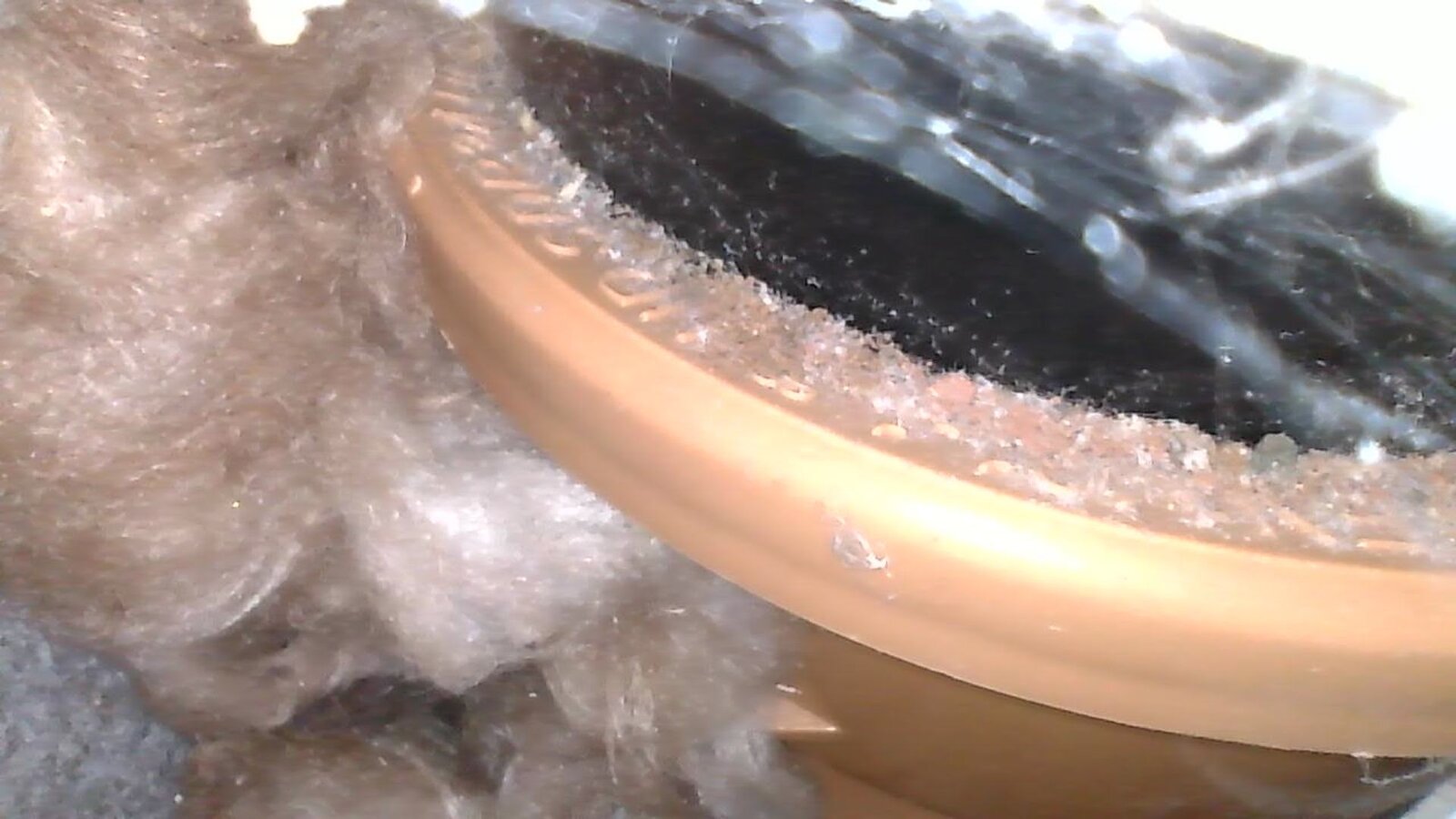

I’m wondering if it’s the item I’ve pictured, and hoped it might look familiar to somebody.
Okay I’ve located the AAV. As per the attached, it’s on the top of a stack which runs behind all the visible plumbing. This then goes into the roof void. To change the valve, it means getting onto the roof and lifting the flashing and slate.
To avoid doing this, would a 40mm AAV (installed in-line on 40mm pipe from the bath/sink/shower) allow enough air in? It would be below the ‘flood line’ but I have read this is okay with class A AAVs. Unsure on whether this would work as I don’t know how high these AAVs have to be.
The roof is being re-slated in a few years so the 110mm stack AAV could be changed then. This would be to get us by until then.
