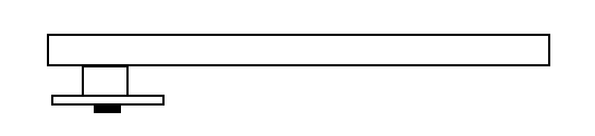

You could Mcgyver a tool from a 15cm or so length of wood with a large washer and spacer screwed/bolted onto it, like this :-
Alternatively, bash the end of a length of steel strip into a "u" shape.
Put tool over the top lip of the clip and gently lever downwards to raise the lip.
