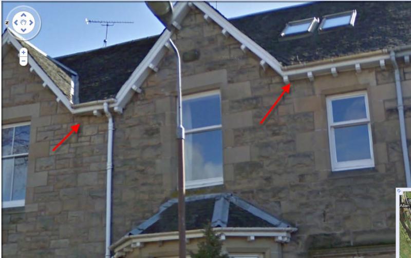

I was wondering what people thought of this situation. The front of my house has the normal setup of gutters and eaves. I have noticed that I'm getting wet marks at 2 points after it rains. It seems to be damaging the underside of the eaves as you can see where paint is flaking when you stand under it.
I have attached a photo so you can see both points.

Hopefully you can see from the left hand leak in the image just how close the wet mark starts from the eave - if the water was coming out the gutter could it mark this far up?

It might be a gutter issue, but I personally expect its rain running over the edge of the lead valley lining at the bottom of the valley.
It is a little hard to tell from the pic exactly how it has been detailed . but I have a feeling this is the problem.
Or I guess, it could be a split in the lead further up the valley, the rain could run down the underlay and into the soffit /eaves area.
I would expect the underlay had rotted at fascia level by now

I'd tend to agree daterable , likely to be a split at least on the left hand valley. On the right it looks "untidy" which may be a problem with the slates but is probably a trick of the light in the photo'. The gutters themselves look pretty sound so I don't think the problem lies there and yes cast iron would be the most expensive option.

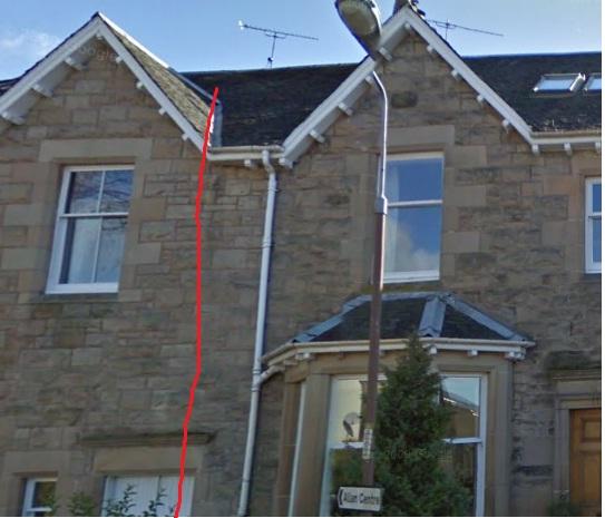

Hmm, if it's the valley that becomes tricky - the issue is right on the join between my and my neighbours property, as shown in the image below. On the left is my neighbours, on the right is my property.
If fixing a leak in a valley is straight forward and cheap I'll save the trouble of arguing who should be paying for it, but if it's a big job, I'll need to approach my neighbour. Relationship is good but when I mentioned there was an issue in passing he said that gutter was my responsibility, which is right, but it changes things if it's not the gutter, doesn't it? Or does it?

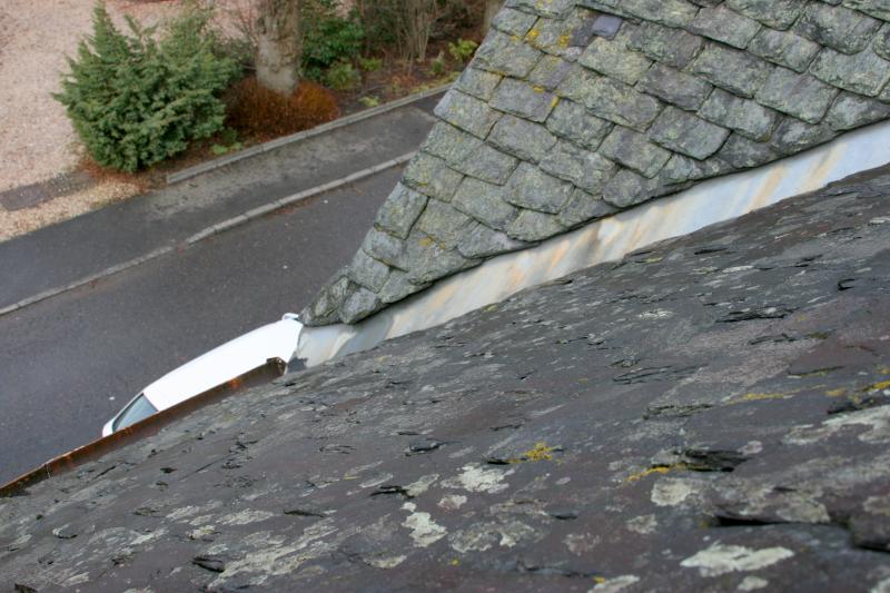

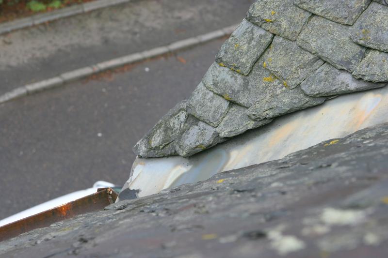

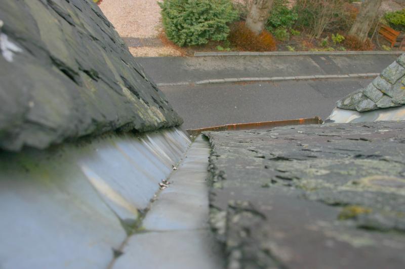

I have take the photos from the Velux windows. Not sure how useful they will be as I can't get a view of my neighbours valley, which is the side the leak is on.
So, from the Velux above the leak which is on the left hand side of the original photo with the red arrows:
The valley shown there is on my side, which is the opposite side to the leak.

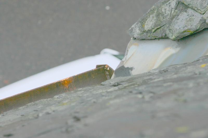

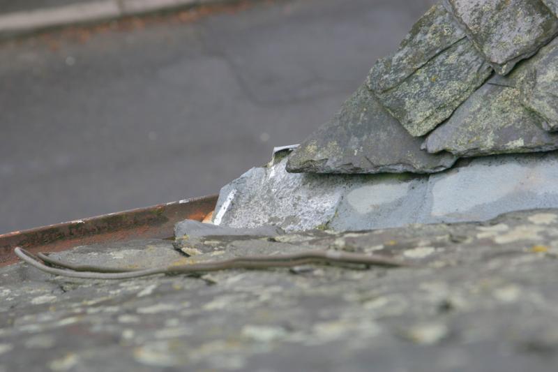

As for the leak on the right hand side of original image, here is a couple of shots of the corner of guttering

Your guttering may leak but that is not what is causing you your problem, when half round 100mm gutter leaks through a join it will leak out at its lowest point which in your case is the middle of the gutter and it will drip free.
Your markings on the wall are due to water ingress somewhere further up your valley and running down the boards to eaves level, causing water to come into the soffit and travel along to where it meets the brickwork and then come out onto the bricks.
In the first picture taken from the Velux there is a slate broken and a small slither has been slipped in in its place (12th course up) this could be a leak point it could then run down the rafter or board wetting the wall a little. Also there are a couple of others sliping reducing headlaps...
This said, It is more likely to be the valley.

Zooming in on your very last picture, it does look like the bottom section of the lead in the valley has been previously patched, to no avail by the looks of things.
Definitely time for new lead in the valley /s, and to fix the slipping slates whilst they're at it before they land on something or someone!
Need to sort with your neighbour as it looks as though the valley in question is his property? Scaffold will be required.

Not sure if my post with the photos was clear - the first row of photos are for the leak which is between me and my neighbours.
The second row of photos (the last 2) are of the guttering below the 2 Velux windows shown in the very first photo in the thread.
This leak only really started after some bad weather a couple of weeks ago.
The bad leak, on the left of the original photo, is shown by the top row of photos.
