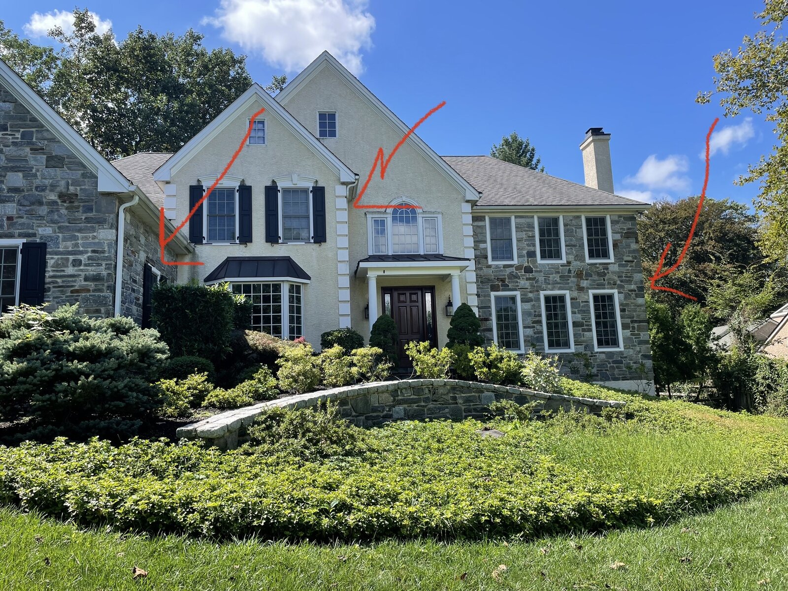

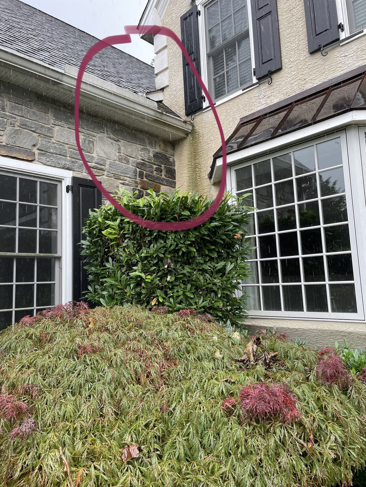

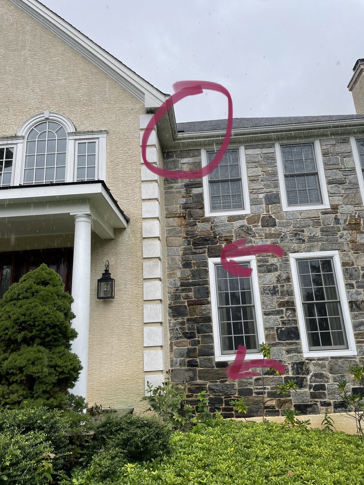

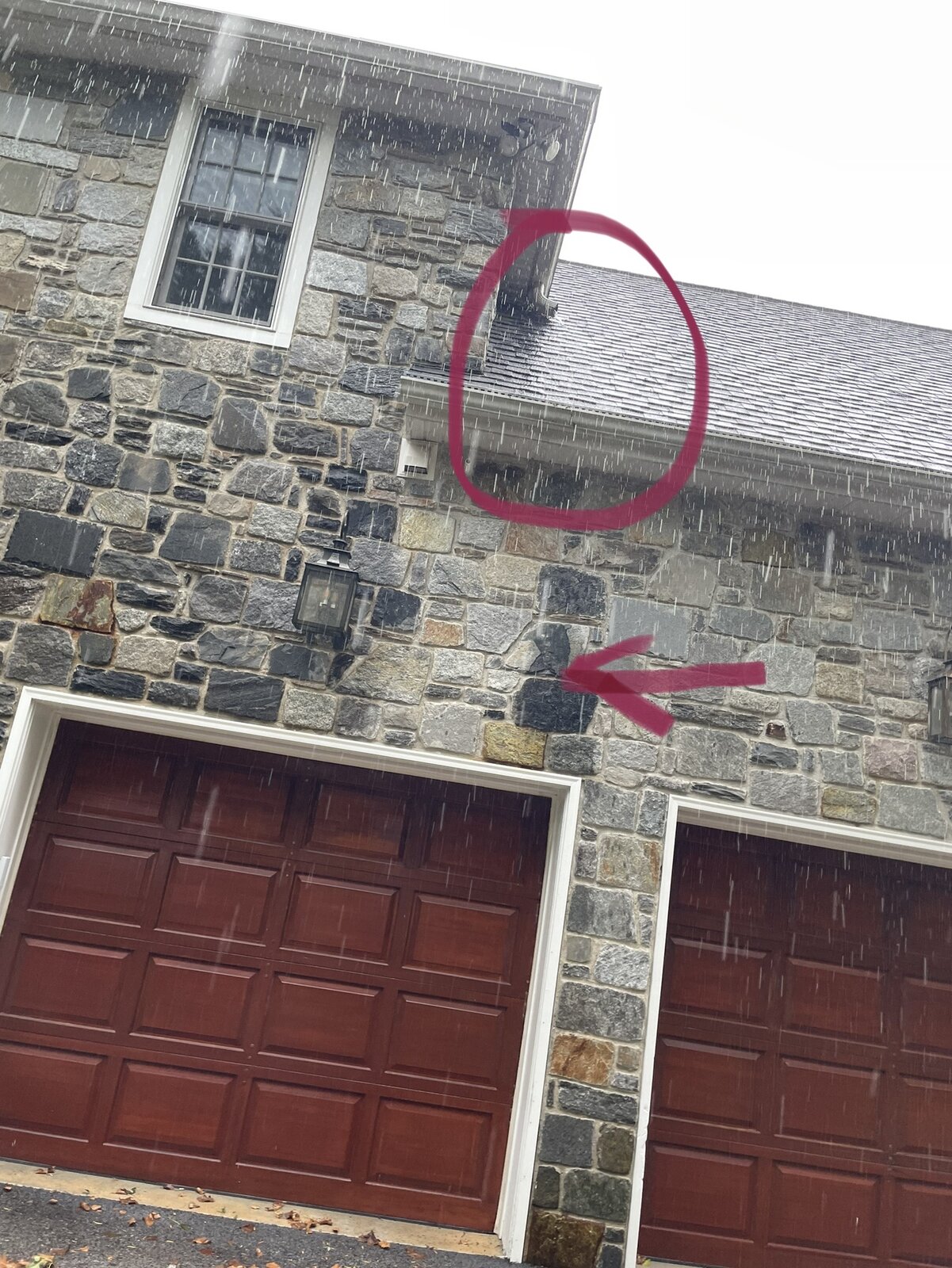

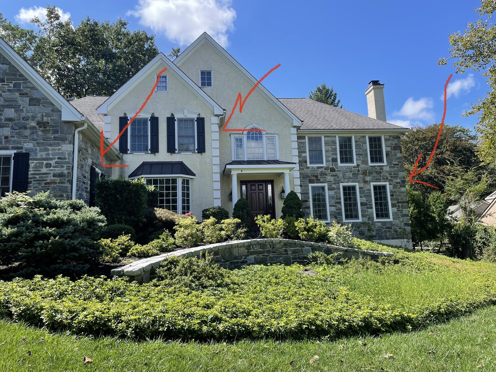

There are a few sections of my gutter that are not properly controlling water flow. I have one area (pic 1) that the water is overflowing the gutter. This section of gutter is larger than the rest and do not have gutter guards so previously someone tried to address the issue but did not succeed. The next two spots the water seems to be jumping the gutter with heavy rain. What would be your first step to address these issues?

Your photos do not show the downpipes. Stand back and show us where they are.
Further to John's questions is the rain overshooting the gutters or are the gutters full and overflowing? If you're not sure, you'll have to get up and have a look maybe when the problem is occurring, unless you fit a phone to a long stick and take a video, or a drone maybe.
Here is a picture showing where the downspouts are. While I plan to send someone up to check the gutters, I think the water issues are present even with clean gutters and there are pieces of metal sticking up in the problem spots to contain the water in the gutter. Definitely in the first picture the water was overflowing but in the last 2 pictures I couldn’t see exactly but the water was coming off differently than the first. The water was only coming off in the direct path of the water rather than along the side of the gutter like the first picture.

I don't think your gutters have enough fall (slope) on them.
This was all built at the same time. Do you think additional downspouts would help?
Your point about fall is valid too bc the gutter in the first picture was overflowing on the opposite side of where the downspout is.
In your first and third pictures, the gutter may flow better if they are tilted more to run towards the outlet. In your second picture the design is poor and I think it needs an extra outlet in the corner.
