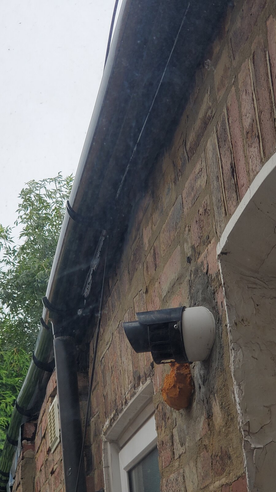

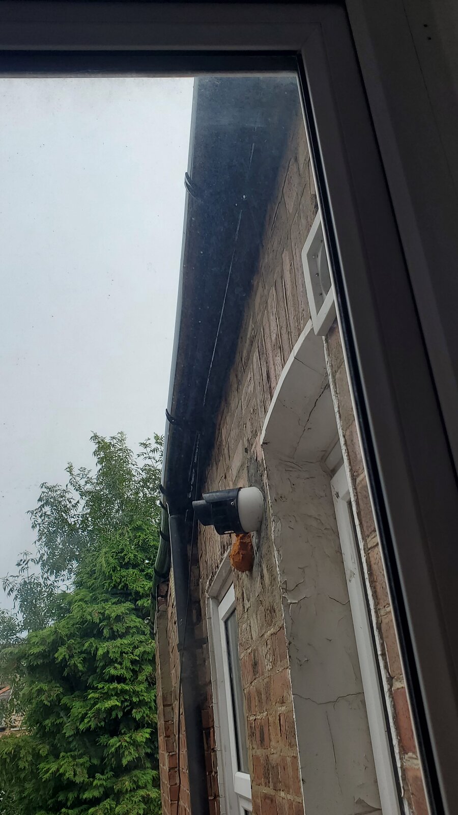

Clear daylight can be seen between the gutter & the fascia - thats one thing that might be wrong?
Perhaps the felt is stopping too short of the gutter - perhaps Eaves Protector felt support trays are needed?

Thanks looked to me like water was coming out of the bottom of the gutter and also (last video) drips through the joint to next section. That's why I thought must be failing. There's less of a gap/visible light for the section nearer than further a long

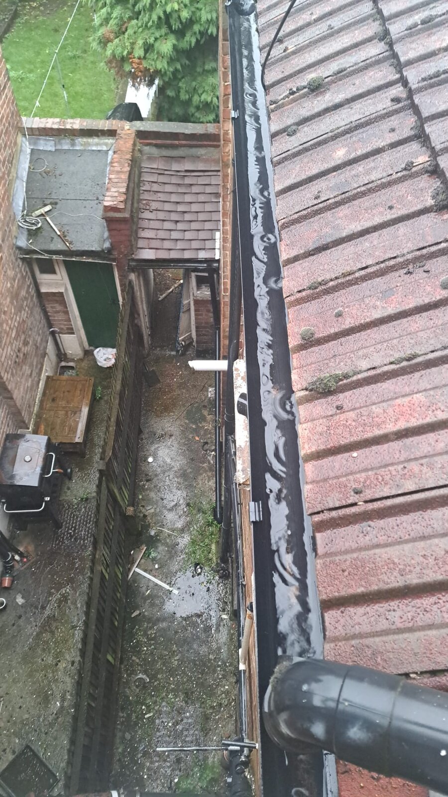

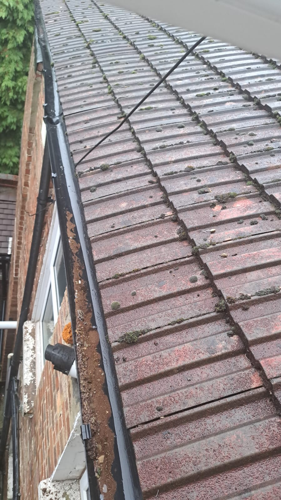

Managed to get photos from window above various cr*p haf accumulated fortunately was able to clear using a docapole and gutter clearing attachment

There also looks to be too few brackets, allowing it to sag and distort on the longer unsupported sections. In my experience builders always use far too few brackets to support plastic gutters - they really need brackets at half meter intervals to keep the gutter properly supported and avoid sags and distortion.
Thanks installed by a roofer that's worth knowing anyway tho. Thank you for the advice
