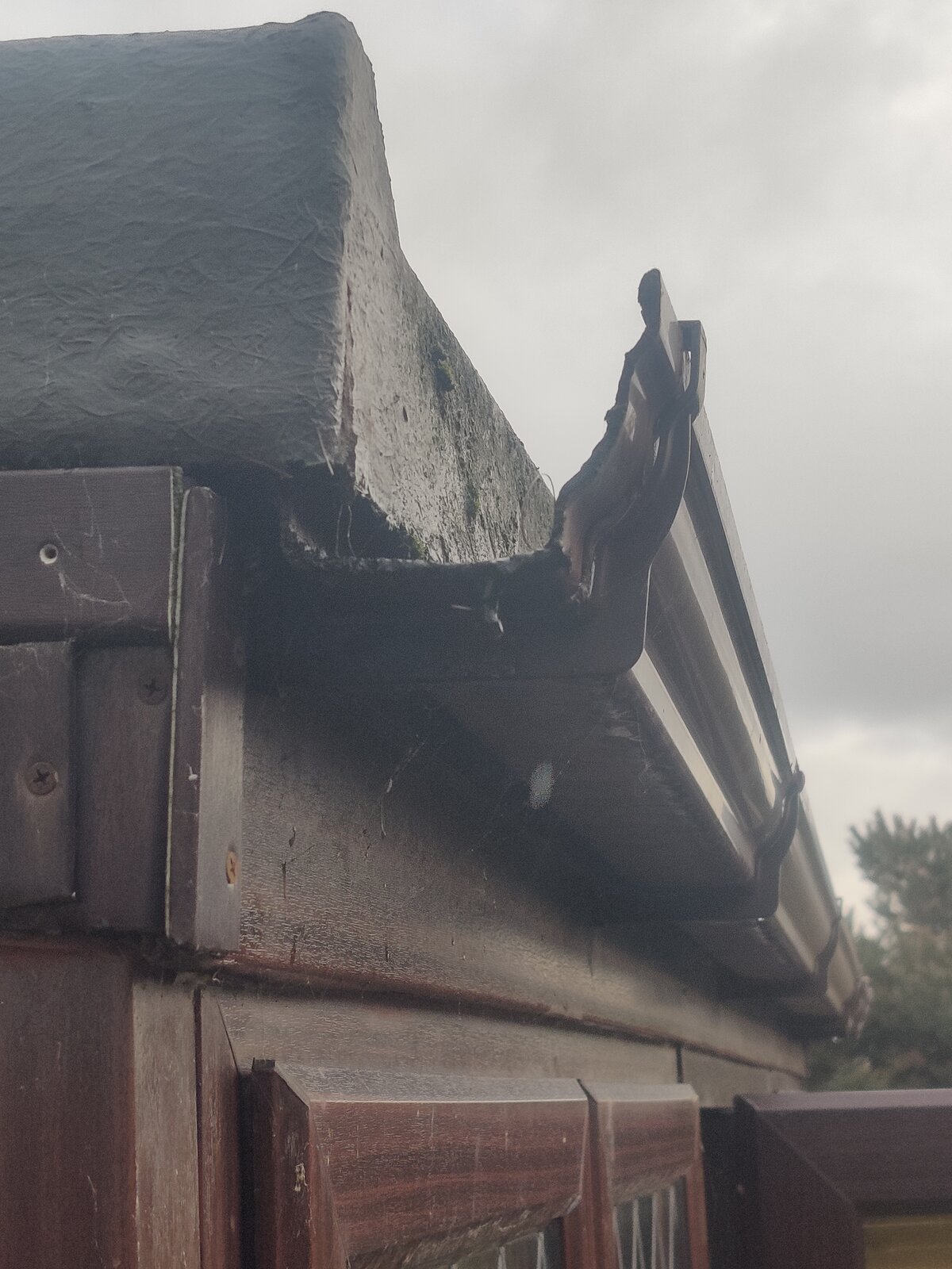

I have an end stop missing from my guttering but the flashing is preventing me fitting a replacement (see picture). What is the best way to fit a new end stop?
thanks in advance
Nick
Gutter is tucked under too far.
Don't matter though.
Cut an end fitting so it fits the inside profile.
Cut out so it fits around the roof and slots in.
Use a brown polymer grab to stick in place and seal.
Be ok.
That's how id do it.
