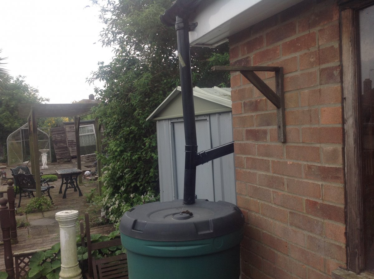

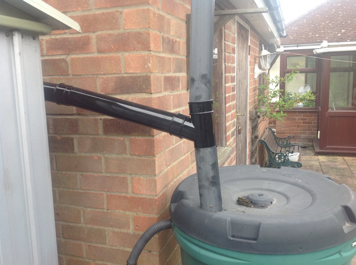

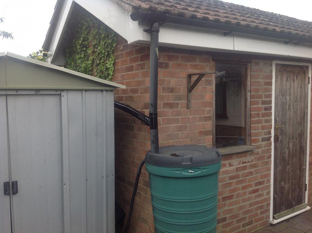

hi,
recently had a new gutter put up on one side of my garage - this connected into a pipe that fed into a water butt.
i've attached photos.
would you accept this as a competent job ?
it looks bad to me, but i have no experience on the difficulties of putting up guttering. for all i know this might be acceptable to some.
the contractor said it didn't look pretty; but did the job.
this guy wants to come around next week to work on my roof.
i'm hesitant based on what i've seen so far.
the property i'm living in has suffered from cowboys in the past with previous owners; i don't want to repeat history.
would appreciate your thoughts on this. should i let him loose on my roof ? he's got 95%+ positive ratings on one of these trade sites.

Wonky pipes, no leaf trap.

Who suggested it should run into a water butt ??
A couple "off set" elbows or moving the water butt would have made it look neater.

Try turning the lid, and see if that straightens the pipework up. But I'd be inclined to find someone recommended by a neighbour next time - now tell us he was.
Actually, I've just looked at the pictures again, and that won't work due to the other pipework coming in from the side. That should have been brought in at a lower angle, and that would have adjusted things better. I think it can be improved, but you'd need a new pice of 2.5m pipe, and you shouldn't have to do that.
thanks for the feedback. looks like i'll have to get someone else in to fix this.
At £300, I'd call him back in and tell him you want it done properly. You can cost the materials out yourself, and then work out what his labout charge was. There are those on here that will say that a jobs whatever a person charges for it, and if it's done properly, then that's a fair comment; but this one hasn't been, and and £250 for an hours work should be reported to trading standards. If he'd charged a days rate for an hours job, then you might forgive him, but I'd tell him that if he want's any more work from you, then it needs to be redone so you can have confidence in him..
If he won't play ball, or he wants the other work as well, then report him, and wait for the next worker you get in to redo it; they'll just add maybe half an hours work to their bill.
