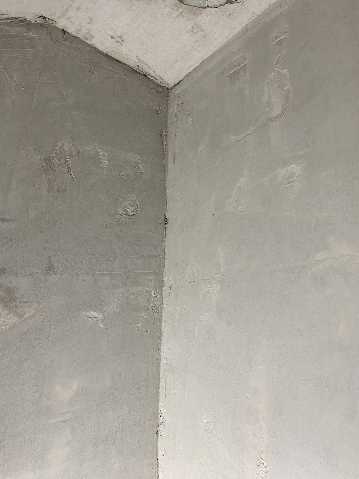

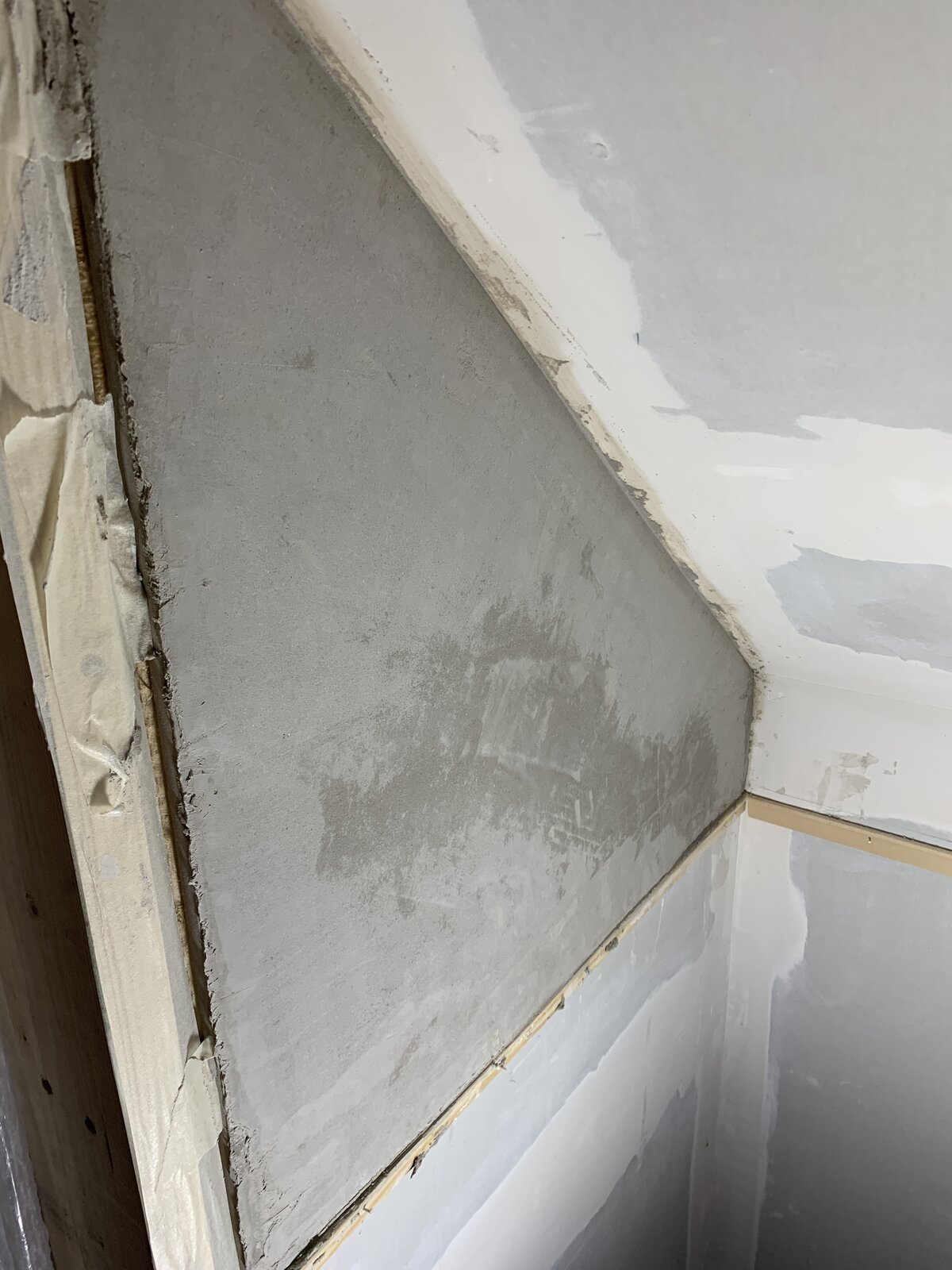

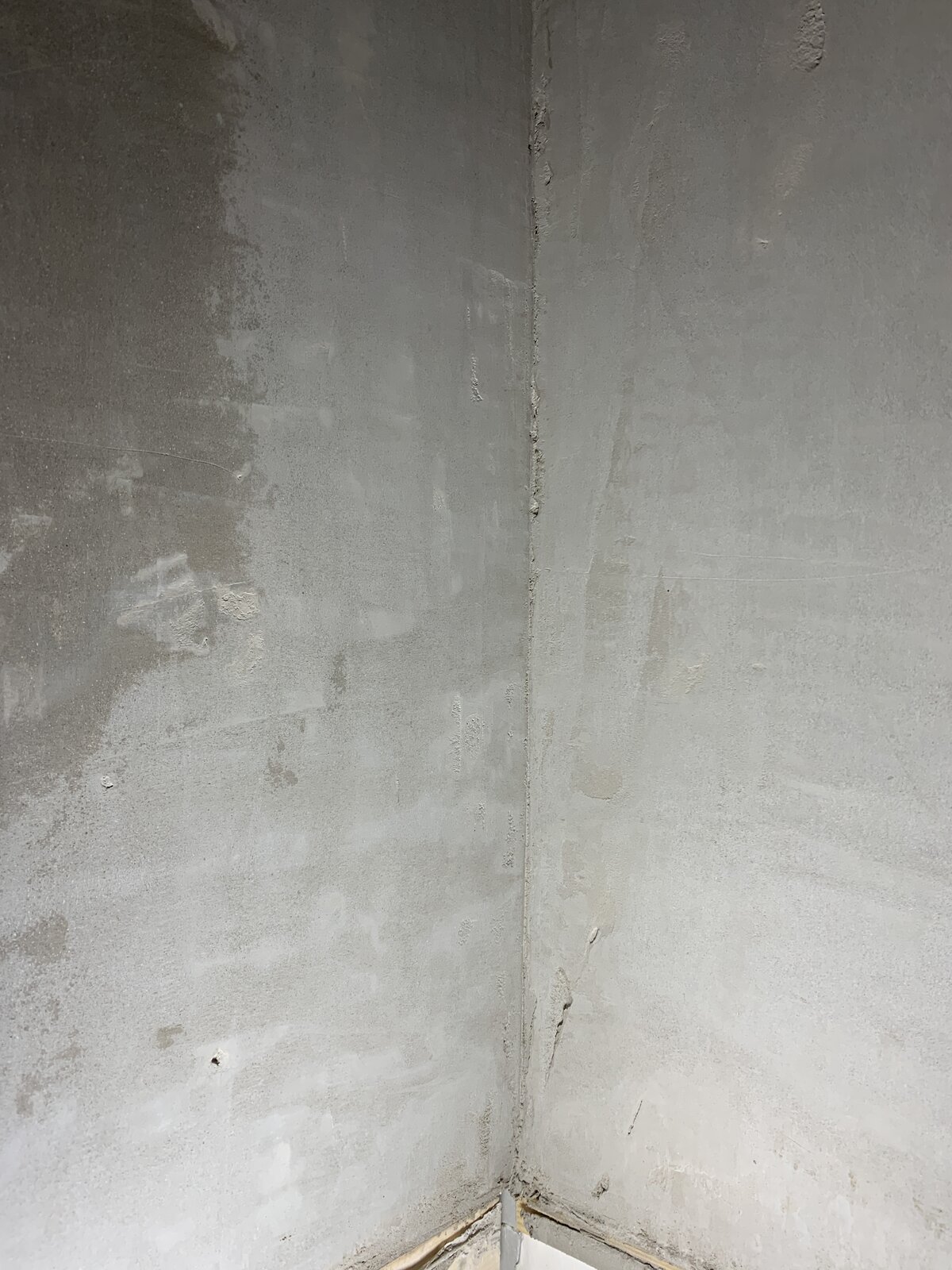

Ok so I had good go of this yeasterday. Skimcoat. Tricky business
My feeling is that it’s not the worst result for a first try at the process but there are still multiple spots that couldn’t get perfect before it starting setting.
I know best option was to get someone in who is an expert but I just wanted to try.
anyway, the question is now how do I fix the few ‘blemishes’ or little spots of recess after it’s set/still drying? Please don’t tell me it has
To be another skim coat. Is there something I can fill with and then sand? Can you smooth out some of those spots with new plaster or need something special?
