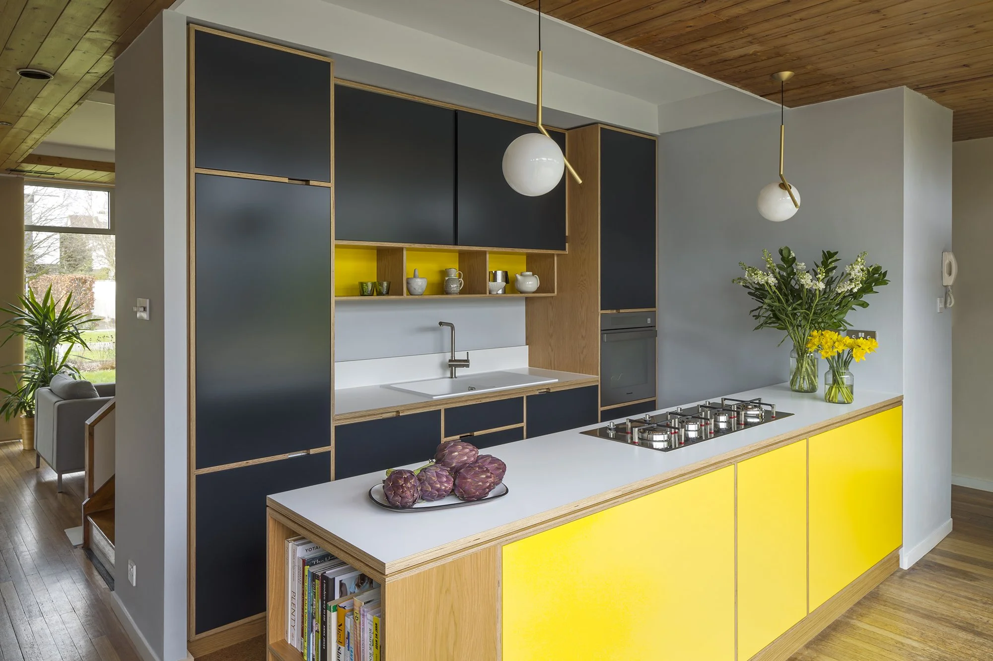

I'm thinking of having an Ikea kitchen. Wouldn't have done so until recently, but..
Actually I do like their wall units, as they are usefully deeper than the standard sized ones that Howdens/Wren/Magnet/yaddayadda think is all anybody will ever want, so I had been thinking about using those, but rigid carcasses for the base units.
Wasn't going to go for Ikea base units, firstly as they are flat-pack not rigidly pre-assembled, and isn't there (I think??) a problem that they have no void at the back for services?
But..
Was at the Grand Designs show recently, and saw a company doing great-looking plywood kitchens:
Shepperton+Bespoke+Plywood+Kitchen+In+Birch+With+Wooden+Flooring+And+Canary+Yellow+Ply+Cabinetry
Very nice, and she-who-frowns-at-me absolutely loved them.
All bespoke, and way out of our price range.
But...
Searching the web for other peeps who make plywood kitchens turned up a company who make doors, end panels, spacer panels etc that you fit to Ikea carcasses, and voila:
So I'm thinking hmmm...
Getting to the point (at last), does anybody have tips on how to make the Ikea parts more sturdy?

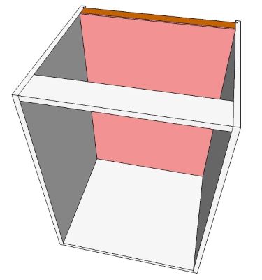

The one and only issue with IKEA cabinets (apart from non-standard door sizes) is that lack of a service void at the back. Water and electrics aren't an issue - they can go at floor level either clipped to the skirting or (in the case of the water) to the floor. So that really only leaves you with the waste water to deal with. I've always thought it was poor practice to have huge long waste water runs behind cabinets - I mean, how do you service them when there's a leak? In practical terms surely it's better to have a design where the washer/dishwasher/sink either feed directly out through the wall, or possibly downwards through the floor? OK, I agree that isn't always practical, but it's still a good-ish idea to minimise the number of cabinets you run behind to say 2 or 3. If that is possible, then you could always take a standard IKEA cabinet where I believe that the back is held in a groove and assemble the cabinet sans back:

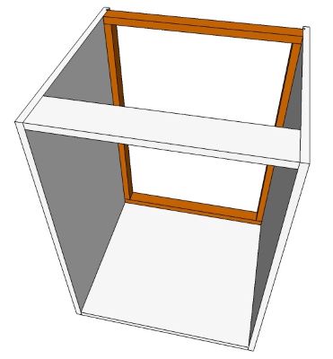

The back you remove is possibly sitting in 5mm deep grooves, so trim it down on 2 or 3 sides by 5mm to be an exact fit into the inside of the cabinet. Then remove the rear rail from the cabinet and fit a 2 x 1 PAR softwood "frame" on the insides of the cabinet to form a support for the back (I'd suggest 4 pieces, as below):

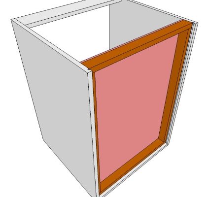

Refit the back you've removed, holding it in place with four or six screws in screw cups (or even those white snap shut screw caps):
The service void above was set at 60mm - OK, the 2 x 1 sides are thick, but there is no reason why you couldn't rip the 2 x 1 PAR softwood down to 1 x 1in, or just cut out where you need the pipes to run (after all it doesn't need to be perfect - it'll never be seen). Finally resize the shelf (shelves) and possibly drill new shelf peg holes (if required). The modified cabinet not only has space for your services, but the back can be removed from the front for access by taking the shelf out and undoing some screws, This approach can be taked with any type of cabinet
