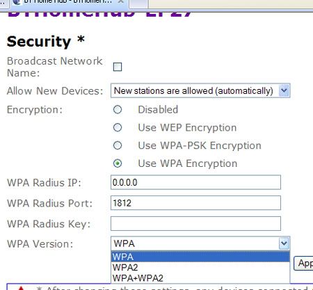

I'm not overly familiar with the BT Home Hub but your router settings should be accessible via http://192.168.1.1 in default setups (or http://192.168.1.254) and the username and password should have been provided to you by your ISP if you haven't already changed them. A while ago I know BT used to only allow access to the router settings once you entered the serial number from the bottom of your device. I don't know if this is still the case.
A quick Google shows that the settings for wireless encryption are in Advanced>Wireless>Security and should look something like this: http://i112.photobucket.com/albums/n200/Cloudedbrains/WPA.jpg
You'll want to use WPA-PSK Encryption with WPA2 (as long as all your devices support WPA2) and a sufficiently secure password as I mentioned in my first post. Then of course you'll need to reconnect your devices to the wireless network providing the key you have set when prompted.
It should be a fairly simple process, I advise you perform any settings changes to do with your wireless connection via a wired connection so you can easily revert back if something goes wrong.
