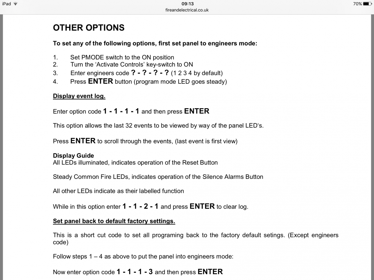

on another diy mission got an haes 4zone fire alarm looking inside looks like only zone 1 and 2 been used however b4 I start to install just checking it .i bought some 4k7 resistors put them in but one and two still show faults and also under the mains light there is a amber light ( psu) which also is on ( think this may be due to no batts but not sure ). And I get a remote signal activated fault light does anyone know how to program signal to off thanks

Had got the wrong resistors got the right ones now but I'm still getting remote signal activated fault light and can't seem to find anything in manual to switch off .
Just tryed to default think it's defaulted but that fault light still there also me being me have now blown zone 3 fuse (any idea where I can get them )have searched and can only fund expensive ones and think I'm gonna be needing a few thanks
