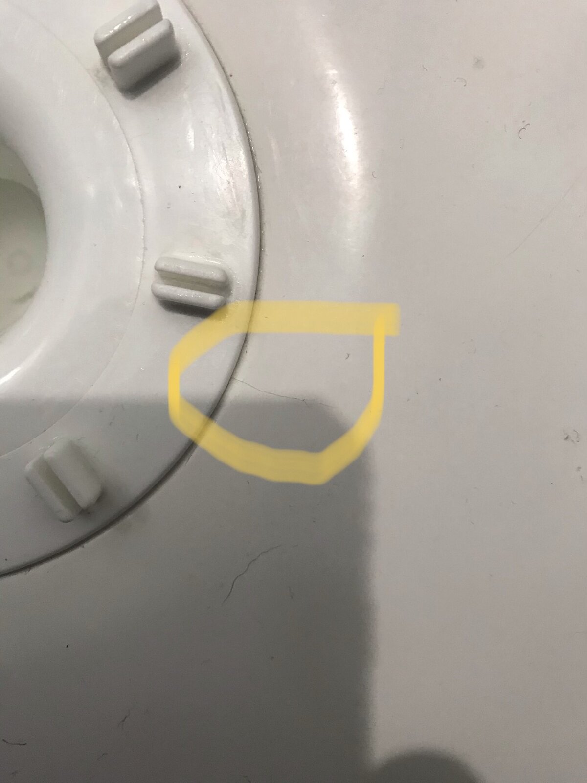

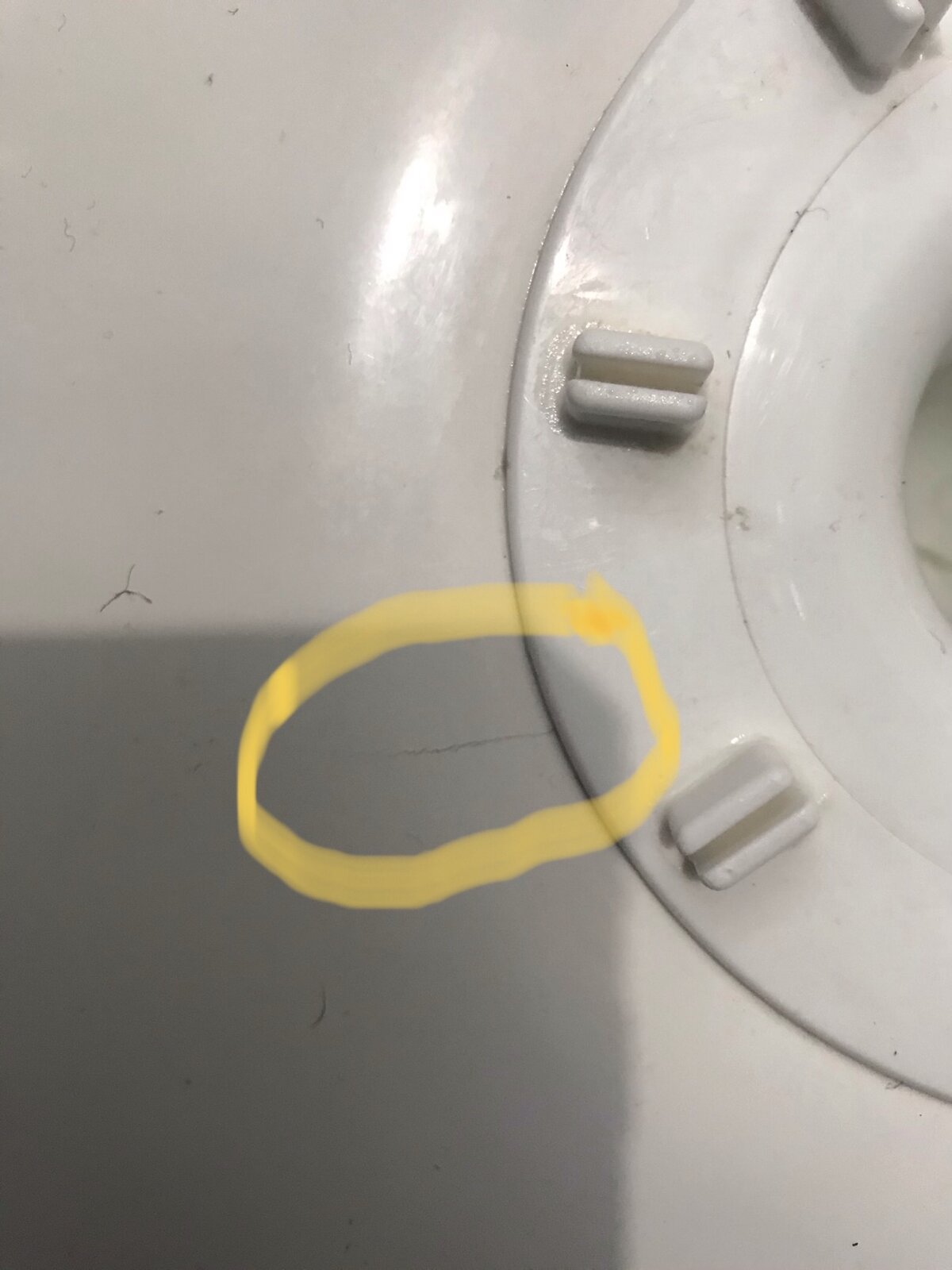

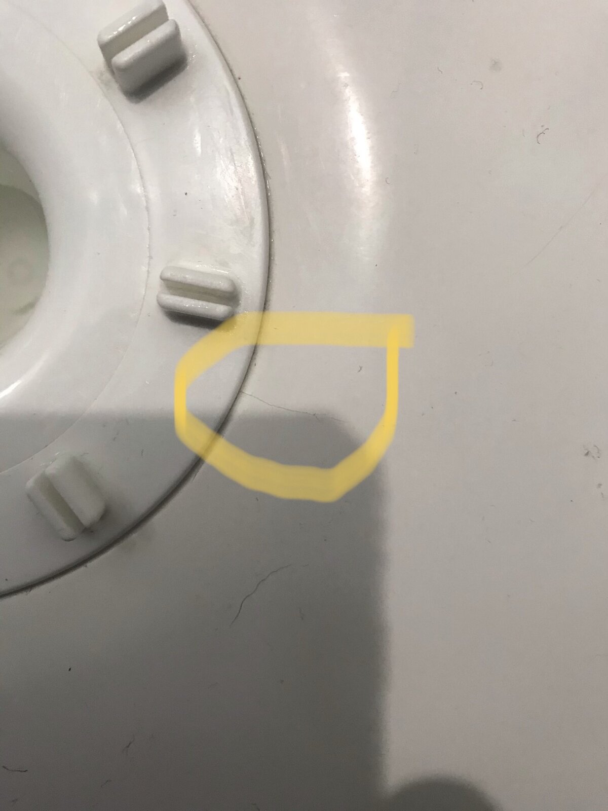

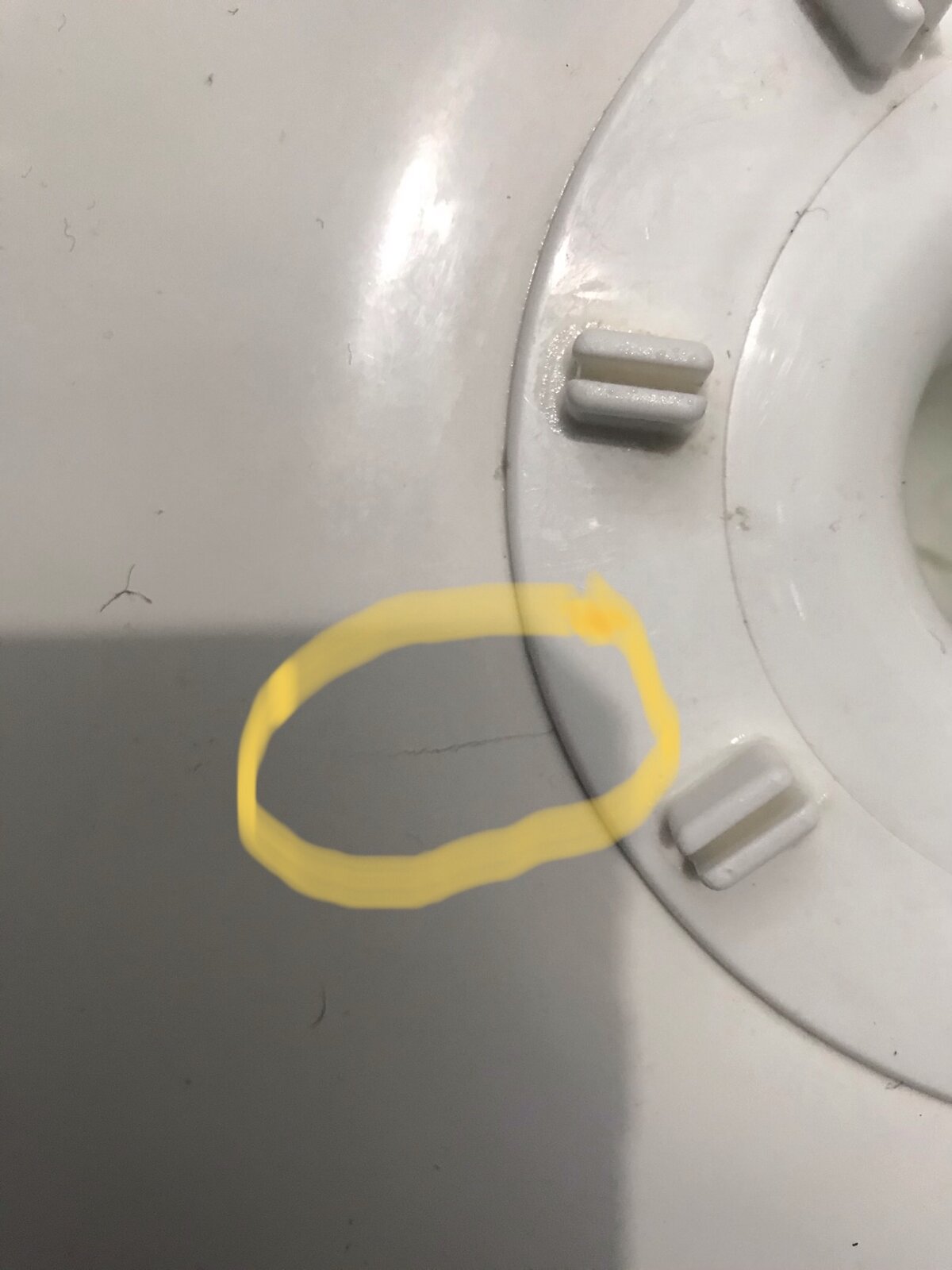

Hi all,
There is two hairline cracks around the waste of our shower tray, shower is less than a year old.
Is this a concern,as in water could get in crack? Or what could have caused this ?
Will it need a a new tray or any other fix?
Any advice would be much appreciated
Attached is where hairline cracks are

With above could it be because no bed of cement etc under tray to support shower tray potentially?
Tray shouldn't really crack there regardless of how it's been bedded in. Does the tray waste get a lot of weight on it from where it's situated and where a person would stand? Could it be an issue, possibly. May be worth taking the waste apart and seeing how far the cracking has got and whether it just superficial.
May also be worth a call to the manufacturer either that or the installer if they supplied the tray and you have a good relationship with them.
I certainly wouldn't just leave it and hope for the best, definitely worth a little investigation IMO.

Not all tray's are cemented in, all depends on the finish underneath and what the tray is made of. That and rarely is any fixing medium laid so complete that it runs right up to the waste hole, so I don't think support is the issue. One thing is for sure though, no tray should be dropped directly onto the subfloor, it's just asking for movement and ergo trouble, especially with some of the nasty flooring types these days like P5 chipboard.
Could they be superficial, yes, but the shower waste needs taken out and the tray waste edge inspected to check if that's the case, anything else is just a guess. Every tray trap should be fitted where the tray side locking ring could be removed without the trap below dropping too much.
