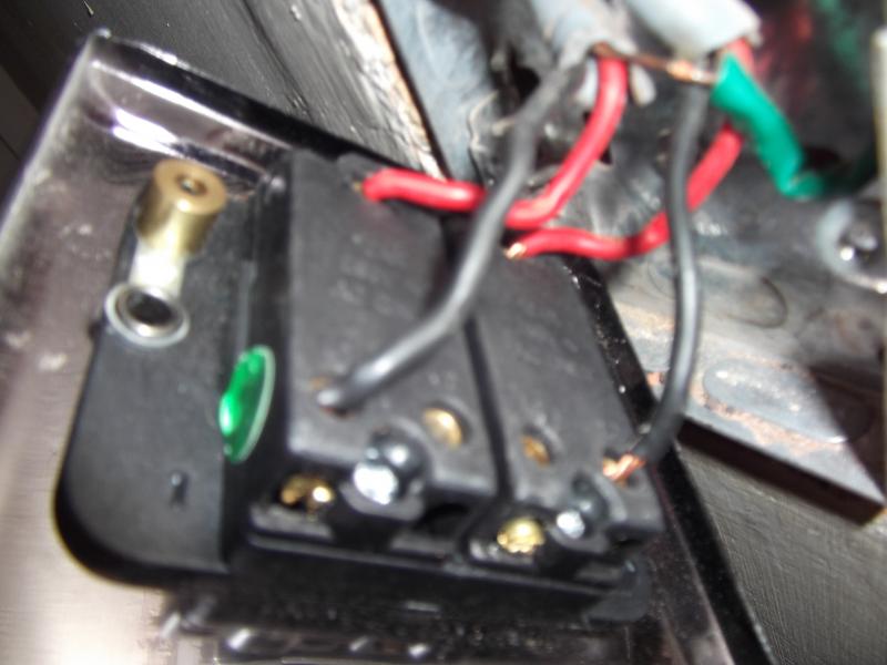

I have a problem with my hall and landing lighting. Downstairs is a two switch light fitting, upstairs landing is a one switch fitting. The downstairs light has two sets of wires supplying power to the switches, each wire carries one red and one black wire. the light fitting has two gangs labelled "L" at the top and "L1" bottom left "L2" bottom right. I have tried to wire the switches as per the lighting diagram which came with the switches but I'm having problems. I can get the downstairs only working via gang one, red wire in "L" and black wire in "L1", but no matter how I wire the other gang and the upstairs switch I cannot get the upstairs working. I need to wire upstairs so that it can be switched on and off using both switches upstairs and downstairs. The below drawing shows the set up, can somebody please let me know how to wire these switches so both lights work. nb the old wiring system had a small 2inch red 'flywire' but I'm not sure what this was for.

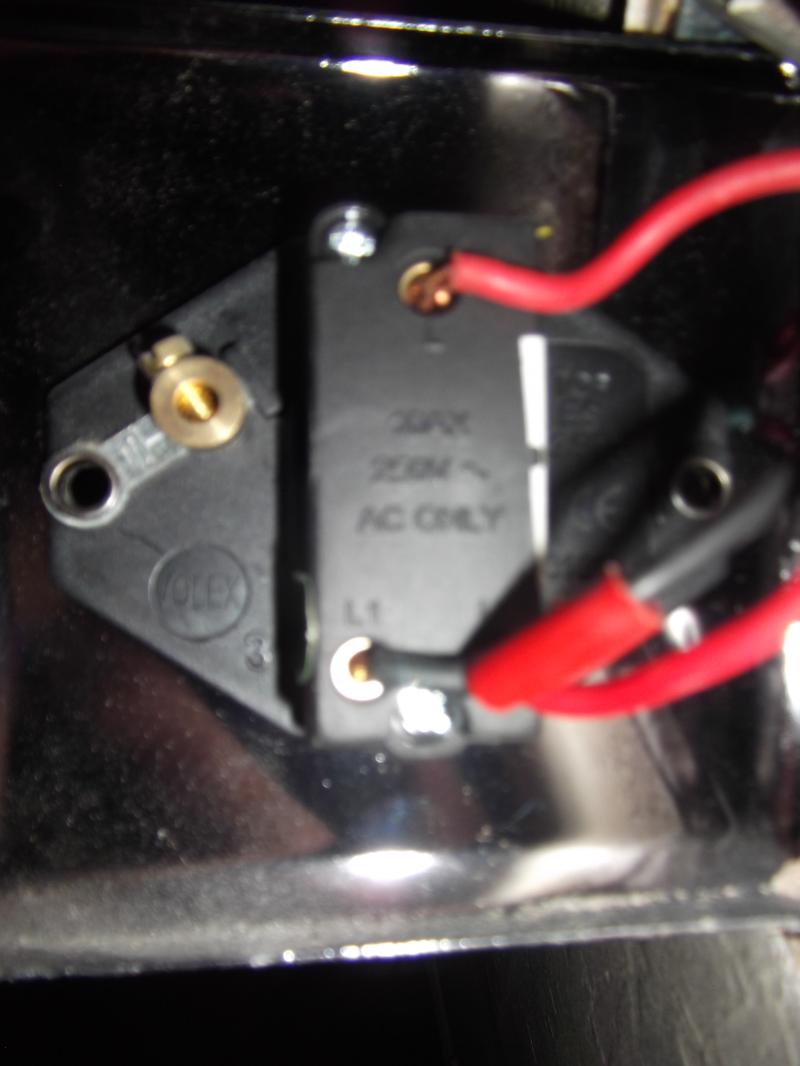

At the upstairs switch, are you saying you have a cable with two reds and a black?
That's right, two red one black. As per photos below.
Downstairs light works ok, I just need to know:
Downstairs Gang two, What goes in "L", L1" and "L2". and what was the two inch red flywire connecting?
And upstairs, what goes in "L", "L1", and "L2".
cheers.
Downstairs switch.
Black to L1 - (should be sleeved with red as upstairs)
Red to L2
Link from L to L.
If the switches are metal they must be earthed.
All it needs is the link re-instating between the red of the downstairs switch and the L of the upstairs switch at the lower switch plate. The twin cable to the upstairs switch needs to go in L1 and L2.
