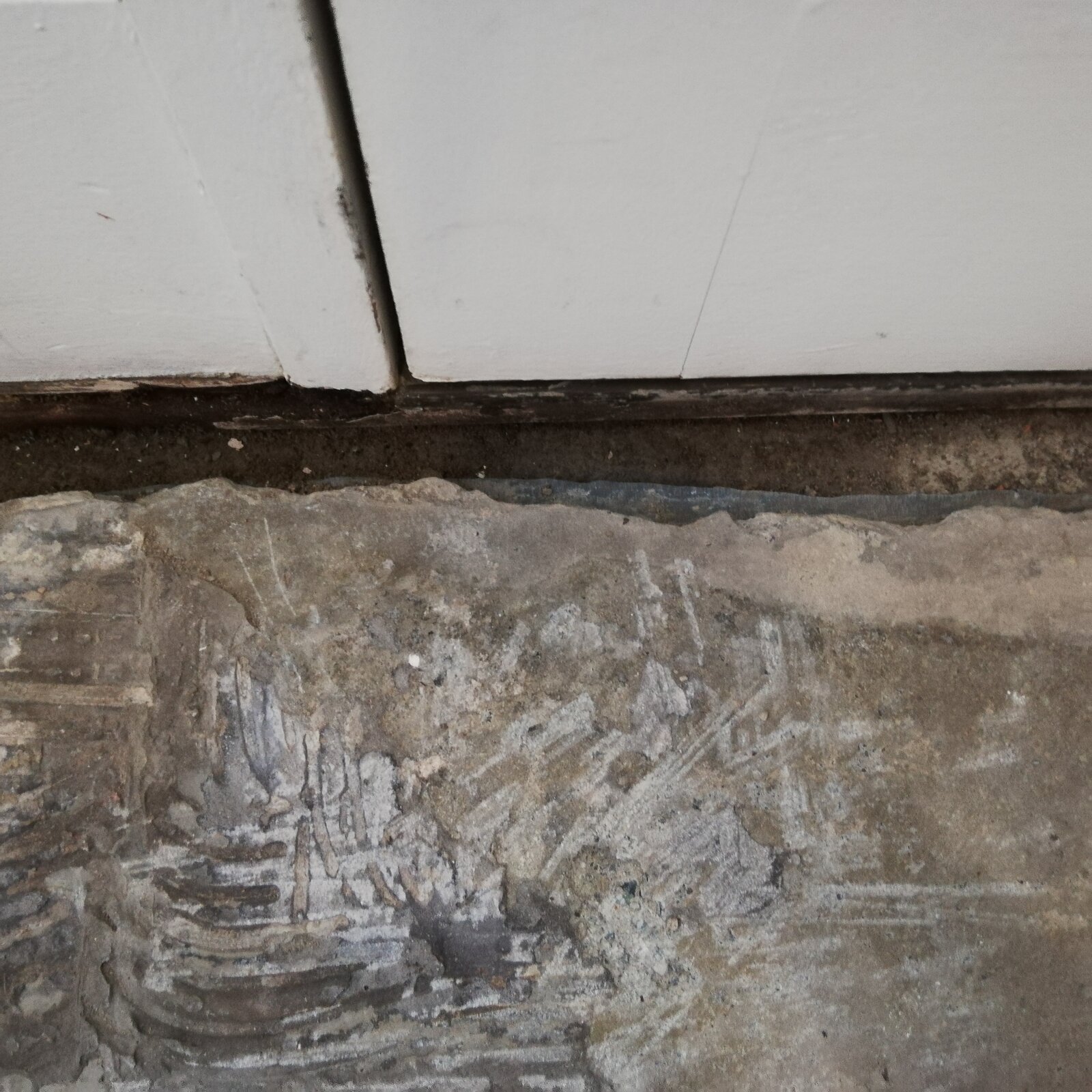

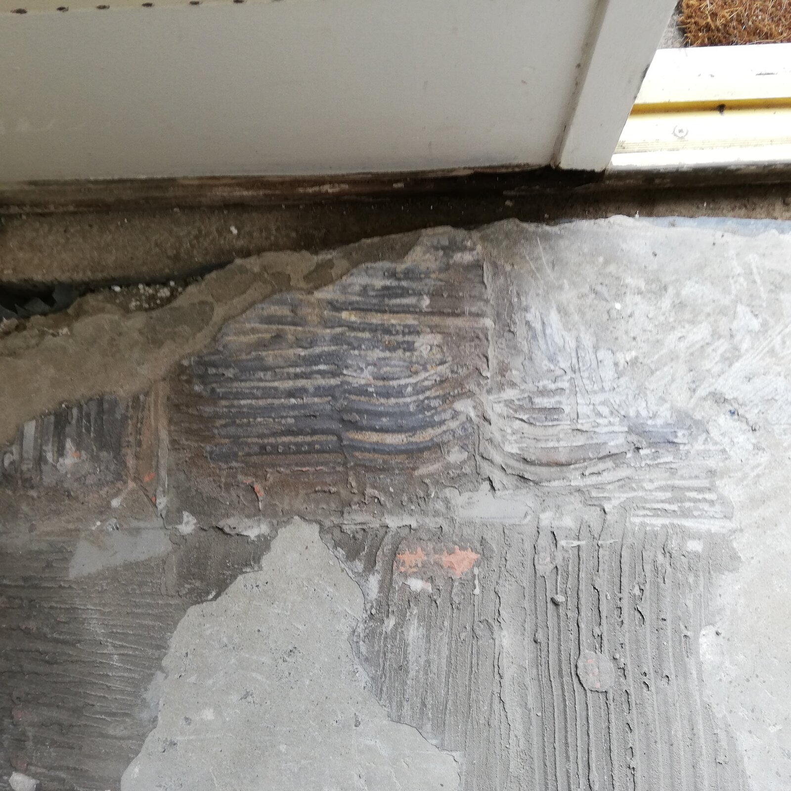

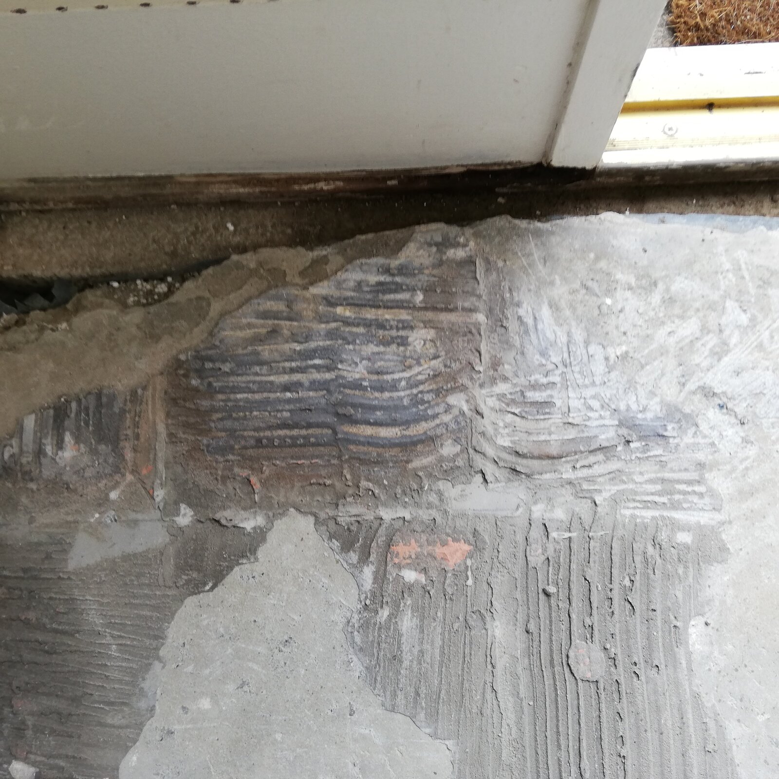

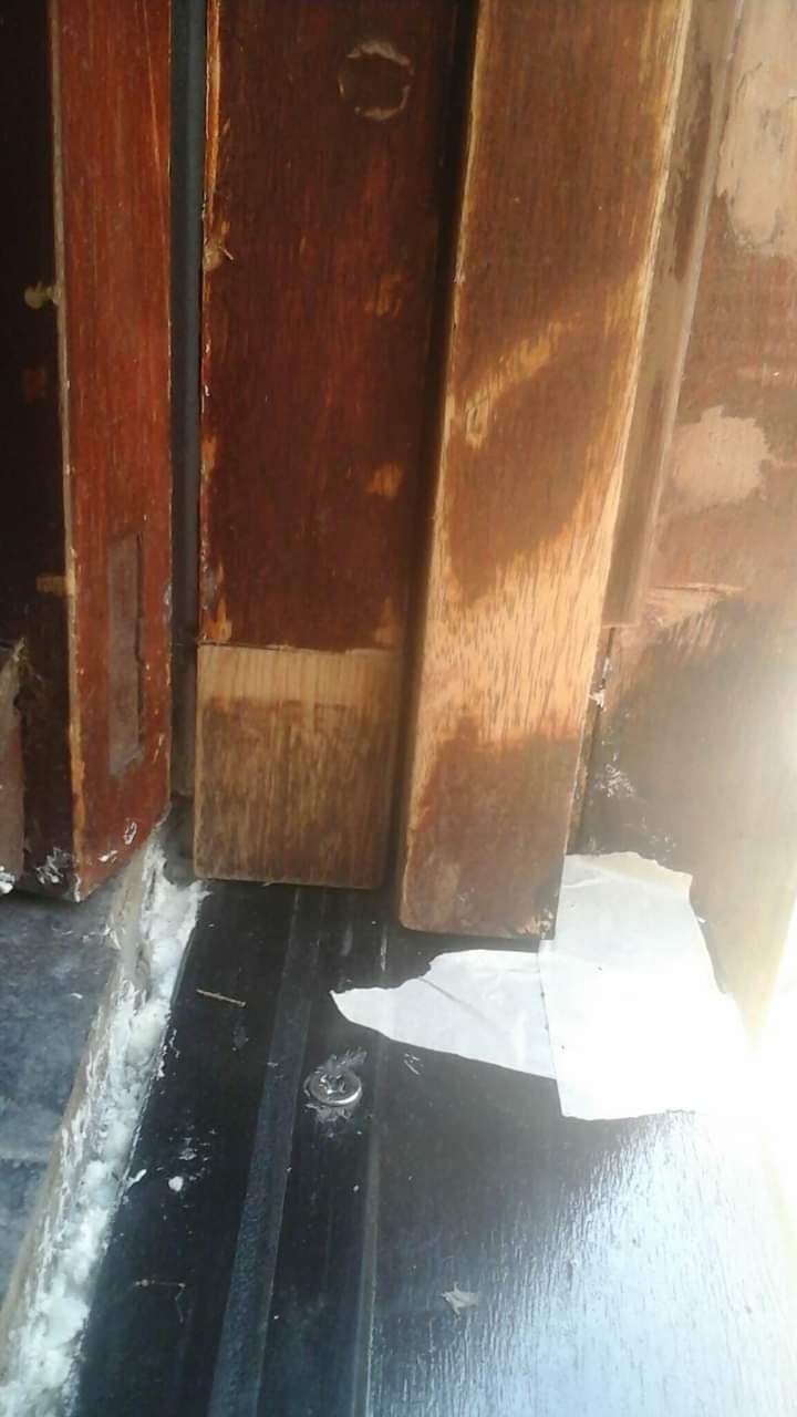

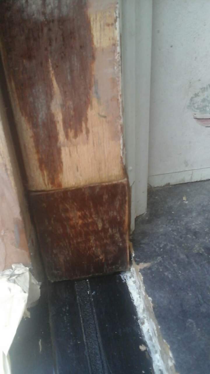

I am living in a terraced house built 13 years ago. I have been trying to make use of the lockdown to tackle some redecorating projects. I just started preparation for retiling the hall.

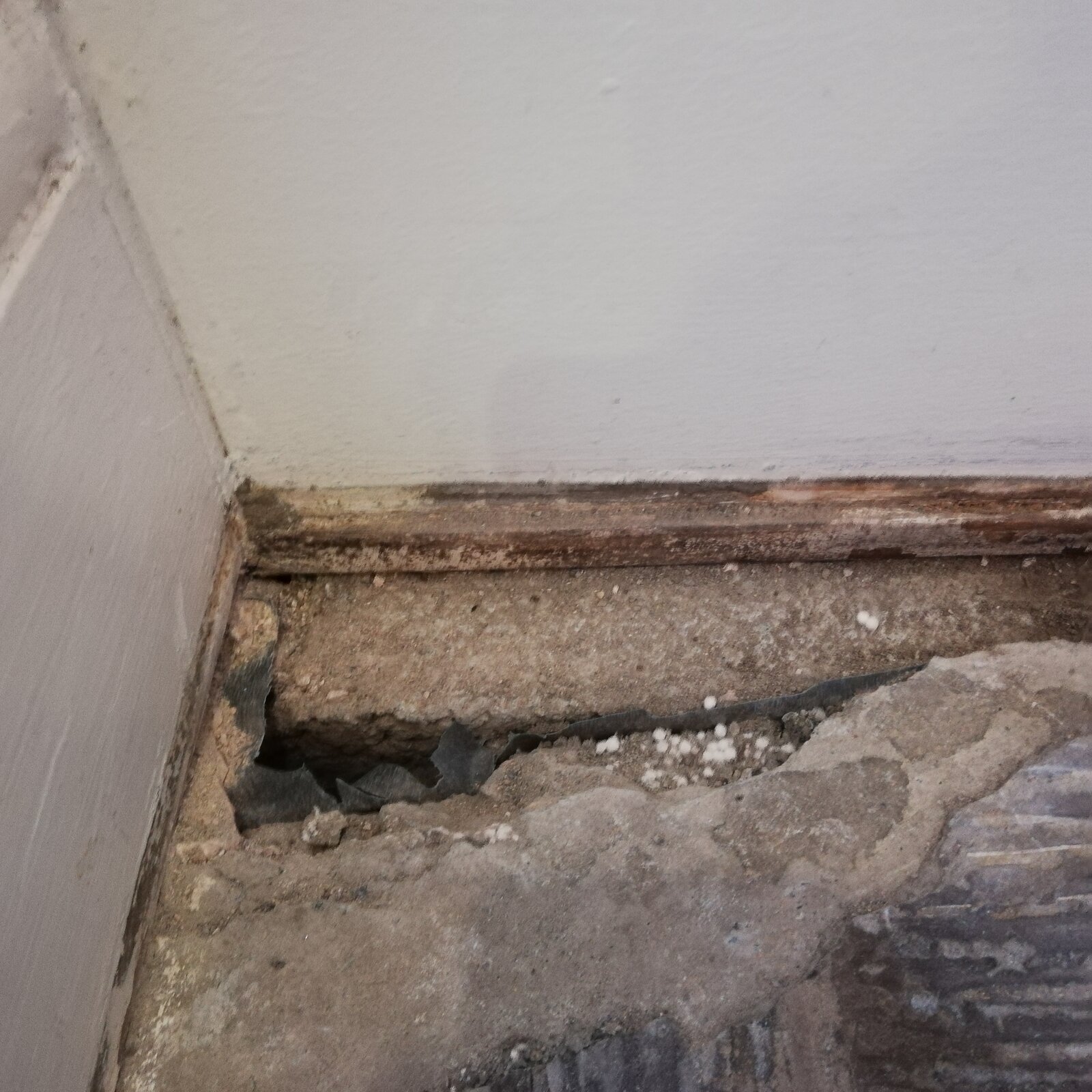

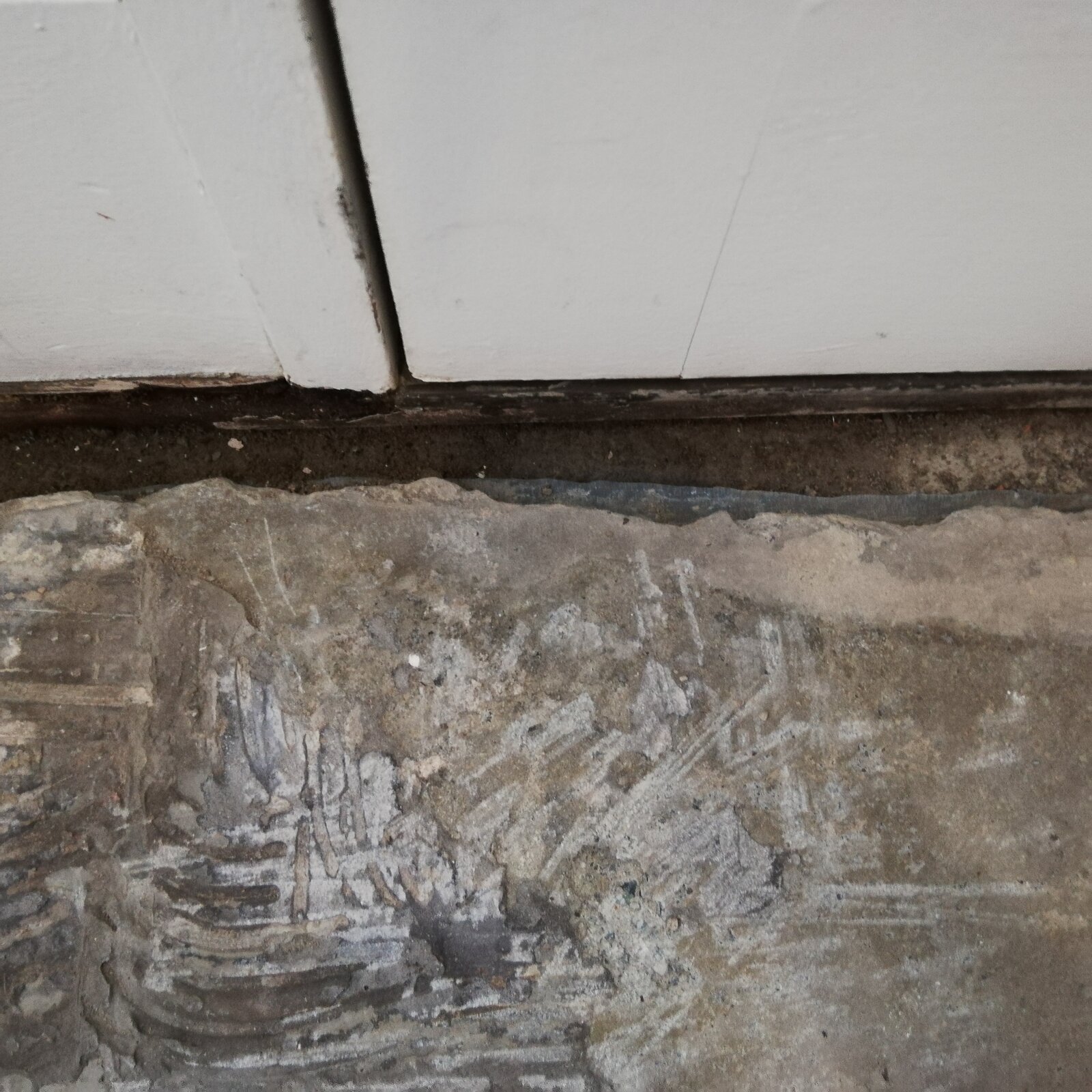

The old tiles came up without too much issue. After removing the tiles adjacent to the front door sill, I noticed some dampness and rot along the door sill. I removed some of the crumbling mortar between the sill and the internal concrete slab to inspect further.
Unfortunately I don’t know what I should be looking at but am concerned that the damp proof membrane doesn’t continue outside under the door sill. Should this be the case and is this the reason for the rot?
The rest of the door and frame appear to be in reasonable condition and ideally I would like to retain the door/frame to save money. Any suggestions really appreciated.

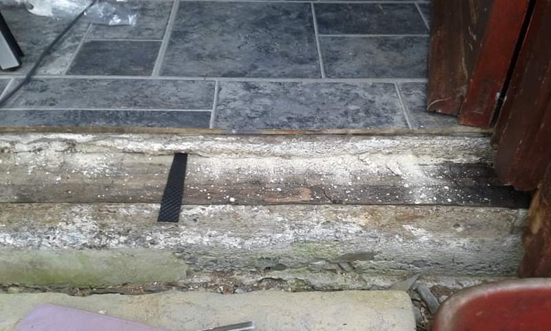

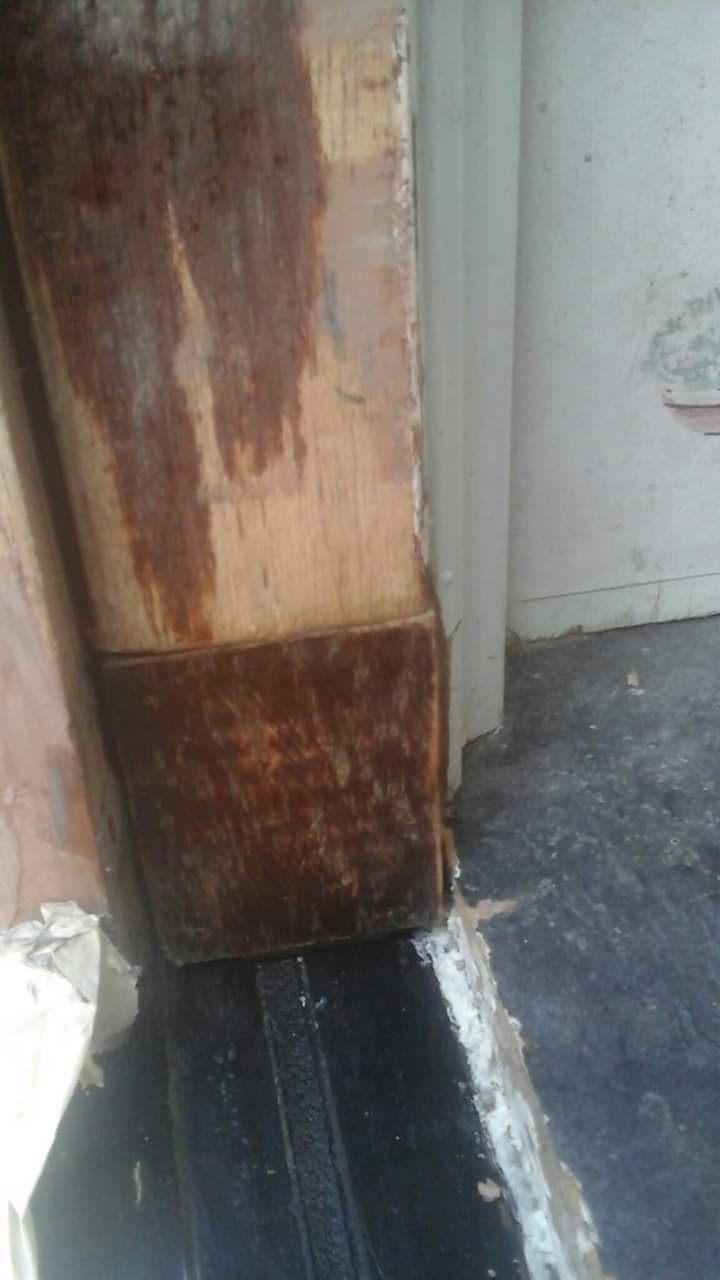

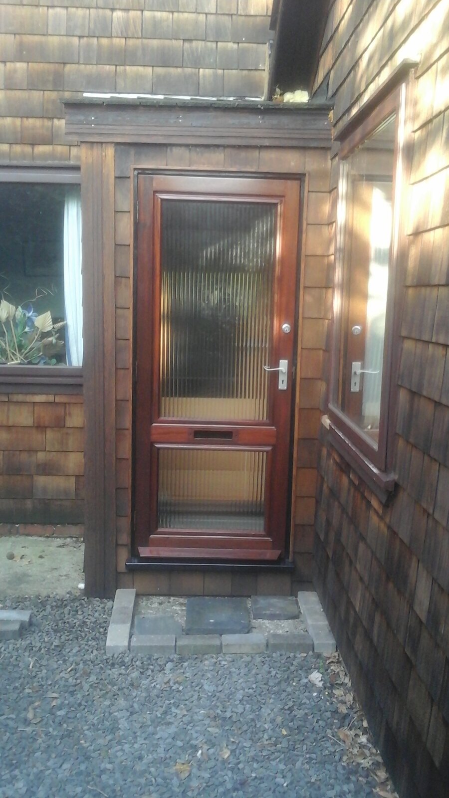

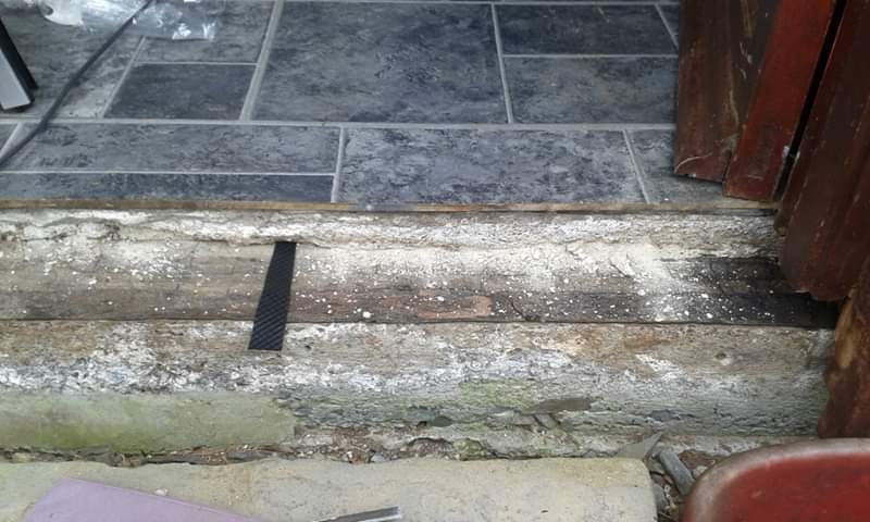

You can replace just the sill and put down a new dpc layer underneath it. I did so myself at the start of lockdown after I started sanding the sill and it came away in my hands. I had to replace a few inches of door frame either side too, which meant I could get a near-perfect fit.
Totally rotted.
The cracked stuff is the old dpc. The strip is from a new roll I bought from Toolstation.

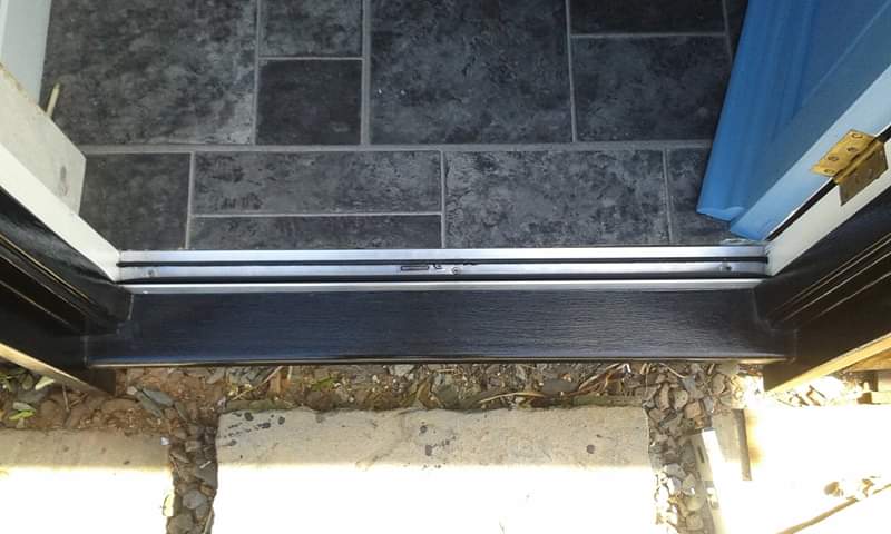

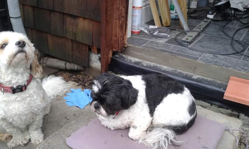

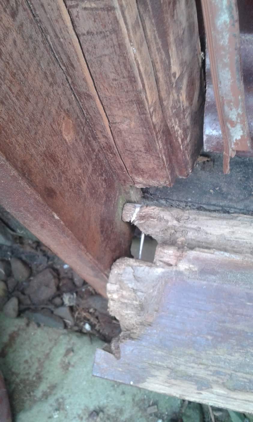

The concrete under the tiles was crumbly, so I lay the new dpc (double) and concreted it in. The new sill I cut to size and gave multiple coats of Sadolin - you can see a bit of the unpainted offcut that I used to test the fit on the right.

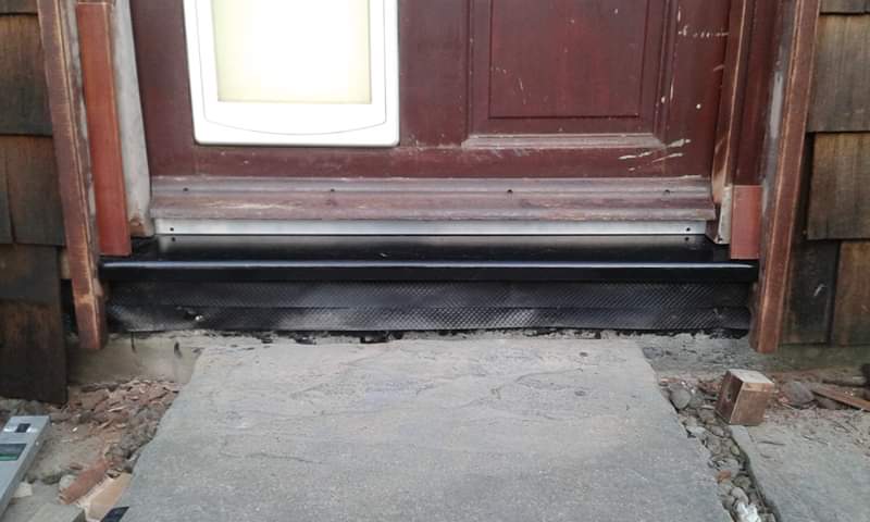

Test fitting the new sill and fascia pieces - I replaced several inches of frame and fascia.
Perfect, or near, dammit.

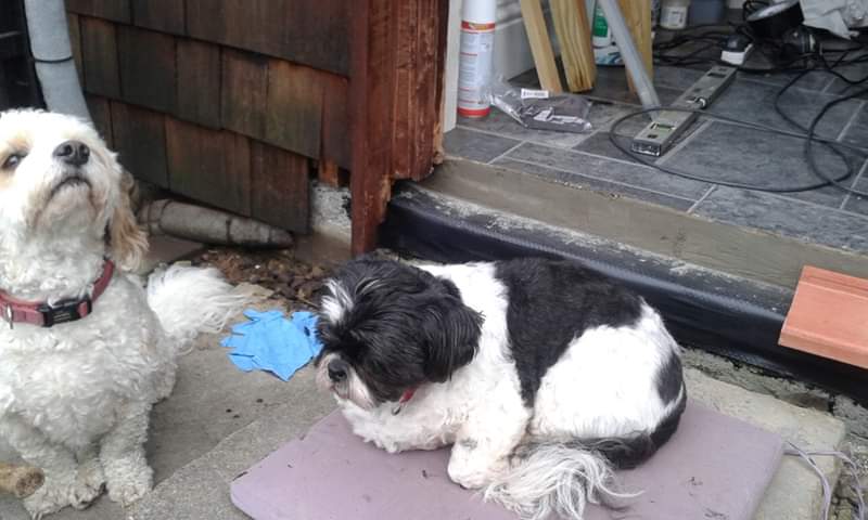

Then I screwed the sill down, filled, and sanded, and repainted everything before replacing the threshold and sealing the corners.
Thanks for your reply and the great pictures which explains it really well. I will have a go at doing same.
Did I understand you correctly in that you didn't have to remove the door and door frame? ... just cut the bottom sides away to free up the sill and go from there?
Thanks again

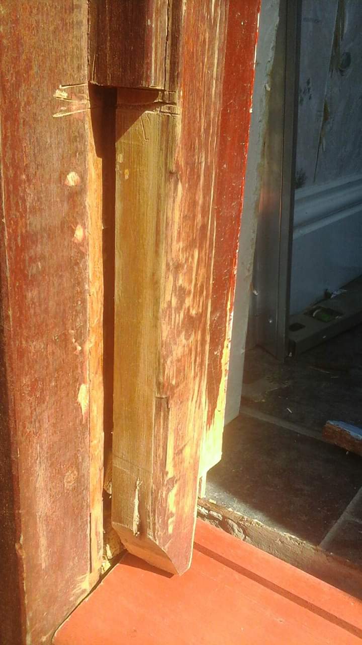

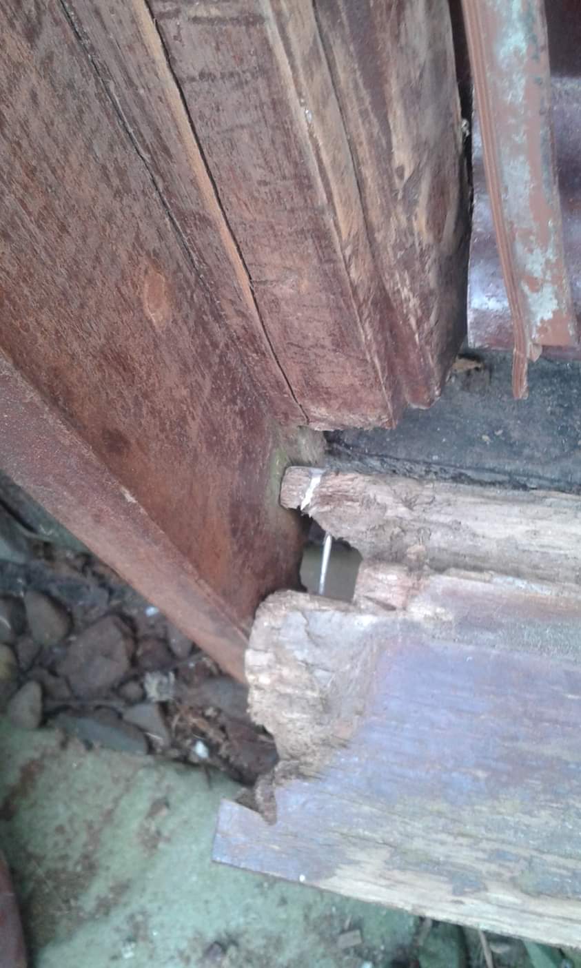

Yep. The old sill was so rotten, it came out with a few tugs. The frame where it met the sill had been drilled into and was rotten also.

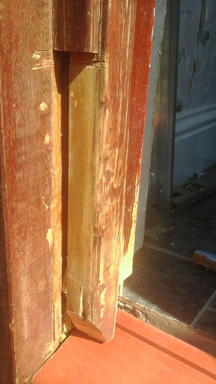

I used an Erbauer multi-tool with a plunge blade* to take out ~10cm pieces - see here both the fascia and inner door frame have been cut. The middle section I just trimmed off the rot to sound wood.
If your frame is sound, you can cleanly cut pieces out (use a square for a straight line) and replace the same pieces. Mine were unusable, so I found some old frame bits in the firewood pile of the local double-glazing place and cut them to fit.
Lots of trial and error.
Once I was happy with the position of the sill (I used plastic spacers 3628T to get the right height), I drilled three holes and inserted bolts (6939G - Screw fix, though the heads are awfully soft so I wouldn't recommend) with plastic sleeves. I filled around the sides with foam then added the new pieces (glued and screwed), filled** (sanded-filled-sanded, etc), painted then sealed.
I did take the door off at the end as I wanted to check it for rot, strip and paint it, but it didn't need to.
*have a spray bottle of water handy to cool your blade and kill any embers - the wood will burn quite readily
**I used some more of the spacers between the sill and frame where I hadn't replace with wood and couldn't get filler in

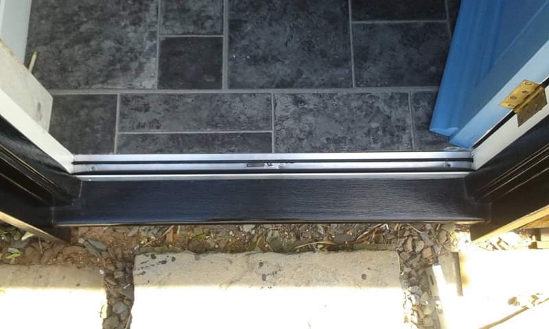

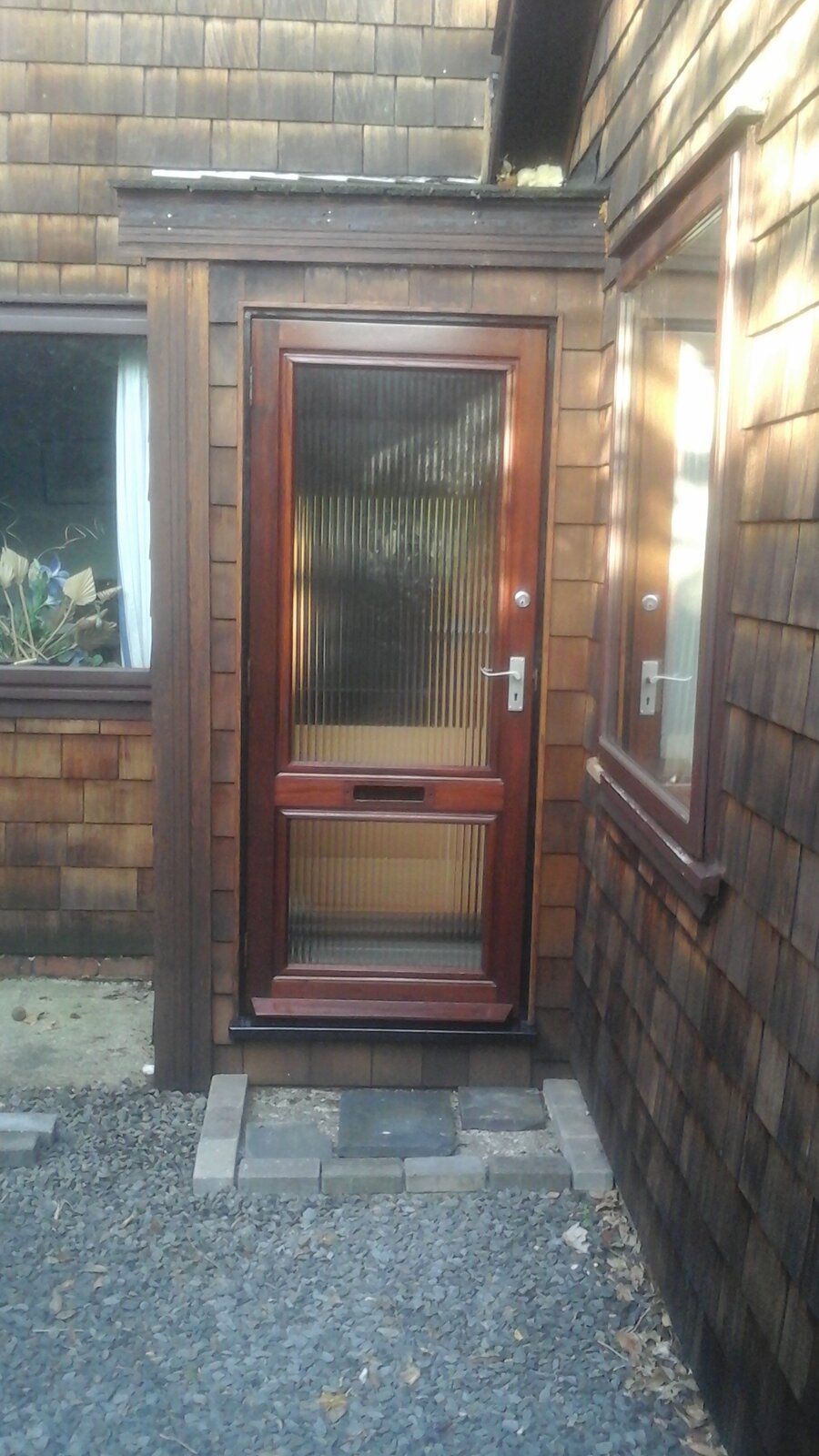

Did you consider fitting one of those sill pans under the sill? It seems to be an American standard solution. A neighbor of mine suggested it and told me that it is often done with thin lead or aluminum and shaped to the underside of the sill? Not sure how I would manage it but I think the sandolin and the dpc sheet should be enough.
The pavers outside are probably not helping the situation. I am also thinking of fitting an AXO slot drain outside the door to draw any excess rainwater away from the door.
I saw a video about them, but couldn't figure out how it would work. I'm hoping the dpc does its job.
I'm looking at directing water away from another door by fitting a paver at a slant, and something above the door (it opens outwards and water coming off the porch roof could seep in), but that's a project for later this year. I have windows to do in the meantime...
