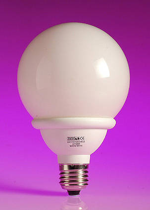

Take it back, buy a pendant pamp holder and put
this in it
tonydee1965, try this idea.
write the following down
The lamp you just brought that you dont like cost...........
Option 1)
Change all lamps and transformer
a new transformer will cost ..........(£13.00*)
10 new lamps will cost ............(£7.50*)
Option 2)
Buy a gobe lamp and lamp holder and change the whole lot.
Globe lamp will cost ..............(£2.50*)
lamp holder will cost ............(£ 4.00*)
question which is cheaper?
*prices taken from TLC website, other suppliers of electrical parts are available
