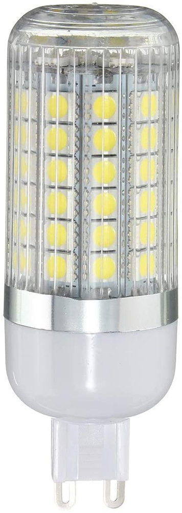

So with G9 for example you can get these G9-small.jpg which will fit in the glass globe, but have no or little smoothing or leak resistors, or these G9-big.jpg that will not allow the glass globe to be fitted, but have smoothing capacitors and leak resistors.
LED's are DC, but an LED package can be AC or DC, and where it uses a current limiting capacitor not only must it be AC but AC at 50 Hz.
