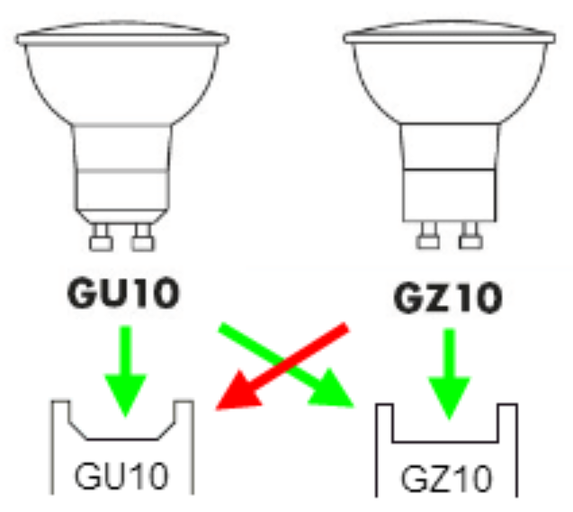

There are a few possibilities.
One property I went to had GZ10 fittings designed for that lamp (PAR) where the heat is designed to come out of the front of the lamp, not the back, like dichroics.
But someone had put a load of GU10's in and the fittings were heating up and the lamps popping off like flies.
If the fittings are SELV, the other possibility is a bad connection, usually on the lampholder, but sometimes in the lampholder terminal block. These problems are magnified many times if the lighting is swathed in insulation.
Are you sure, i was under the impression a GZ10 lamp shoots heat from the rear and has a different base.
Therefore you cannot fit a GZ10 lamp in anything but a GZ10 fitting.
A GU10 lamp WILL Afaik fit a GZ10 fitting with no harm at all.
The problem comes when fitting a Dichroic GU10 lamp into a fitting designed for Aluminium backed GU10 lamps.
I have also encountered the problem you refer to above regarding heat with 12 volt G5.3 lamps
Apologies, I think I've got it the wrong way round. I'll just go back to sleep....
Yup
The problem comes because there should never have been a combination of a dichroic envelope and a GU10 base.
But as (I'm sure) someone once found, there are (were) 12V GU10s, so nothing should surprise us.
